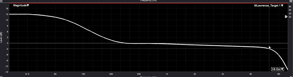

For example here is a commonly used target curve for tuning PA systems (Michael Lawrence target trace):
A flat response can sound good on lower levels, but at PA levels it will be unpleasant so most people will prefer roll off above 10k.

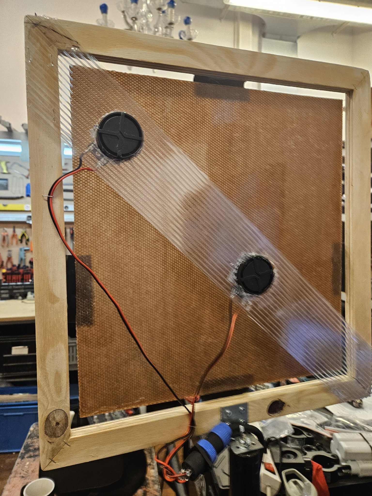

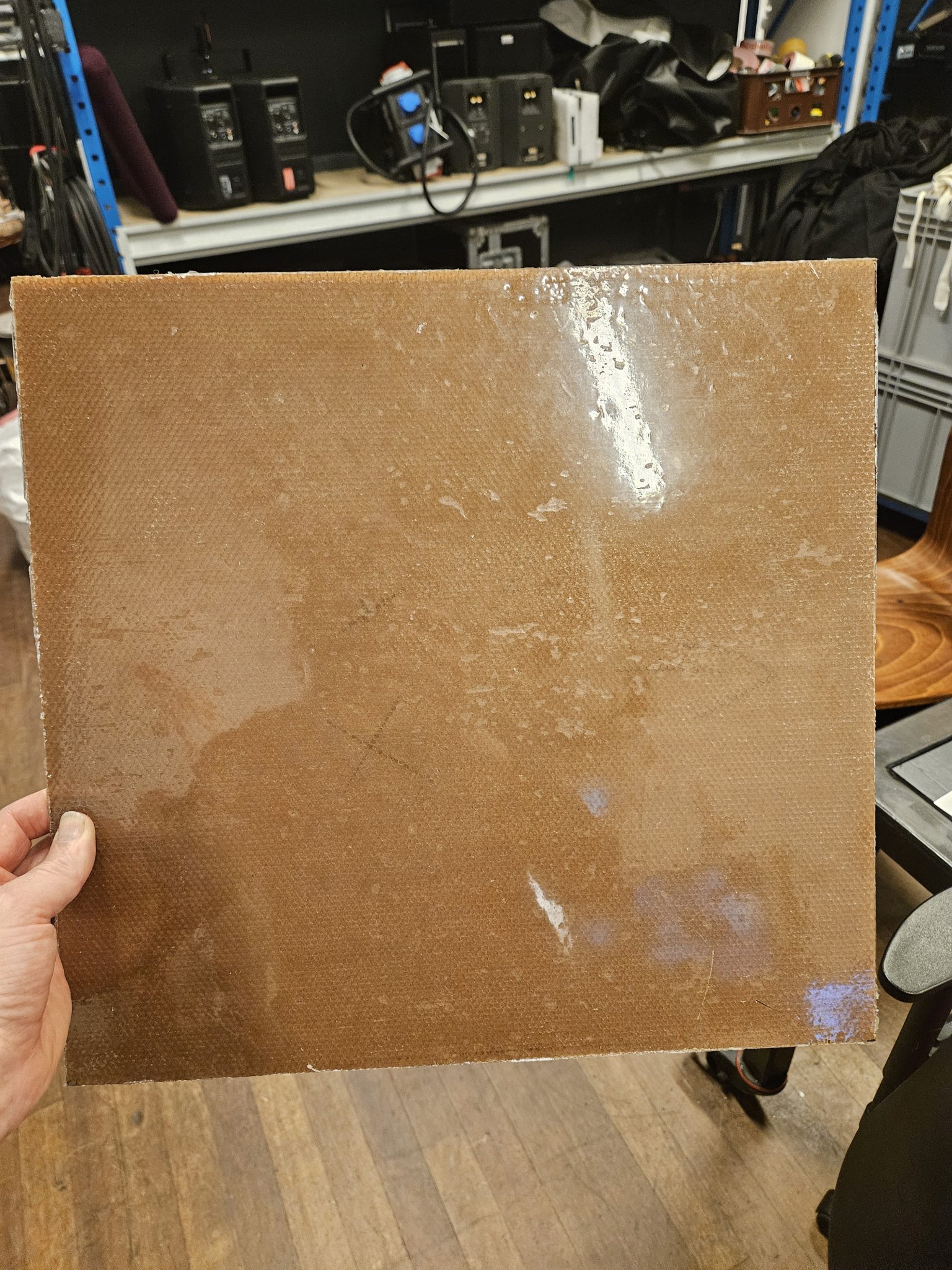

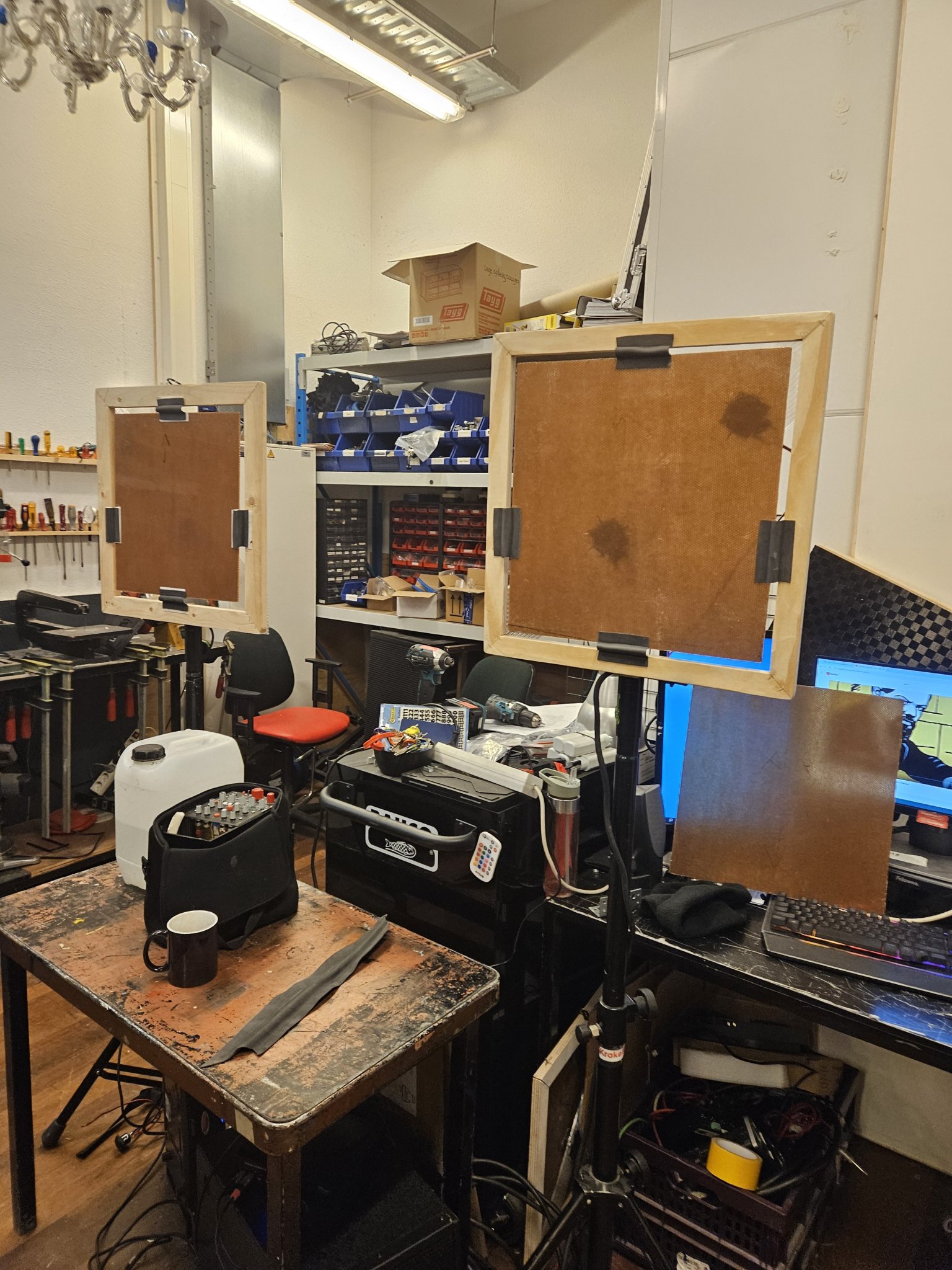

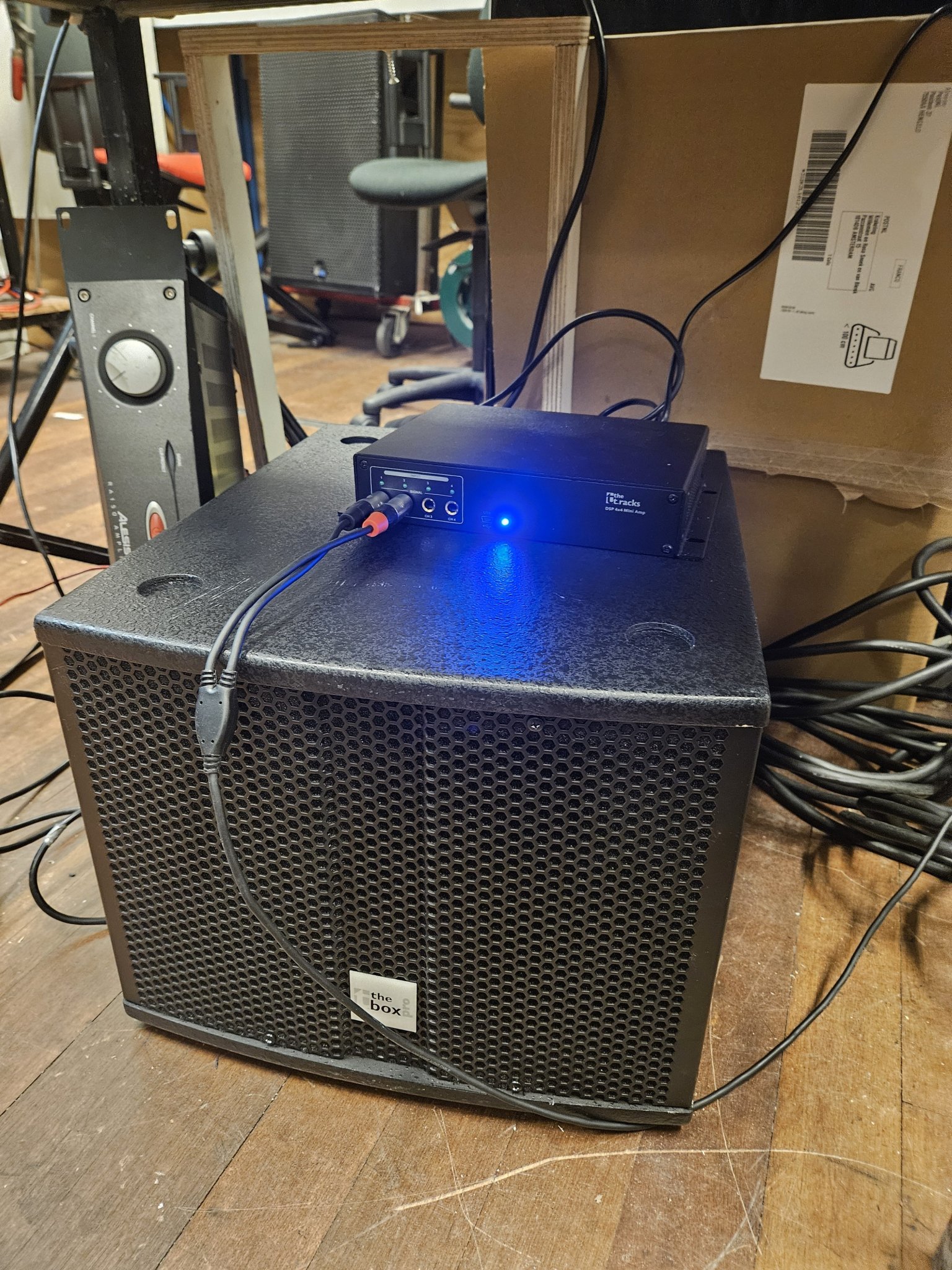

Small progress update : I tried to coax a FR from 100 Hz upwards from a dml plate, and didn't succeed. Now I settled for 40x42 cm, 4mm paper/nomex plates, with a small 8"sub doing the lowmid work up to about 130 Hz. Powered by a small 4 channel DSP with built in (not so good...) 4 x 50W amp.amp. It works and sounds good as a small PA for semi-acoustic bands. In total I made 4 identical panels, so I can experiment in bigger rooms (for instance the theater I work in). People are generally pleasantly surprised by the sound and of course the unfamliar sight of the panels. No negative reactions yet. I like them too - there's something special and nice about them.
Greetings from Amsterdam, Hans
