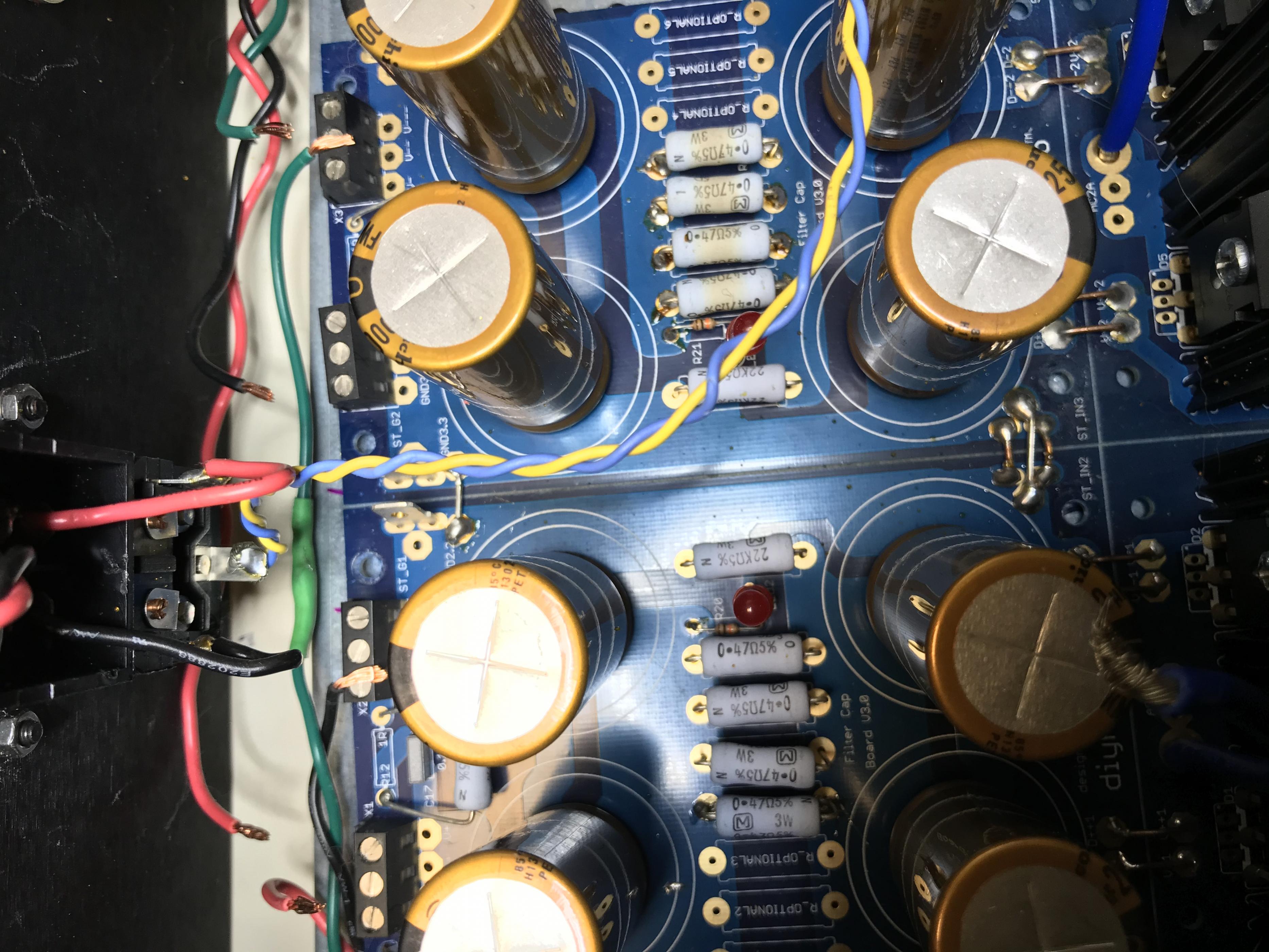

Not sure that's @rock12's issue... not saying it isn't either, I'm no expert—but I haven't tied the tranny shield directly to the same contact point as IEC ground in any of 8 builds (mono blocks, not including preamps) preferring to keep it as short as possible, I always ground it right next to the donut....zero PSU dramas to date, baring LED flipping. I DO see a couple of indications of maybe suspect soldering welds. Would like to see the bottom of the board...Why everything is "fine" with phone vs other sources...beyond my current knowledge.
Rock12-

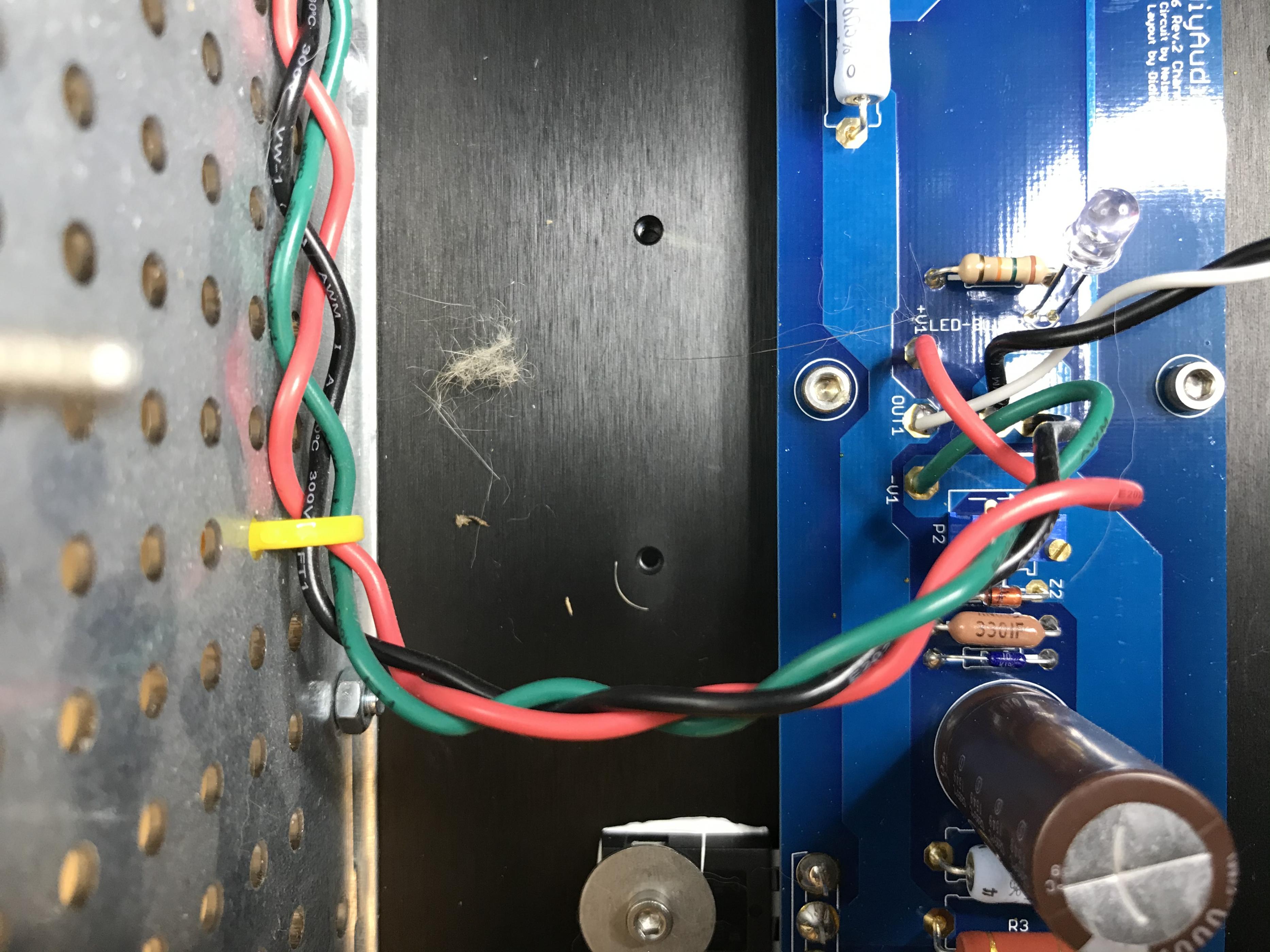

Where is the CL60 on the PSU board connected... the photo only shows the chassis connection.
Post a photo of the connection side of the PSU please.
Put the purple transformer lead to the screw that is chassis ground and forget about it, that is probably not the issue.
The cl60 is only there as an inrush limiter. I will move the purple wire over. The purple wire was connected on to ground on that far side and when I checked I noticed it was solder was disconnected. The side with smoked resistors is on the opposite side of the amp overheat. If you look closely on the left side of pic near center of the amp you con see the black streak where the trace raised up
Here’s pic
On a separate note, your power supply capacitors look rather small. What are their ratings? (Eg capacitance, rated voltage)
Probably they are fancy Nichicon Gold stuff, but you might consider more capacitance to reduce power supply ripple.
Jusr my 2cents

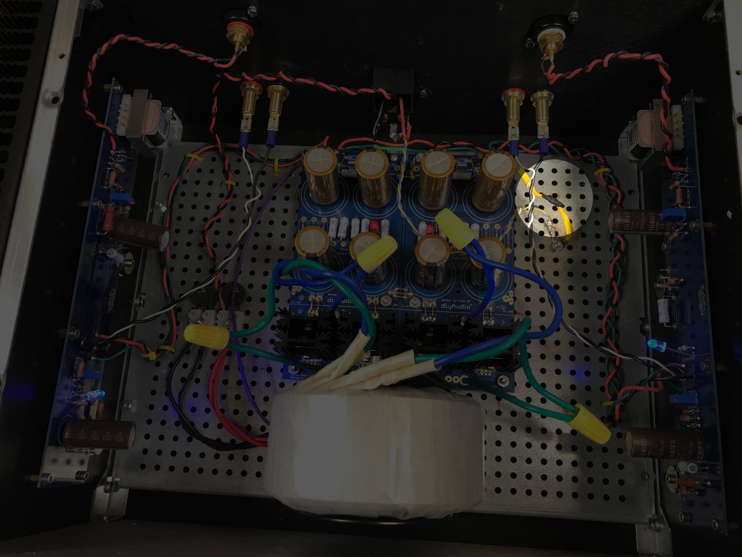

Disconnect everything from your Euroblocks on your PSU. Remove the connections to the amp boards and your ground lift or anything else. Just have the safety earth to chassis, toroid and PSU wired.
Measure again.
To ensure clarity measure here at the output near the Euroblocks.
V+ (Red Probe) to GND (Black Probe)
V- (Red Probe) to GND (Black Probe)
Measure again.

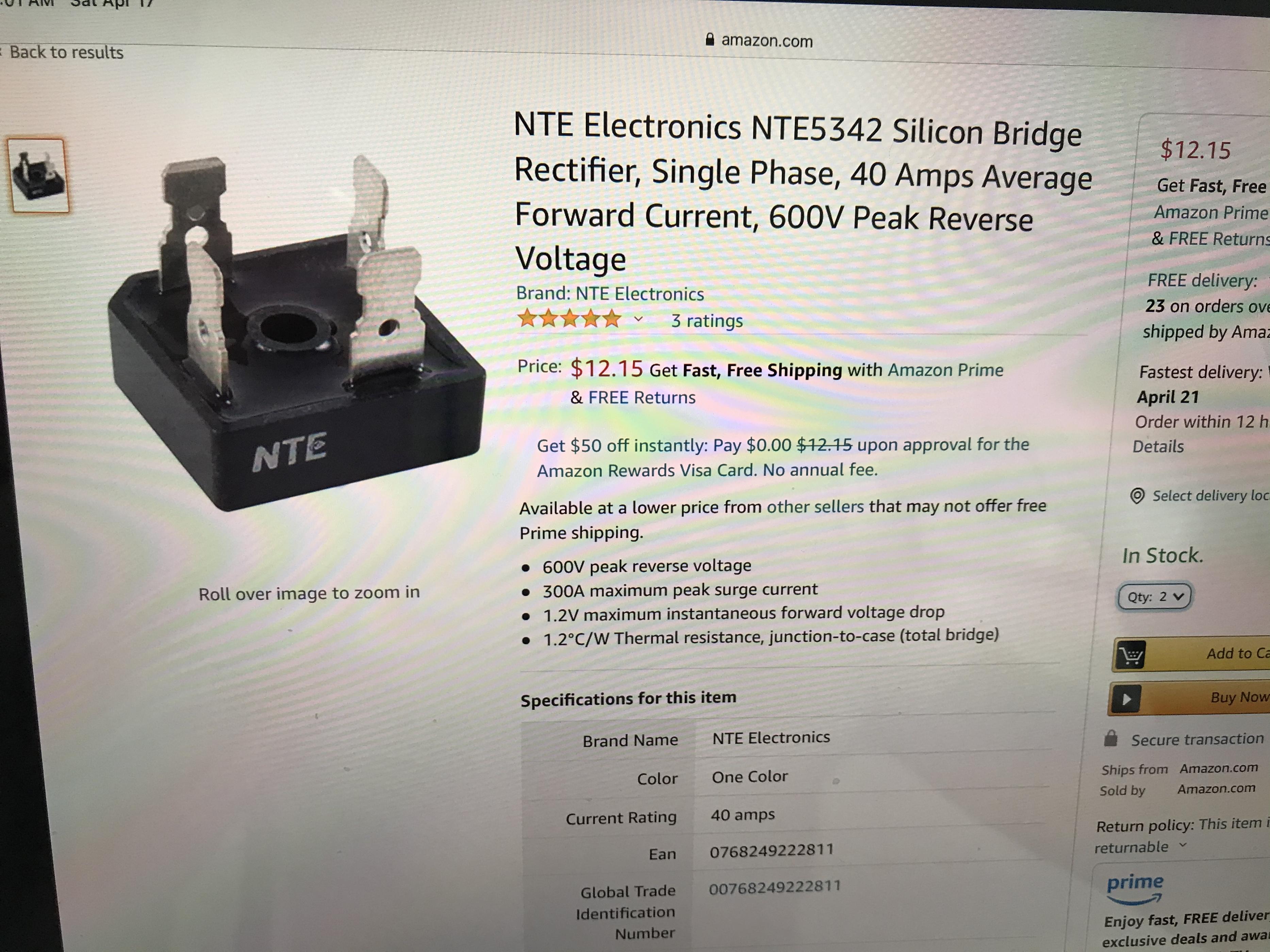

3. Is there any reason not to use monolithic bridges?
