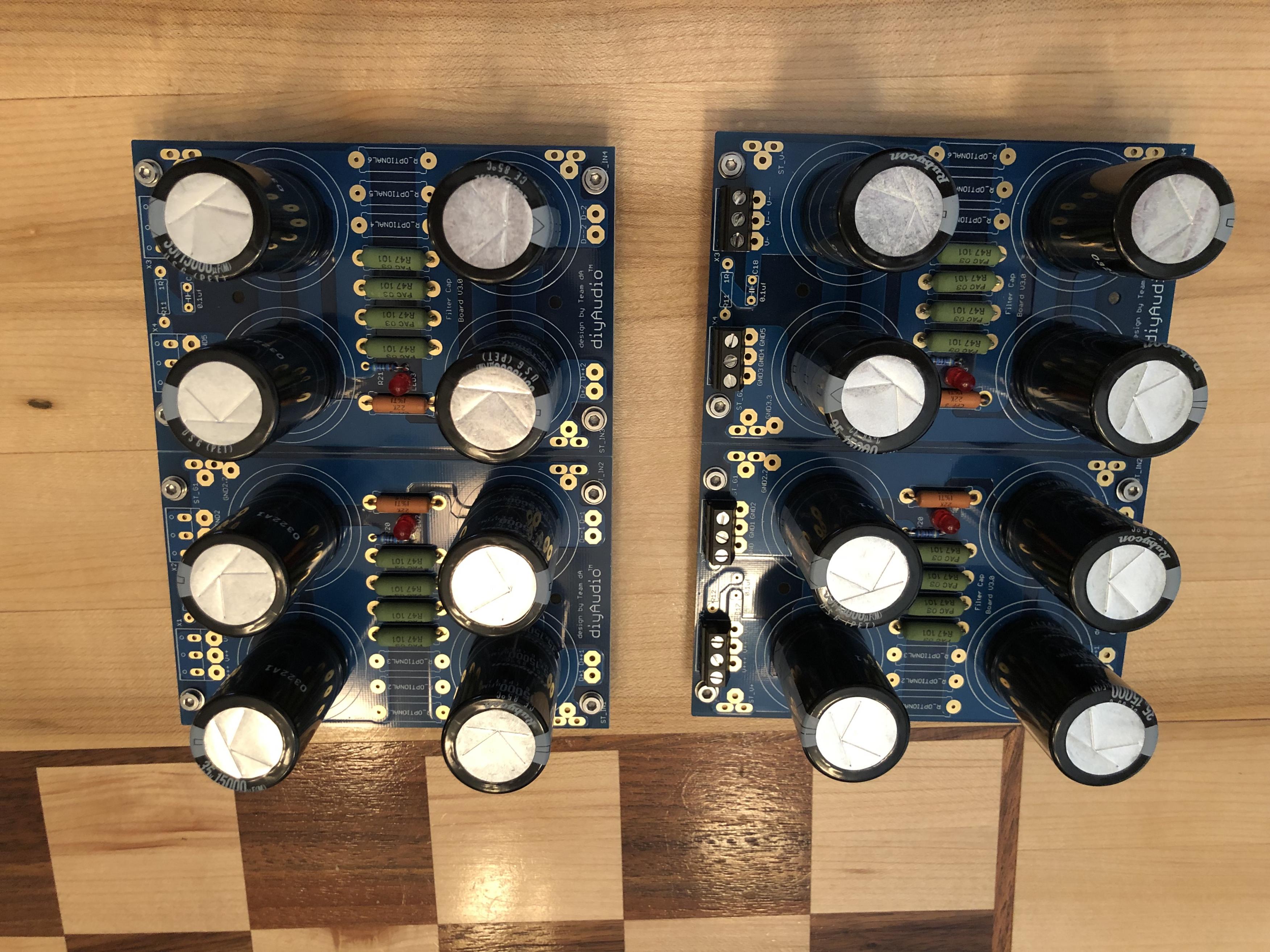

I did exactly the same thing when building the power supply for my F6 and thankfully caught it too.
Forgot to bridge the ground planes?
I think chanthing got it. I accidentally reversed polarity on one of the caps. Had a nagging feeling for several days something was off every time I was working on the amps then it finally sank it. I'm a bit stunned I made the mistake in the first place but we're all human after all.
yes, very. Fun to explore the world of audio but some science projects are left to the mythbusters.
