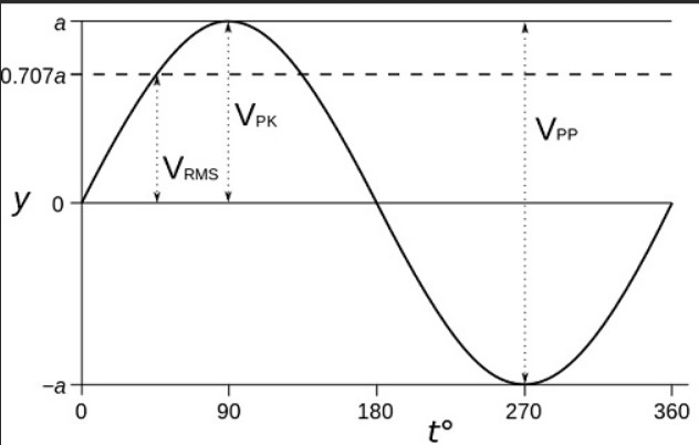

Hi all, this is a super newbie question. My electronics is so rusty now but I hope someone can help me out here. The recommended transformer call for 18vac out but how can it achieve 24vdc with all the voltage drop across the diode and resistors? I mean how does it go up from 18 to 24? ��
18 vac is an rms value. The peak value of 18v rms is 18 multiplied by root 2 which is 25.4 volts. Or as shown here you can divide the rms value by 0.707. Either method gives the same result.
That peak voltage is the voltage a diode rectifier and capacitor will charge up to (less volt drop losses across the diode/s).
Your meter would show 18 vac and a scope would show 50.8 volts from top to bottom, in other words the peak to peak value.
