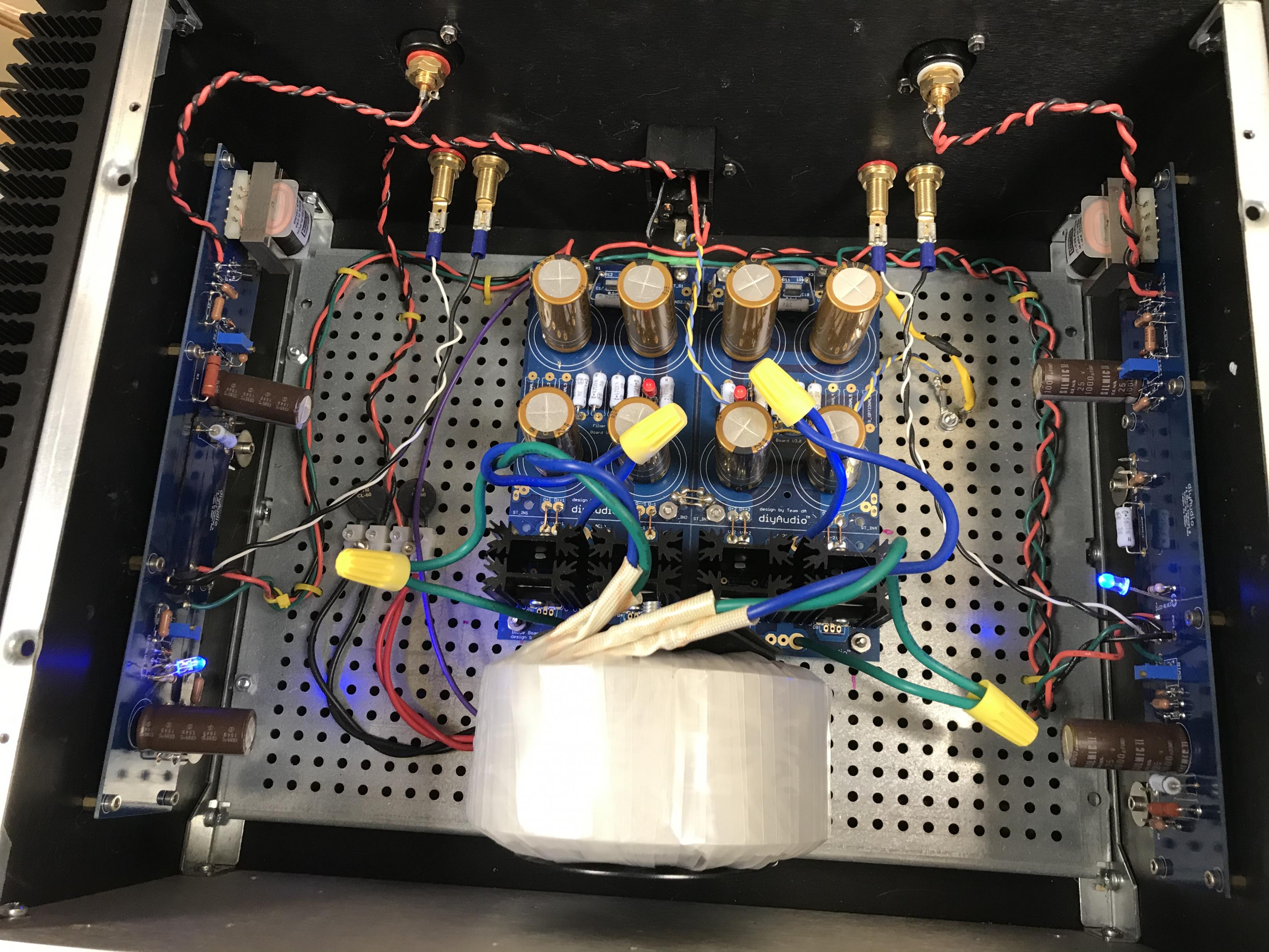

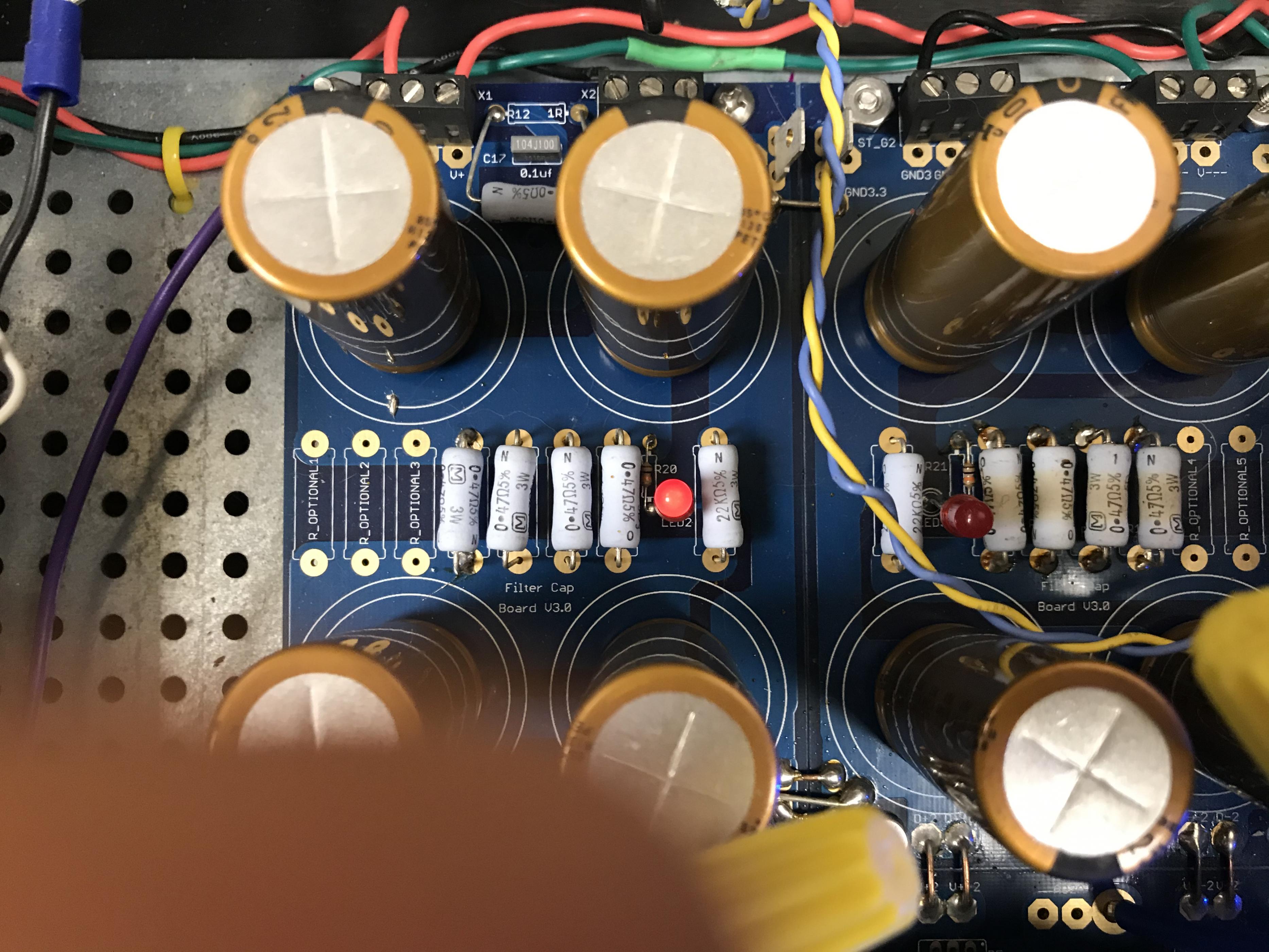

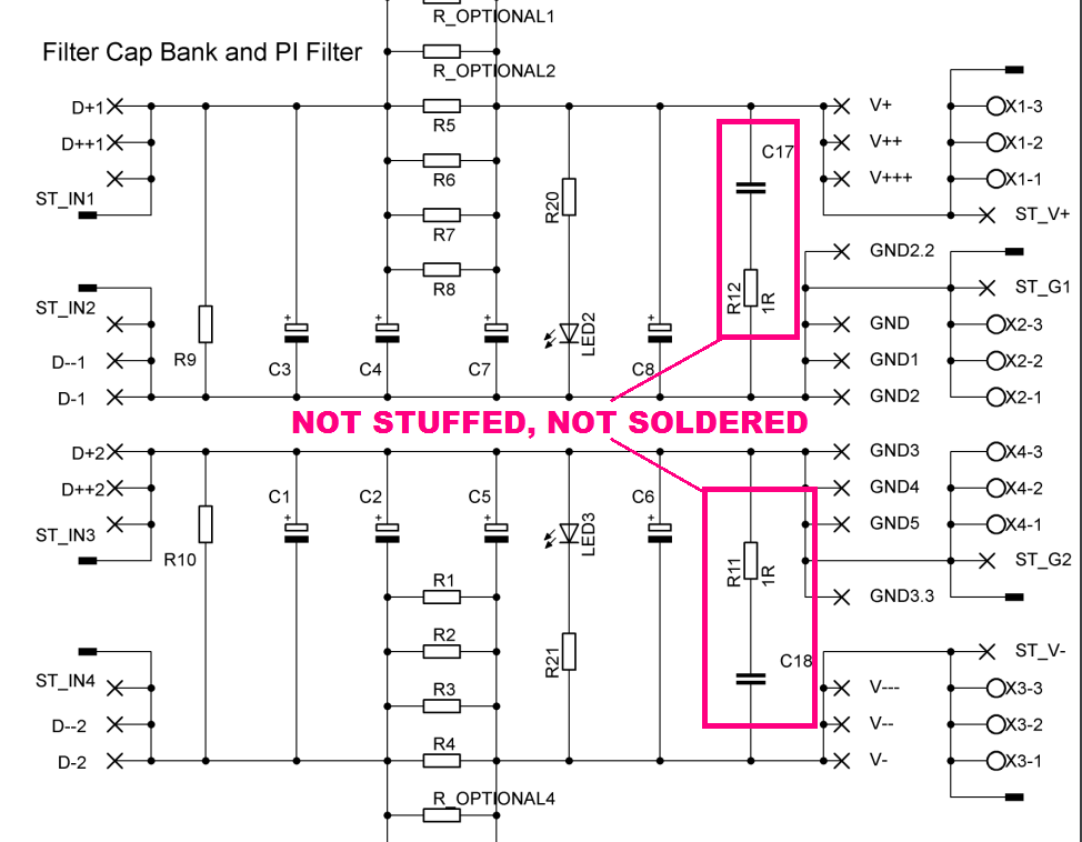

I just stuffed and soldered straight into the component footprints that were provided on the board, as-shipped from the store. Schematic annotated in pink. (Component values came from Quasimodo testing)
The application was a chipamp, built in a Modushop Dissipante 2U chassis that I also got from the Store. Photo below.

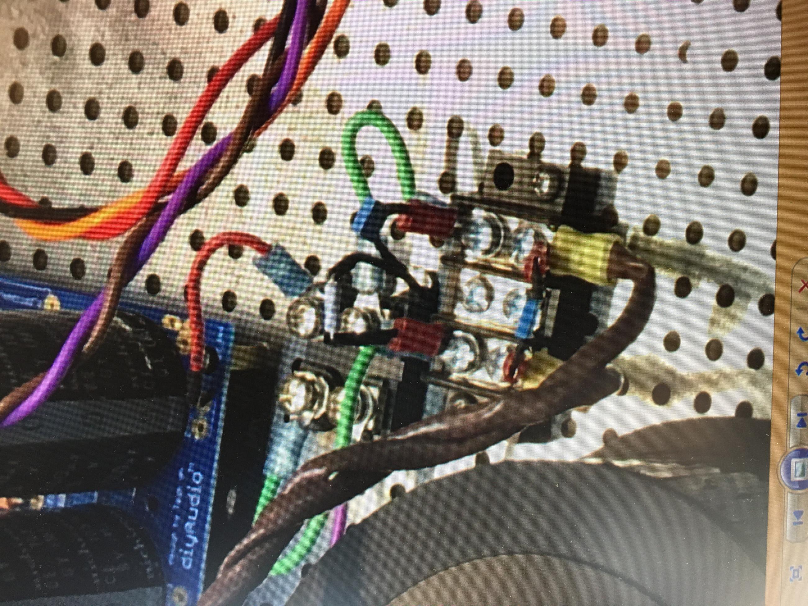

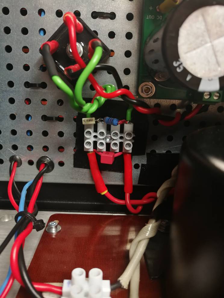

Thanks all, I am not using the diode section of the UPS V.3 board. I have a bolt down GBPC3502 rectifier.
I think I will use the diode section of the UPS PCB now! That will keep the snubber circuit neat.
