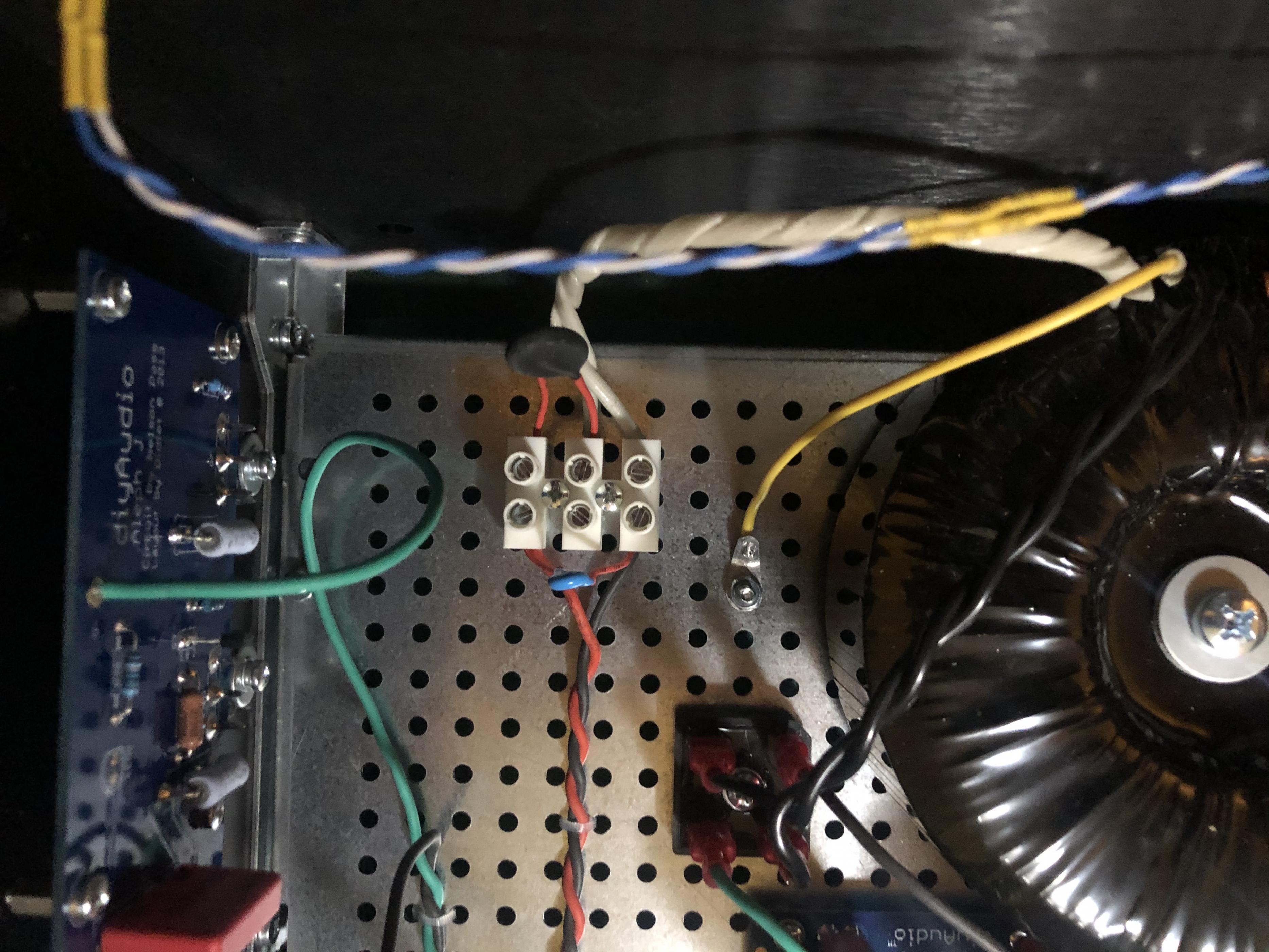

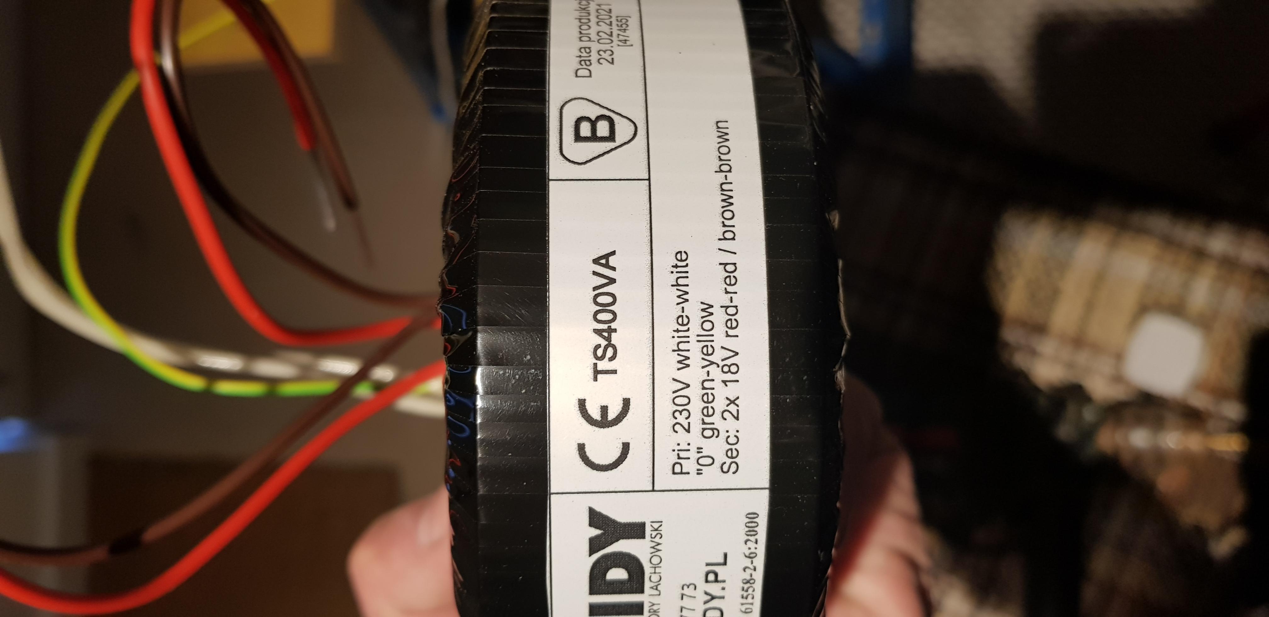

Just received my Toroidy transformer. I am a compete newbie here. I've asked a friend, but I'd like to confirm with you guys please. As you can see, secondaries are Red-Red, Brown-Brown.
So does red-red go to one bridge rectifier and brown-brown to the other rectifier?
Also, as this is 230v, UK voltage. Do I have one CL-60 on the live-neutral connector and x1 cap across the two white transformer inputs? I know this should be obvious, but want to double/triple check.
Thanks all for your much appreciated help!

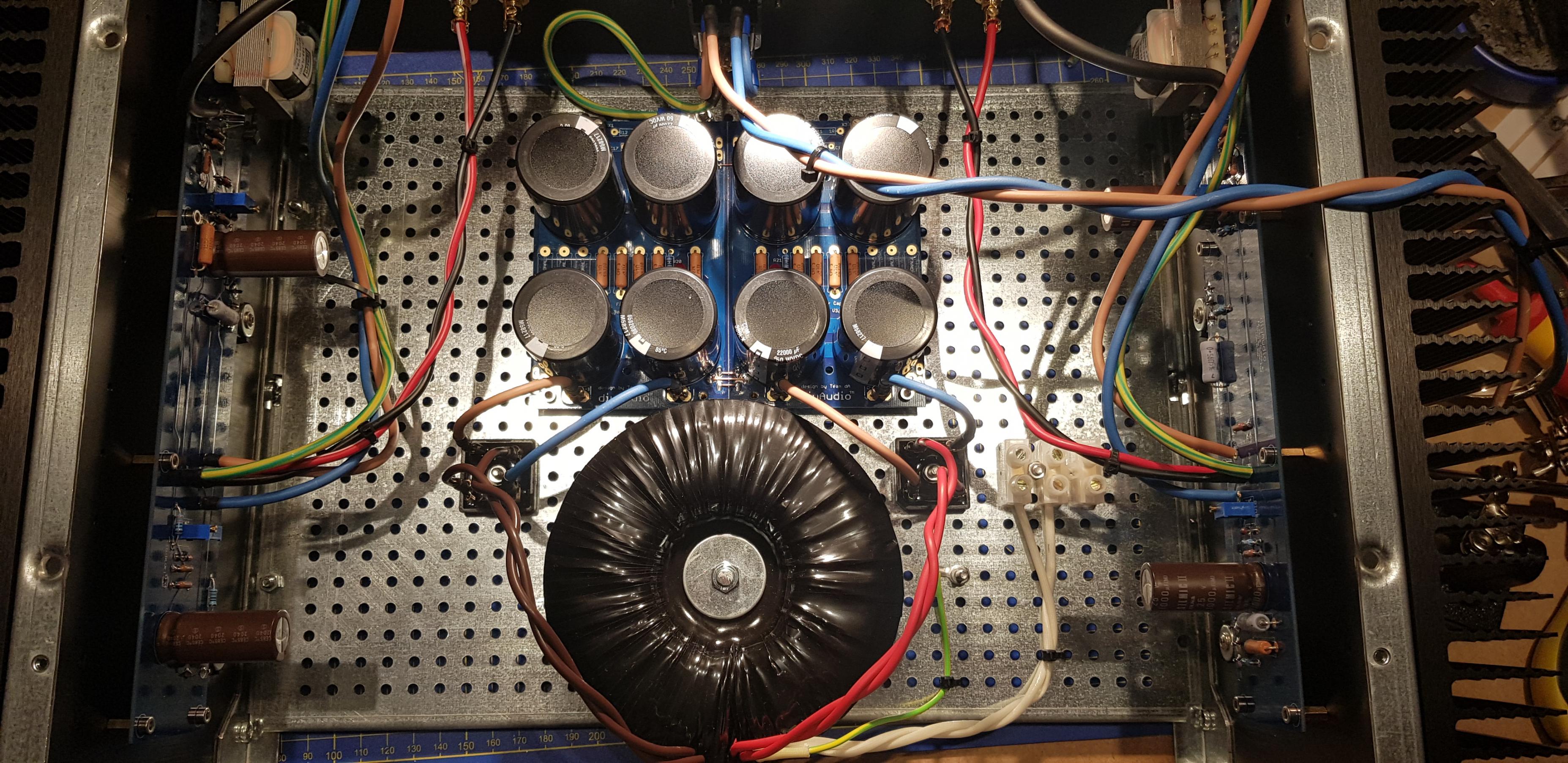

Yes, you are right about red-red and brown-brown.
Capacitor goes between the live and neutral. C60 goes on the live wire from the switch to the transformer. Perhaps pictures will help.
