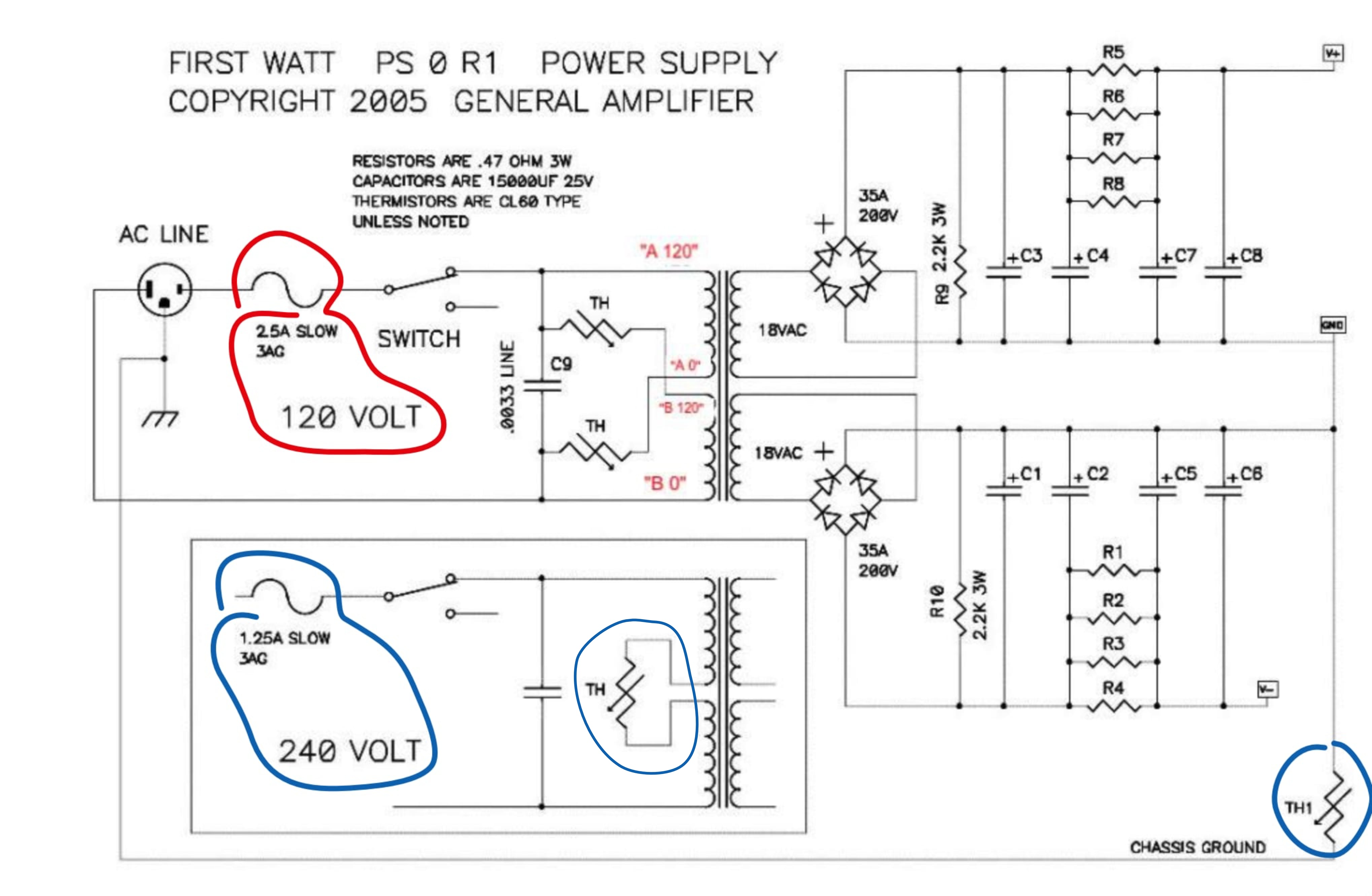

Questions regarding Thermistors TH and TH1. The schematic for the DiyAudo Store/First Watt Universal Power Supply includes components TH and TH1. Attached. The 120V build specifies 2 x TH and 1 x TH1 whilst the 240V build specifies 1 x TH and 1 x TH1. Strangely these Thermisters are not included in the UPS Bill of Materials so far as I can see. BUT both TH and TH1 ARE included in the Bill of Materials for MOUSER prepared by ‘flohmann’ who has documented a very helpful Build Guide for the Adelph J in his Google BLOGGER (Mouser Electronics, Inc. Australia) website. My questions are: Q1: Why aren’t the Thermistors included in the DiyAudio Store Bill of Materials for the UPS? Q2: Where are TH and TH1 mounted? On the base of the chassis or on a heat sink or on a Printed Circuit Board or where? Q3: Are both TH and TH1 the same part number (specified by ‘flohmann’ as Mouser 527-CL60. Unfortunately it is impossible to read 90% of the writing on the UPS printed circuit boards because the images are very low resolution so the numbers are blurry and pixelated. These PCBs are out of stock and I do not have any but I am trying to do what I can before they come back into stock. With thanks Geoff
Good morning!
0) flohmann‘s amp is called »Aleph«
1) the thermistors aren’t in the official bom because they aren _on_ the board. And because these solutions are the easiest well working possibilities to achieve what they have to...
2) You use them for a) limit the inrush current on power-on (the ones connected to the main hot) and b) to „elevate ground“ (the one going from the boards 0V to the chassis.

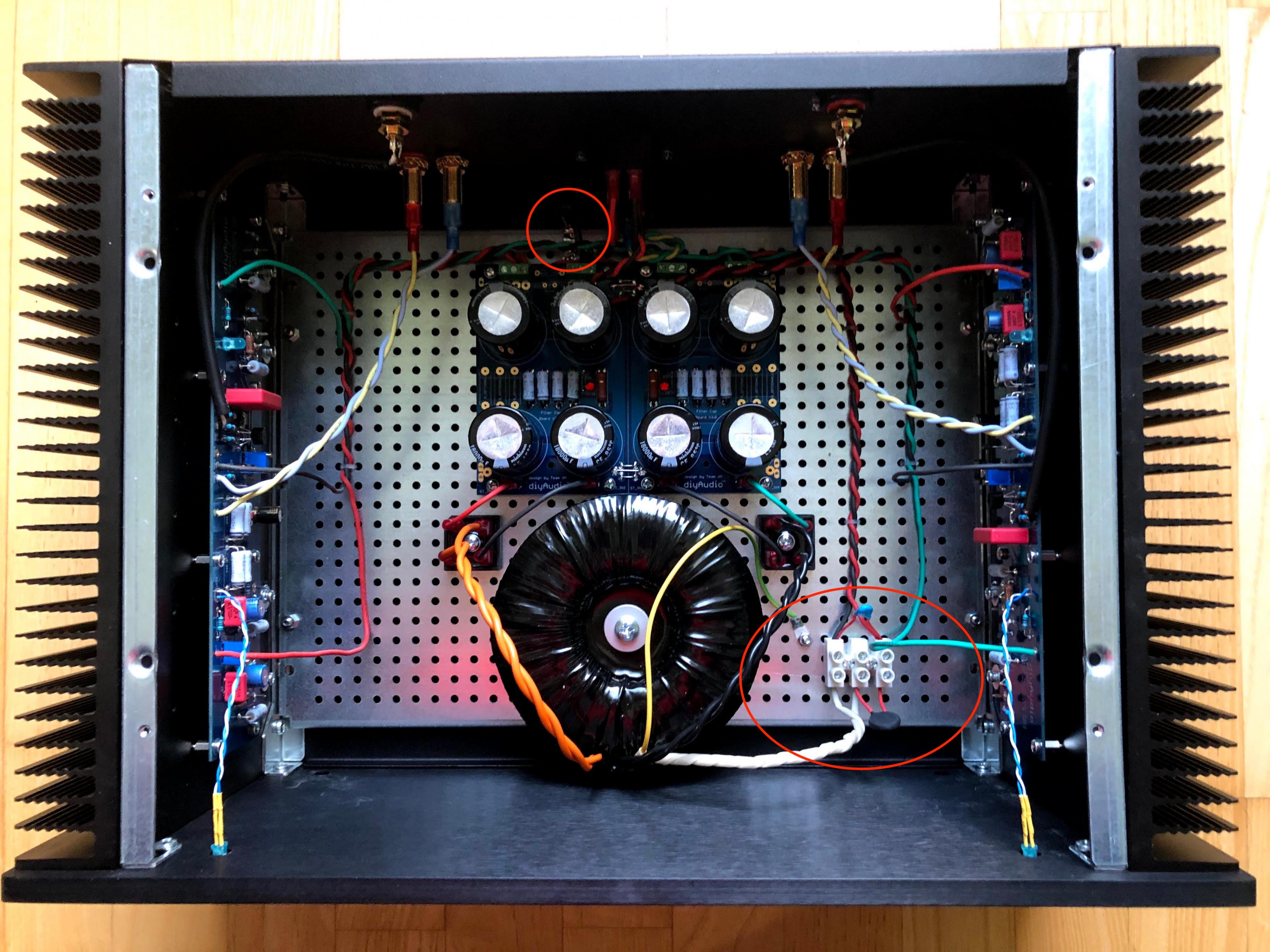

In pic 17 from the top, you can see a terminal block/connector block with two circular black things, and one blue. Disregard the blue for now. The two black ones, are Amphenol CL60 5 amps 10 ohm thermistors. These do what myleftear said: they work as a softstart, meaning they ensure your mains fuse does not blow at power on. They also spare your PSU parts, lengthening component life. And the also filter out some of the mains high frequency noise. A nice package, yes?
What you are seeing on that pic, is the wires from the mains inlet entering the terminal block. There they are connected to the thermistor, forcing the current through the thermistor. The job of the thermistor, or one of it’s jobs and most important in this application, is to slow down the current from the mains. Once the thermistor heats up, it’s resistance drops in parralell with thr PSU caps reaching full charge. Think of it as a controlled acceleration.
Note that two thermistors is for 110-120Vac. For 220-250 volts, in Europe etc, only one is used.
On pic 18, you see the thermistor used as sort of a ground lift. It is connected between the PSU PCB 0v/ground, and the chassis. There it provides resistance/impedance between the two, so that if there are small loop currents they will in effect be stopped/impeded by the thermistor, reducing chances of ground loops between the chassis/safety ground and signal ground/PSU 0v.
Using thermistors is cheap and simple. There are other ways of doing this, but few as cheap and simple as thermistors. Nelson uses them, so they will be good enough.

For TH, this is the thermistor that is used to surpress the high inrush current on the moment of the turn on of the amp. It's resistance is higher when cold and therefore it restricts the inrush current. Then it is heated up by the current flowing throuth it (to 80-100C) and it's resistance goes down to 1ohm or below and therefore it kind of "dissapears" from the circuit. You put this thermistor on the "hot" power wire just before the transformer. The power supply schematics specify the CL-60 for TH, but there were some discussusions in the forums that 11 ohm cold resistance of CL-60 is a bit too low for 230V and there were recomendations to use something of up to 60 ohms cold resistance. You could still blow some fuses with CL-60. My personal choise was this, with 47 ohms cold resistance:

You will still need one CL-60 for another purpose, to "lift the ground" between the power board and the star ground of the chassis to eliminate the ground loops. So, order one of these too:
https://eu.mouser.com/ProductDetail/527-CL60/
See the picture of the mains wiring for 230V (this is my Aleph J). TH is in the bigger red circle. You also see the mains capacitor there which has to be wired between the hot and neutral wires of the mains:
DE2E3KY332MN2AM01F Murata Electronics | Mouser Europe
The CL-60 is in the small red circle but hardly visible here.

Avitkauskas - TH1 is not a fuse. It's a thermistor used for the ground lift.

Oh, yes. I did not notice the small circle at the bottom right in the Geoff's picture. Sorry.
And yes, Geoff will need 1.25A fuse(s) for F6 on 230V.
