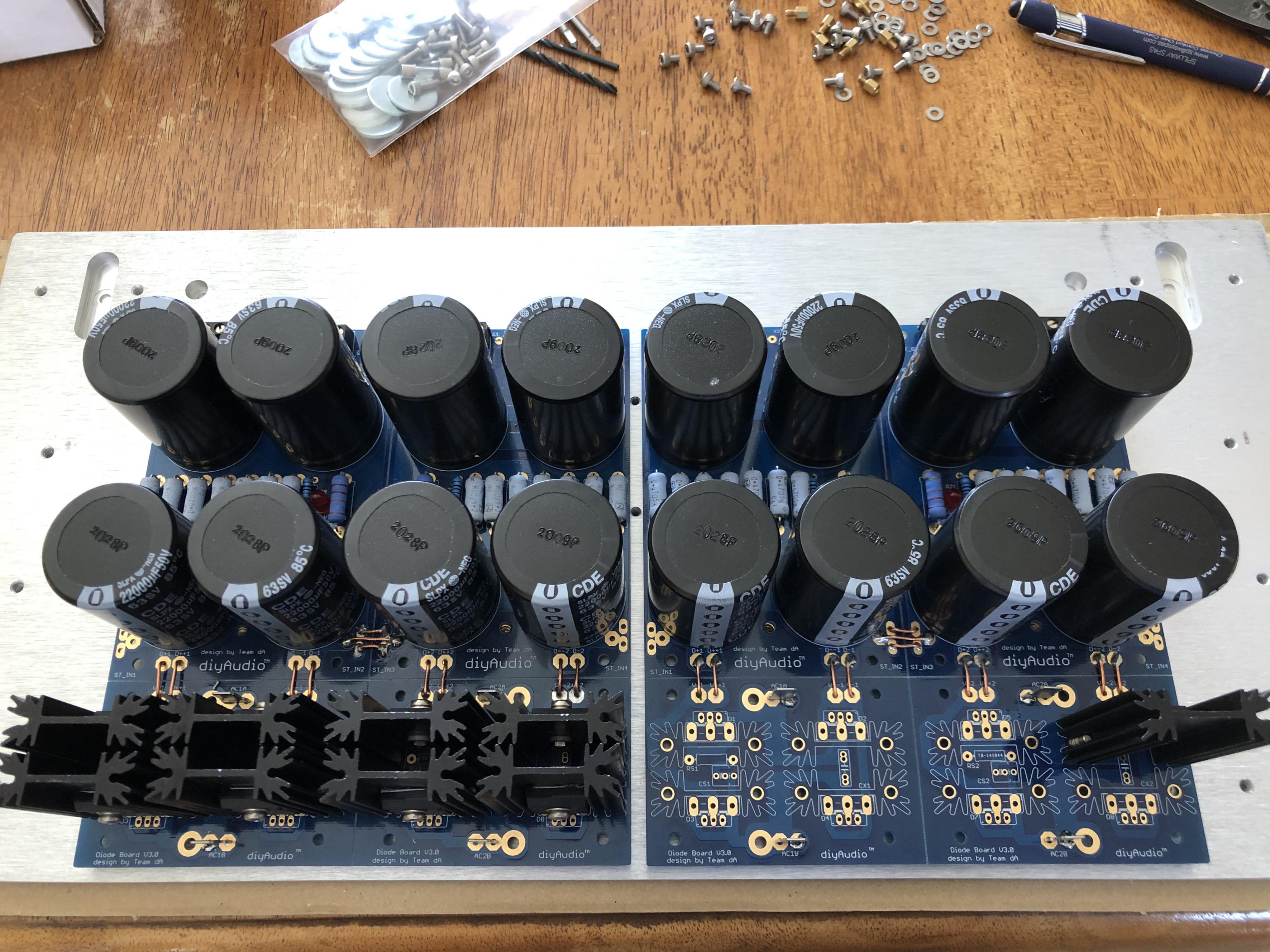

Is it Ok to mount the boards the power supply boards with the rectifier portion still in tact to the front chassis panel like in the picture I included or should I have the rectifiers mounted to the base for maximum heat sinking of the rectifiers?
The heatsinking is 100% via the PCB mounted heatsinks and has nothing to do with what the board is mounted to.
That said, I dont think you can assemble the amp like that (PSU on front plate) with the rectifier section attached... You'll need to see if it clears the chassis floor.

6L6 is right as always. For what it’s worth I considered mounting the whole shabang on the front plate. Well vertically that is impossible or at best extremely close. You could either split the boards or fllip it 180 degrees, if only one board and you are OK with the assymetry. I would try to find a way to put the boards on the chassis floor, and if you split the rectifiers from the PSU section beware those connections will have a lot of ripple on them.

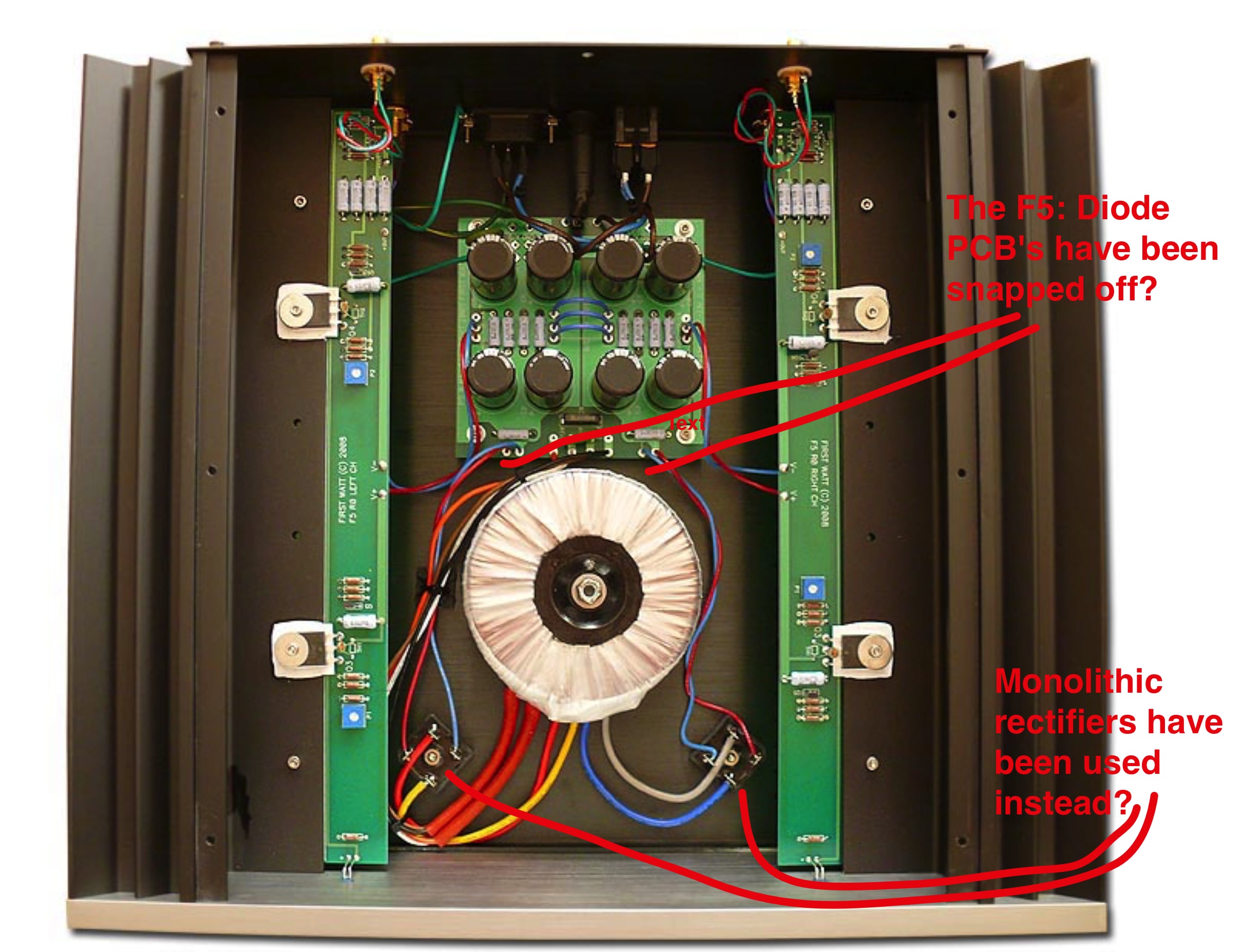

Hi, Geoff!
The schem is for a FW power supply by Nelson Pass. The tranny is reflected in those waveformed lines in the middle there.
The universal PSU can be used to make a fitting supply iaw that schematic.
Andy
Geoff, what you see in the second schematic (PSU v3.0) is the right hand side of the FW full power supply scheme in the first one (everything to the right side of the transformer).
Now, the left side of the v3.0 schematics is for the discreete diode bridges that you will not use. You will use monolitic rectifiers like these:
https://eu.mouser.com/ProductDetail/625-GBPC3502-E4/
Also, you will not need the R11-12 and C17-18 what makes the output snubbers that are not needed for F6. And you will not use the optional resistors.
Now you can see that the schematics are quite identical.
One more note. In FW schematic R9-10 (bleeder resistors) are indicated as 2.2K, but in the PSU BOM you'll see 4.7K-22K. That's ok, anyting will do. The higher the value, the longer it will take the capacitors to discharge without the load when you switch the power off. But that does not matter much.
Hope this helps. I remember myself building the first amp 🙂
-Alvis

Hi Patrick (itsAllInYourHead)? - I tried to send this in a PM but the address I used was wrong apparently. I consider that I know next to nothing about electronics. The replies I get may as well be in French because I have to look up Google for an explanation to every second word or term! And that takes hours! I have a little experience. I did the Overnight Sensations speakers and soldered up the crossovers. Ditto the Sunflower Redux tower open baffle speakers and I helped a mate who built 4 x Modulus-86 mono blocks and I built the Amp Camp Amp on my own which worked first time! BUT nothing has prepared me for doing the Universal Power Supply!!! So basic and simple suggestions are welcome. Nothing anyone says will be taken as an affront! I have spent the morning reading up on toroidal transformers and how to wire them up and I am making progress but some way to go of course. On the Universal Power Supply PCBs I assume from the replies I have that I snap off the bottom 1/4 ie the diode section and instead use 2 x Monolithic Rectifiers? I cannot find a high res photo of a F6 fully built up so I am using one of the F5. Which is attached. Cheers Geoff Lee, Melbourne Australia.
Hi Geoff -
No worries. I got a message, but it was just a reply with my note quoted.
tl;dr - you'll really enjoy the amp when you're done. We've all been in your shoes at one point or another.
When you get all your boards and parts and follow along in the blog, things will start to look a lot more familiar for the PSU. The F6 build guide has some nice photos that should make it easier for the amp boards.
Just ask questions along the way if anything gets confusing.
:cheers:
Patrick
