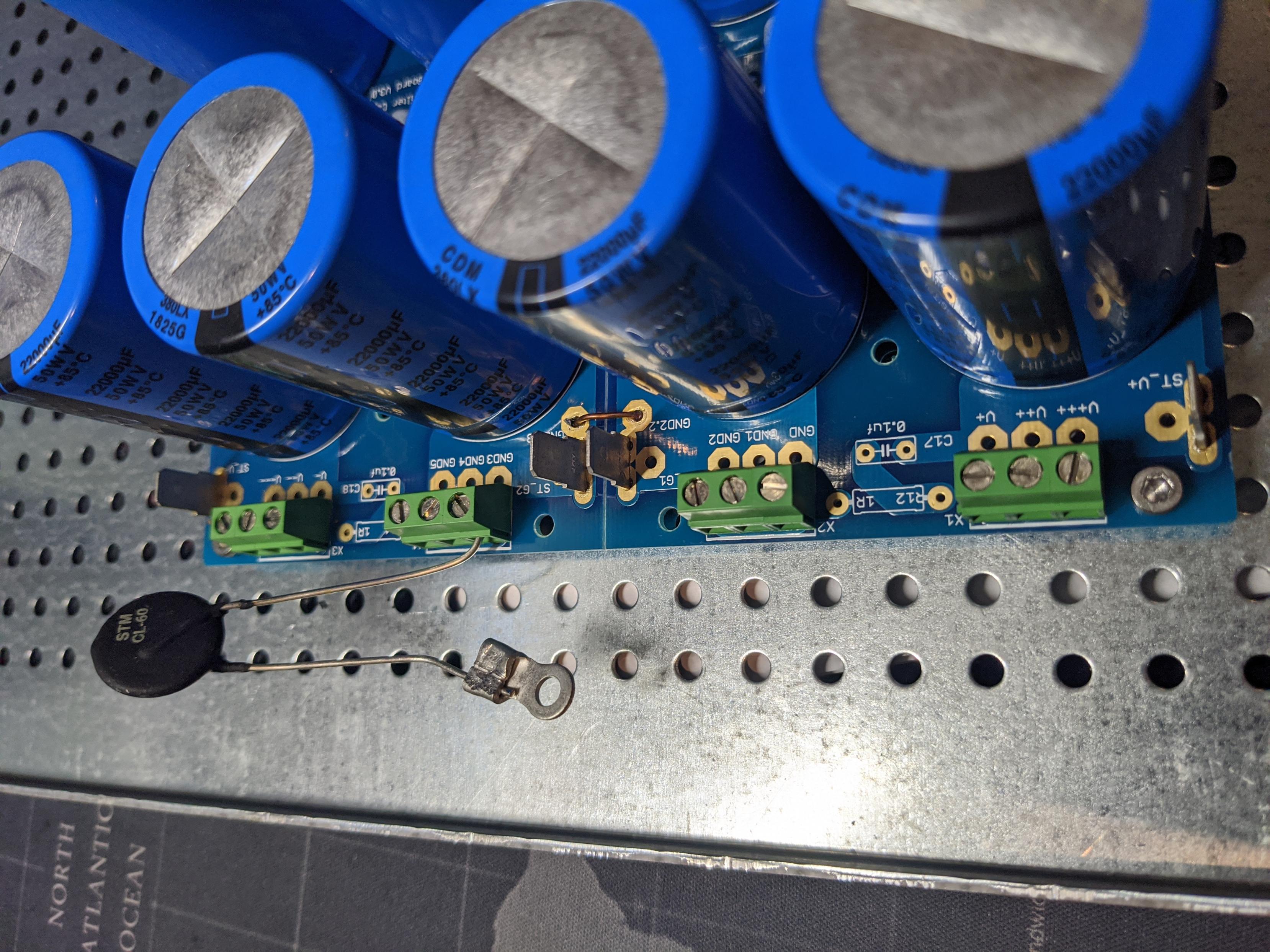

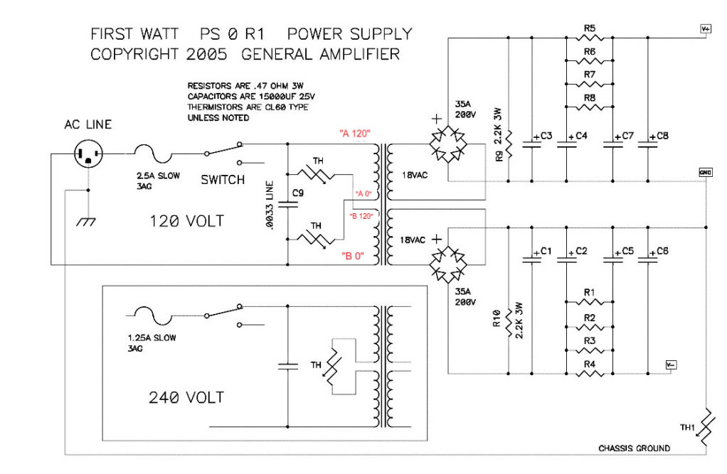

I think the last question I have is the ground chassis. I have looked through the thread here and elsewhere and I am just a little unsure about how to go about wiring the star ground.
As far as I can tell from Nelson Pass' F5 Turbo Power Supply schematic, there is a thermistor in series from the ground pin on the AC line in to the chassis. There is also a diode array (35A, 200V), I think in parallel.
I also think I read that the CL-60 in series from the ground pin on AC line in to chassis is an alternative.
Do I have that right?
And if not how do I go about wiring the ground chassis? I couldn't work it out from any photos.
Just saw this.
No. Don't do that. One thermistor in series with the AC primary only.
The other CL-60 goes on the output of GND at the power supply.
thanks WKCox. Your reply and the photo from 6L6 in post #896 helped.
Jim, why in that photo do you have a yellow and a green wire from the AC GND twisted together?
Here's what I have at the moment. That CL-60 will connect to chassis ground when that's done. Does that all look good?

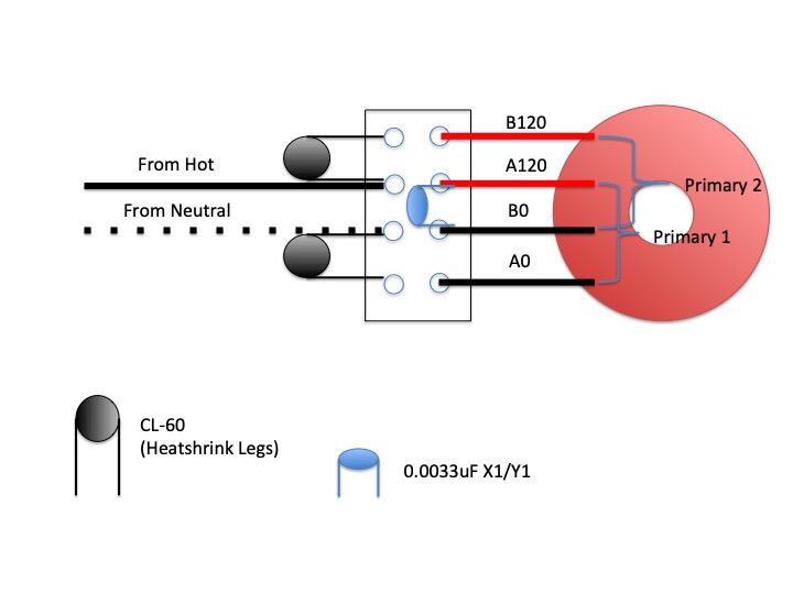

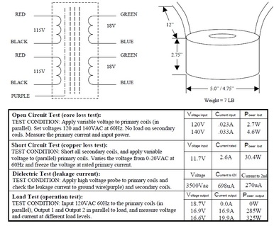

Assuming you have an Antek transformer, there are usually two primaries, with a red and black wire for each primary. To identify the wires for each primary, check the resistance of the red - black pairs. A pair of wires will measure infinite resistance (open circuit) if they are not of the same secondary. The correct pair of red - black wires of a secondary will measure a low resistance (have continuity).
Yes, you need to identify the wires for each primary and then connect them in accordance with the schematic.

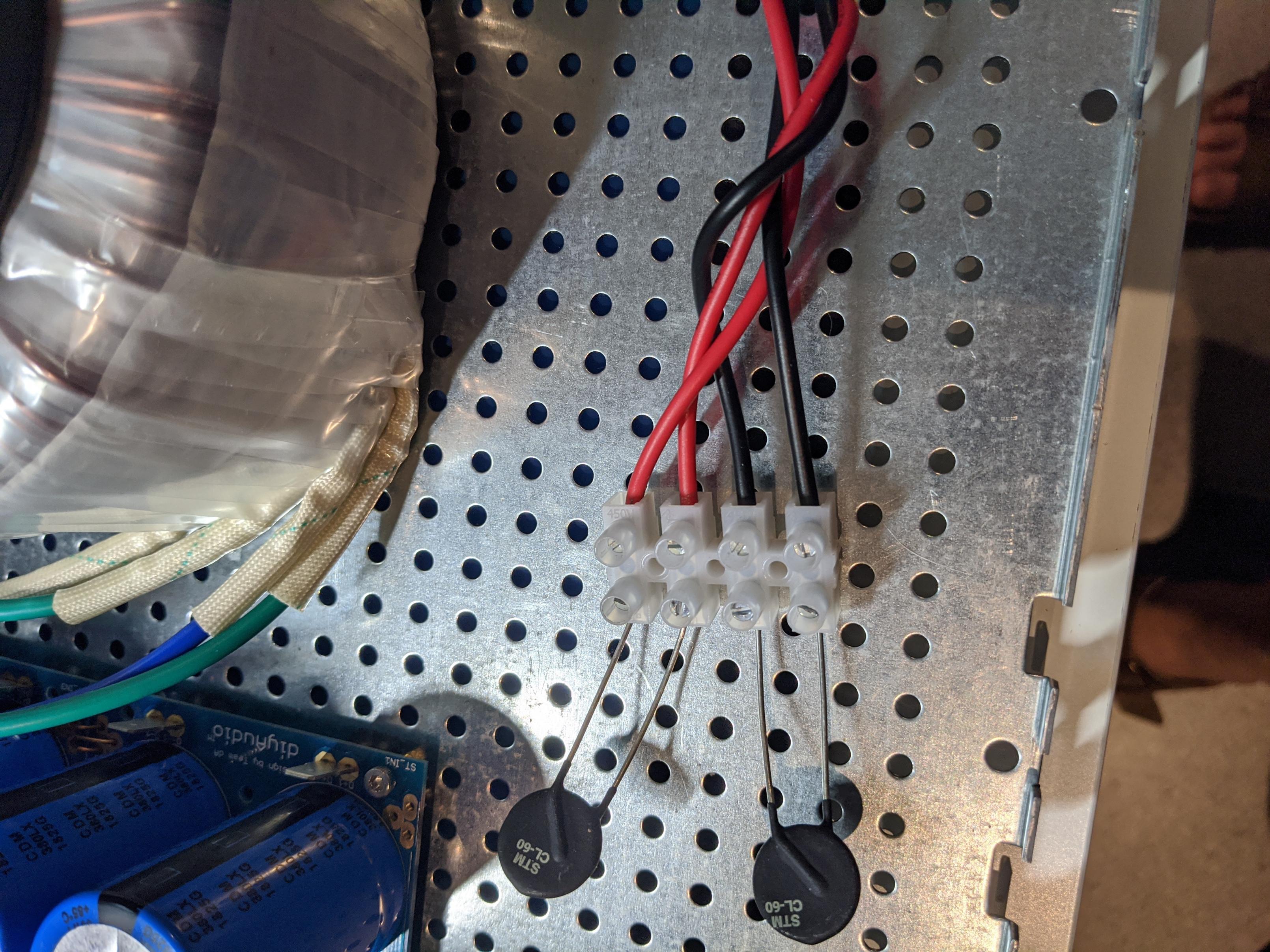

Thanks for response. I don't think I asked the question very well.
I need to connect the primaries to the barrier strip with the CL-60s and safety cap. The wiring has the two black wires in position 1 & 2 and the two reds in 3 & 4.
I am wondering if either black wire can go in position 1 & 2? And if either red wire can go in 3 & 4? I think they can I just want to confirm since there is clearly a longer red/black pair and a shorter red/black pair.
Again, I have to stress that you have to identify the red and black wires that belong to each primary. You should label one pair of primary wires "A" and the second pair of primary wires "B". Then the AC live goes to Red "A" and the AC neutral goes to Black "B".
This is assuming you are building a FW power supply with an Antek transformer at 120VAC.
Yes it is an Antek AN-6225. And yes 120VAC for F5Tv2.
Thanks for clarifying. This is clearer to me. I just powered it up and everything worked just great. I will be doing a build guide similar to 6L6 when the gain stage is done.

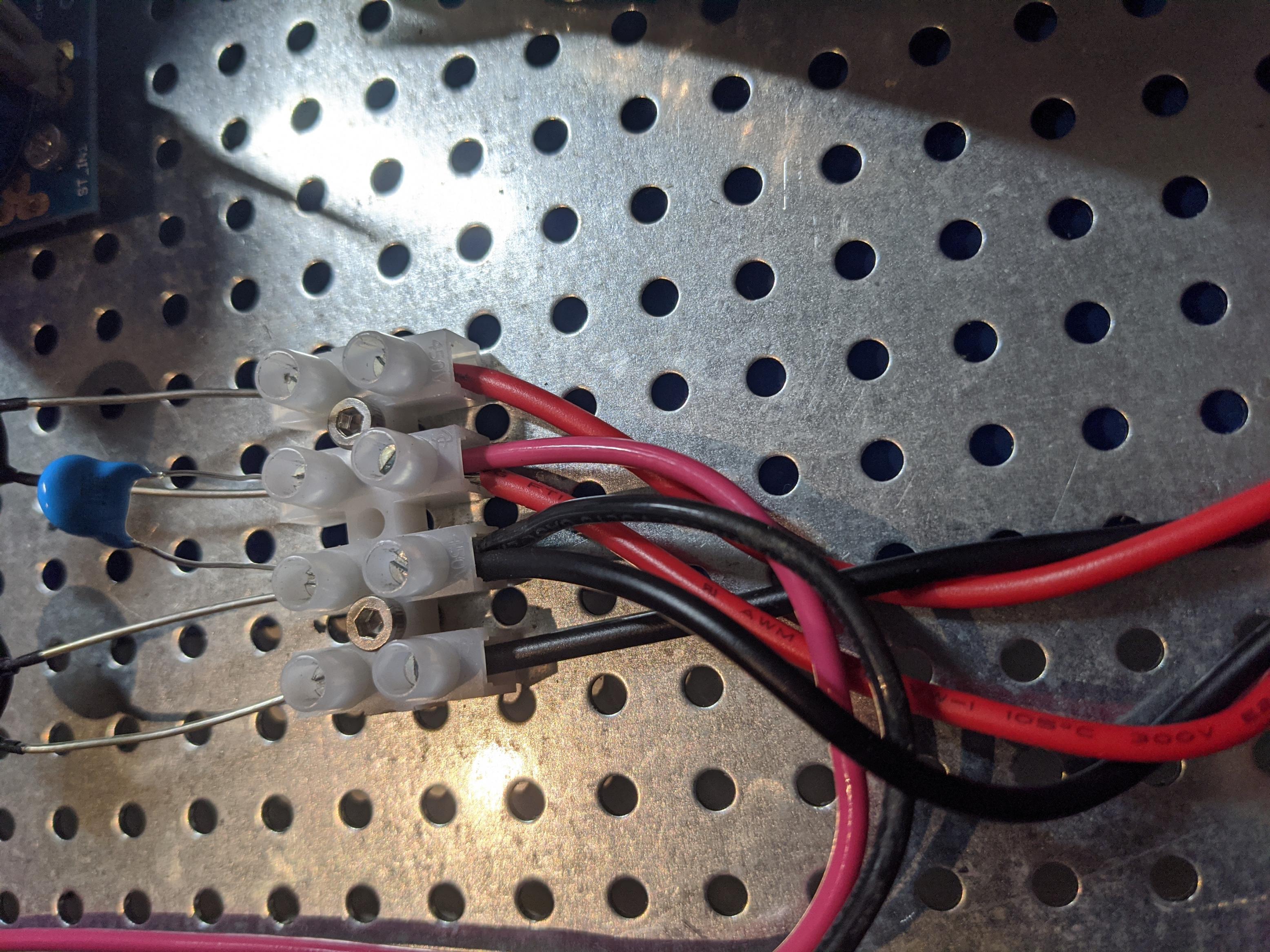

But back to this....(I couldn't label the image easily on my computer). I could work out the two red/black pairs easily. The A pair is in the middle of the barrier strip.
I had the AC live (red in my case) to RED A but actually had the neutral (black in my case) to BLACK A, not BLACK B, contrary to what you suggest. See photo. I was looking at 6L6 photo (also attached). He has the neutral (white) going to RED and the live (black) going to BLACK , contrary to Allinmy head image.
I can't tell what pair they are, hence, my initial question: Given this is AC, does it matter how the live and neutral wires are connected, so long as they are connected to a red and a black.
Did you identify the red-black pairs for each secondary? If not, then you need to disconnect and identify them.
Then wire everything up as diagrammed.
The live and neutral may be flipped, but the connection must be to Red A and Black B.
But if you don't understand what is going on and you are just connecting wires, you should follow the instructions exactly. You are dealing with live electricity and mistakes may be deadly.
The power switch and fuse must be on the live line.
