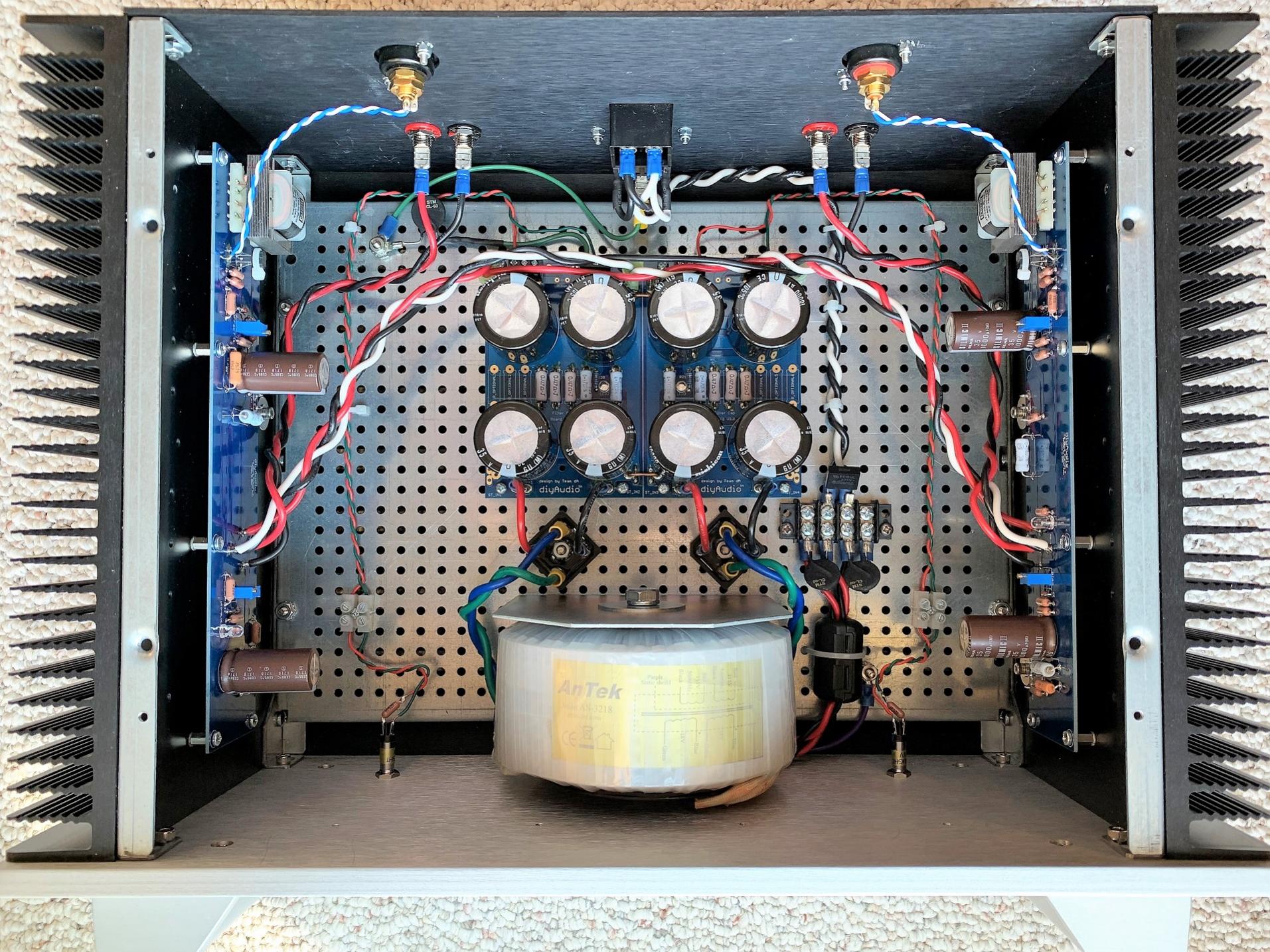

Total newbie here- planning to build the F6. I'm fixing to order the 4U Deluxe Al chassis. I like the look of black- will I be missing out a lot by not getting the silver front panel with all its pre-tapped threads (which I don't plan to do myself...)? I got the Antek 400VA 20V- and it seems it'd fit on the bottom panel along with the PCB: I plan to use monolithic bridge rectifiers so I'll just snap off the rectifier part of the PCB. Seems it'll fit in the 300 x 360mm surface. Any thoughts welcome- thanks!
The tapped front panel is nice for spacing out a few things in your build if it's ever needed. I wouldn't consider it necessary.
You'll have a snug build with a 300mm deep chassis, but it will certainly work well - particularly if using monolithic bridges. There are a lot of example pictures that can help with layout choices. However, if you think that down the road you may want to re-purpose the chassis for other amps and/or try out dual mono - you may consider the 400mm deep version for $30 USD additional if you have space and funds. It is extremely versatile.
Also, having just a bit of extra space makes the layout easier for new builders. It certainly did for me. Someone can probably educate me, but I think in order to get the options you want re: deluxe (back panel and UMS sinks) in a 400mm deep version, you need to order the non-deluxe aluminum version and "add" the options for deluxe style rear panel and UMS heatsinks. I haven't personally done this, but Jason and the store team are phenomenal and can help you out. Also, Modushop has been fantastic with any requests I've had.
Additional suggestions if you haven't already considered - I'd recommend paying the few dollars for an extra set of hardware ($5) ... I always drop a screw or two. Also, the rear panel kit is awesome for new builders. It saved me a lot of headaches and in addition to nice quality IEC, speaker, and input hardware, it comes with all the hardware for mounting your boards and output devices also. It looks to be sold out at the moment, but they're usually reasonably fast on replenishment.
Enjoy the build! 😀

Plenty of room in the 4U Deluxe chassis, especially if mounting the toroid on an L-bracket. This may also help reduce hum pickup by the input transformer.
Here's my F6:
