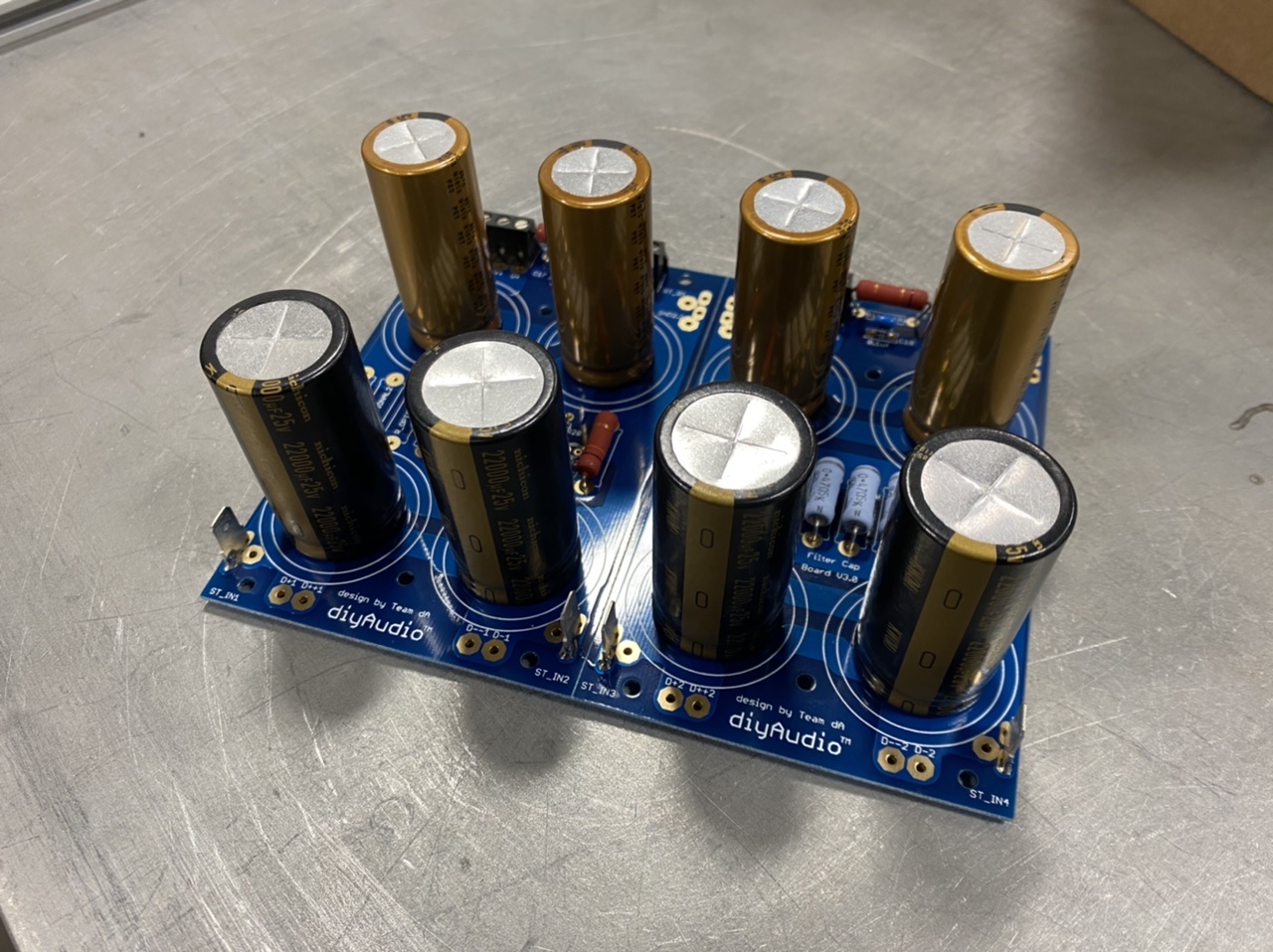

Soldered power supply PCB for my up and coming F6 build.
I soldered in the capacitors in but had a thought afterwards.
I put 2x 22000uf caps on the input side and 15000uf on the output side. (Had 4 of each on hand) What didn’t occur to me until afterwards is does it matter if i do this? Should it be 22000 on the output side instead? Is it ok unbalanced like this or am I just over thinking this.
Image for reference:
No problem with the cap configuration, looks all fine.
2 things that you need to watch out
1) You haven’t connected the ground points in the pcb: it is tagged on the pcb board, you can also check 6l6’s build guides for a picture
2) Your transformers secondaries: those caps are rated 25v, you should be fine with normal 2x18 v secondaries which will give 23-24v rails: but you should not go above that value
Hope it helps
Thanks Syracuze.
Yeah I do know about the jumper. Have not decided if I will separate the PCB yet so will leave it til last. Also haven’t installed LEDs yet.
Yep at the limit at 25v caps but I think it will be fine as long as I stay under 25v.
Living on the edge. Lol.
Had them in stock so didn’t want to waste em....
I’ll double check output of rectifier before powering up the boards.
Cheers
