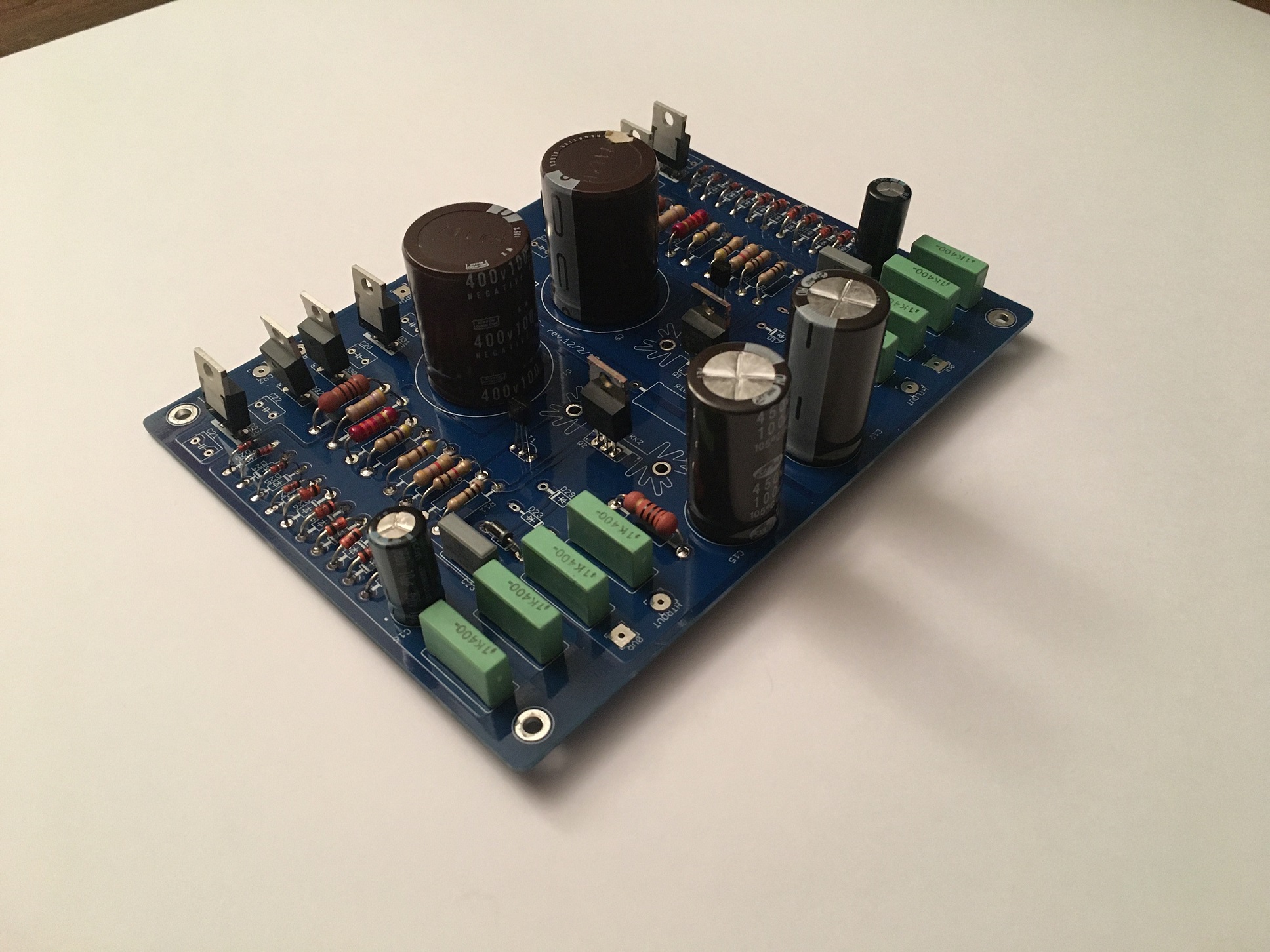

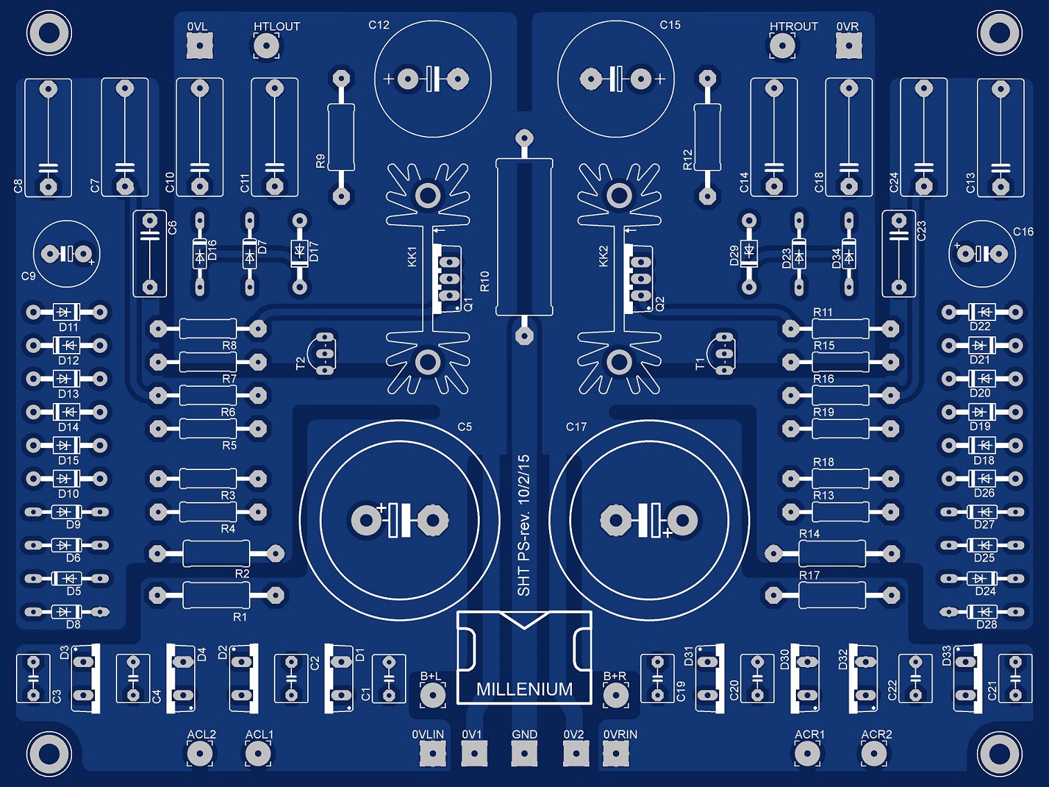

Okay thanks for your ideas, board size was stated in the post, with the pic, best to take any further discussion offline and leave this thread devoted to the design at hand. As Mark has stated this design is not intended for use with a center tapped transformer.

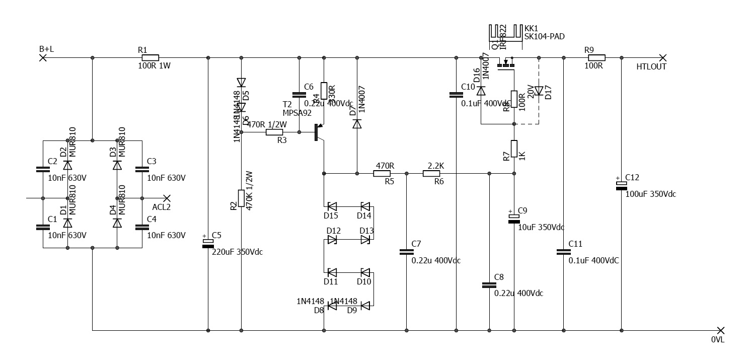

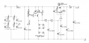

I would like to add this pcb that I have develop some time ago.
It is dual, regulated with a wide range of voltages.
Diode on board.
The diagram is one channel
Walter

What is the purpose of R11,12 and C17,18 on the original board. Are they necessary? I didn't populate those parts because the pics in the original build guide by 6L6 left them out. If it matters, I'm using bridge rectifiers.
...edit... are the the 'snubbers' that are not necessary for class A?
