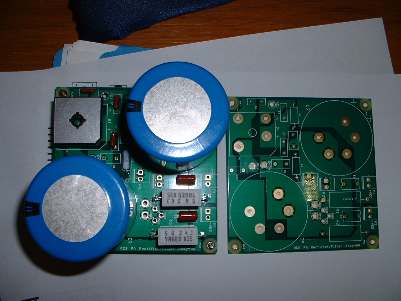

Is this what you are looking for?But a very compact rectifier board which allows for custom snubbering + choice of diodes would be very nice. Perhaps one with surface mount components so that it cold be fit nicely in place of the standard bridge. I'm surprised one doesn't already exist.
I guess one day I could re-design it to use fast diodes too, but the 100x100mm pcb size makes it about the cheapest one can do unless you want to get into a CRC design, use multiple ecaps etc, but I do wonder if it is really necessary, there were many great amps designed using these simple principles.
Okay, but is it really doable, in that size, to replace a 25/35A bridge with some smt diodes? how to cool the diodes? and put in the passive components in too, impossible in that size of footprint. Explains why no one has done it, because it is impossible to do.
I think an aggressive and motivated person could succeed, using four of the ST "Field Effect Rectifier Diodes" in TO-220, plus Cx in SMD, plus Cs in SMD, plus Rs in SMD. This amounts to a wager: that the incredibly low Vfwd of those diodes, prevents them from overheating, even with no heatsinking whatsoever.
Yeah I guess so, now that you mention them, I retract my statement of not doable. Pretty cheap devices, nice. FERD30SM100ST, FERD40H100STS look to be good ones to use.
Next rev. of my rectifier design I guess, save on the expense of a heatsink.

Until you do this new design (in which I would be very interested), do you have any of the boards available which you show above?
Ron
I have three of them, these where made in 2015, gold plated so good for ever. I have the BOM loaded in Mouser, I see that the ecaps are in stock

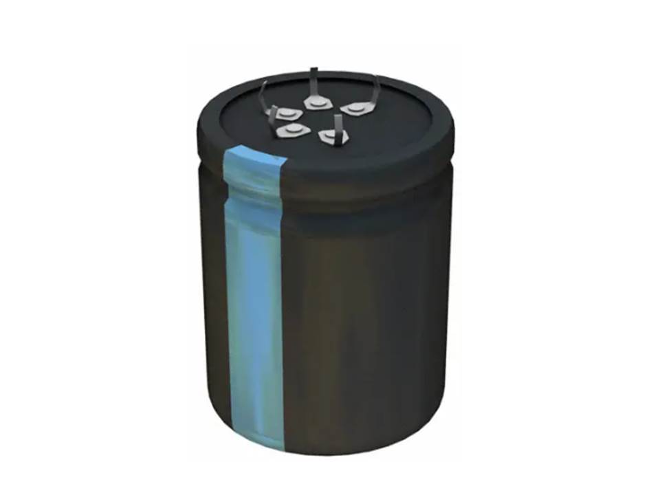

598-382LX223M080B062
The picture they show is not accurate, the ones I spec'd have 5 pins, 25mm pin space, VS type, 50mm diameter

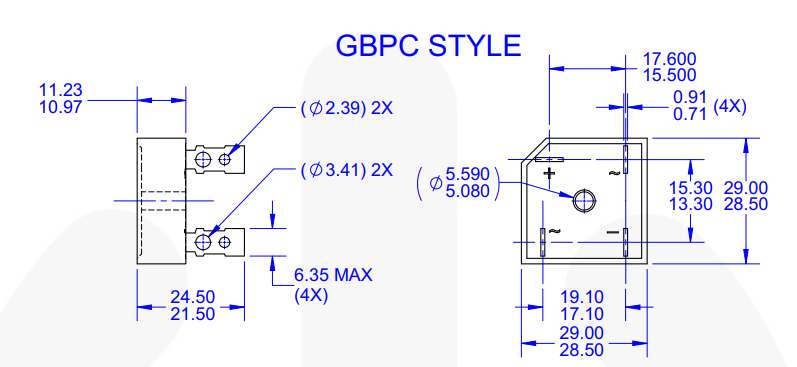

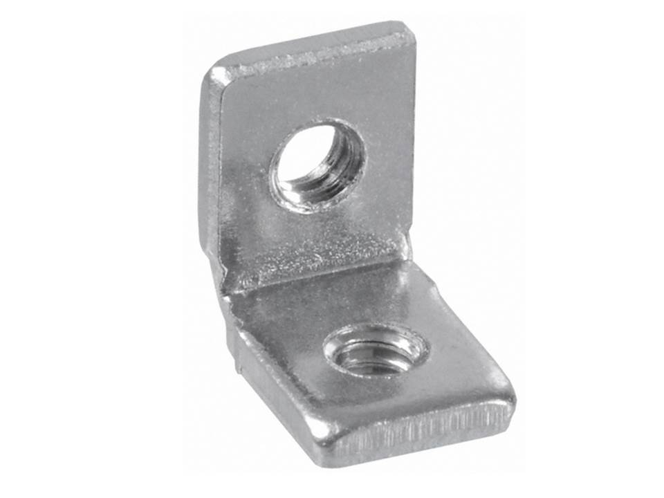

If I did that design to replace the GPC bridge rectifier, how would you want it to be mounted? one hole in the middle, to use a standoff, what's to stop it rotating around?
As far as a new board, the idea of a dedicated small rectifier circuit with snubbers, and designed to work with CT transformers is very attractive because it can be used as a simple, fast upgrade to the power supply of many existing amplifiers. And there is no commitment to a specific PSU design. So one could use it with the stock e-caps, or as part of an entire PSU upgrade. A drop in replacement would be really great, but I would be pretty happy with anything that was just small--there's not a lot of room in some of these amps if you're not building from scratch. Vertical mounting using a single screw (the same one used for the stock bridge) with something like the L-bracket below is one idea. Or flat, screwed in relatively tight with a rubber washer could keep it from turning. I would think something like this would be interesting to a lot of people.I have three of them, these where made in 2015, gold plated so good for ever. I have the BOM loaded in Mouser, I see that the ecaps are in stock

Regarding your current board, below is what they show me for the e-cap you reference--it looks like what you describe. If I want to use quiet diodes I could use a mini-board with appropriately placed stand-off's. Otherwise the specs of these parts as is would work fine for several amps I have (e.g. the DH-200/220). And the board is designed to work with a CT transformer, and gives me snubbers and bleed resistors.🙂 What are the dimensions of the board?
