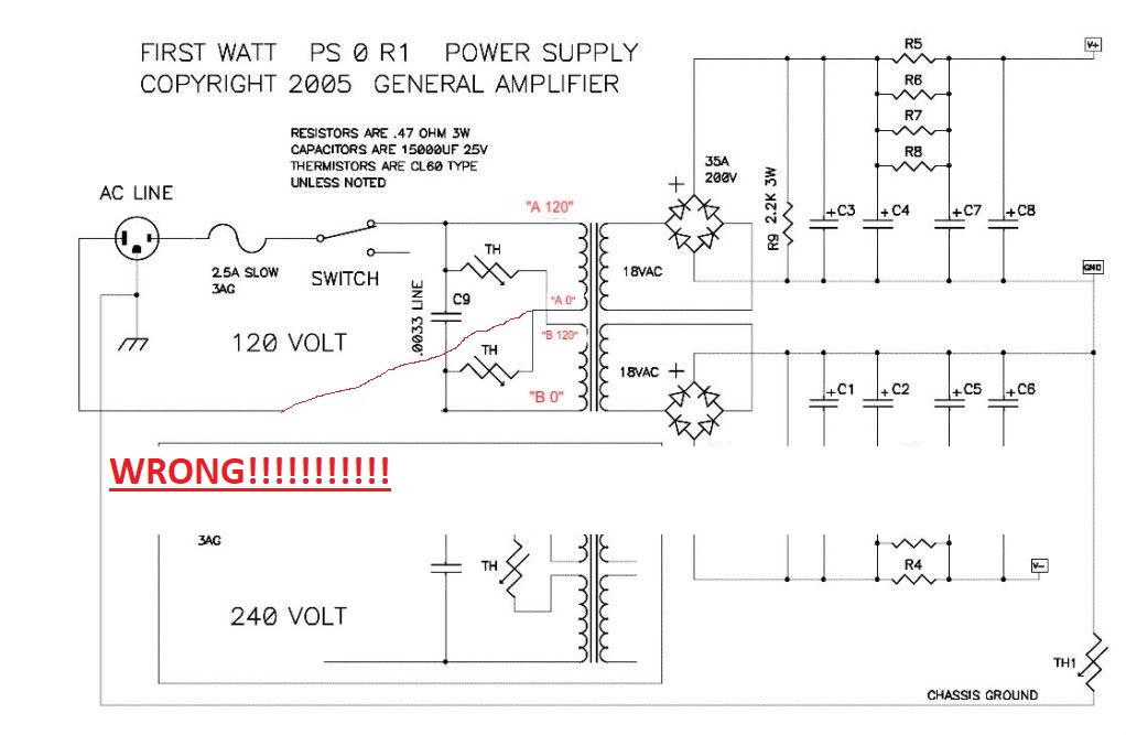

I powered up with a VARIAC with a 5A fuse and slowly raised voltage from 1 to 5 to 20 and up to 120. Everything worked fine. No smoke. LEDs got brighter as I increased the voltage. All readings were as expected.
All safety precautions were taken.
I should have mentioned the secondaries were also paired up before I tested the power.
So I had:
LIVE ==> RED A
NEUTRAL ==> BLACK A
...and everything went fine.
I just changed the setup to how you suggest which is the same as the image supplied by AllInMyHead:
LIVE ==> RED A
NEUTRAL ==> BLACK B
...and the output was the same as my initial wiring.
Your connection of live to Red A and neutral to Black A was definitely incorrect. You got lucky when you powered it up and nothing catastrophic happened.
You should not power up a circuit when you know that it is not correctly wired.

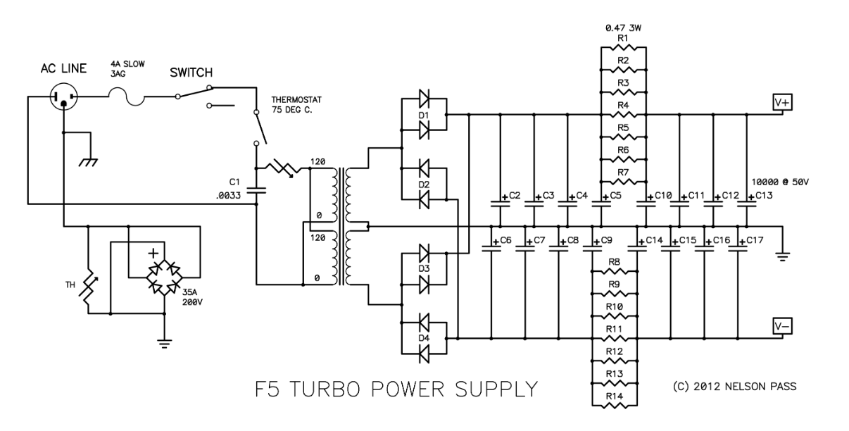

ok. I think I see where the confusion is coming from. I'm looking at the PSU from the F5T article by Nelson Pass.
You can see that the two primary blacks are connected to C1. But there is no thermistor. In 6L6 build guide there is which is the same as the F5 as you point out.
That's what I missed.

I'm not sure I got lucky though. Since the thermistor is an inrush current limiter, and since I did a gradual increase over a good period of time, its resistance decreased and had (essentially) the same effect as simply being a wire connecting the two blacks. And that's why my PSU worked and didn't fail when turning the power on.
If I went from 0V to 120V then there could have been a problem.
I've fixed my build now accordingly so thanks for taking the time to help me out.
