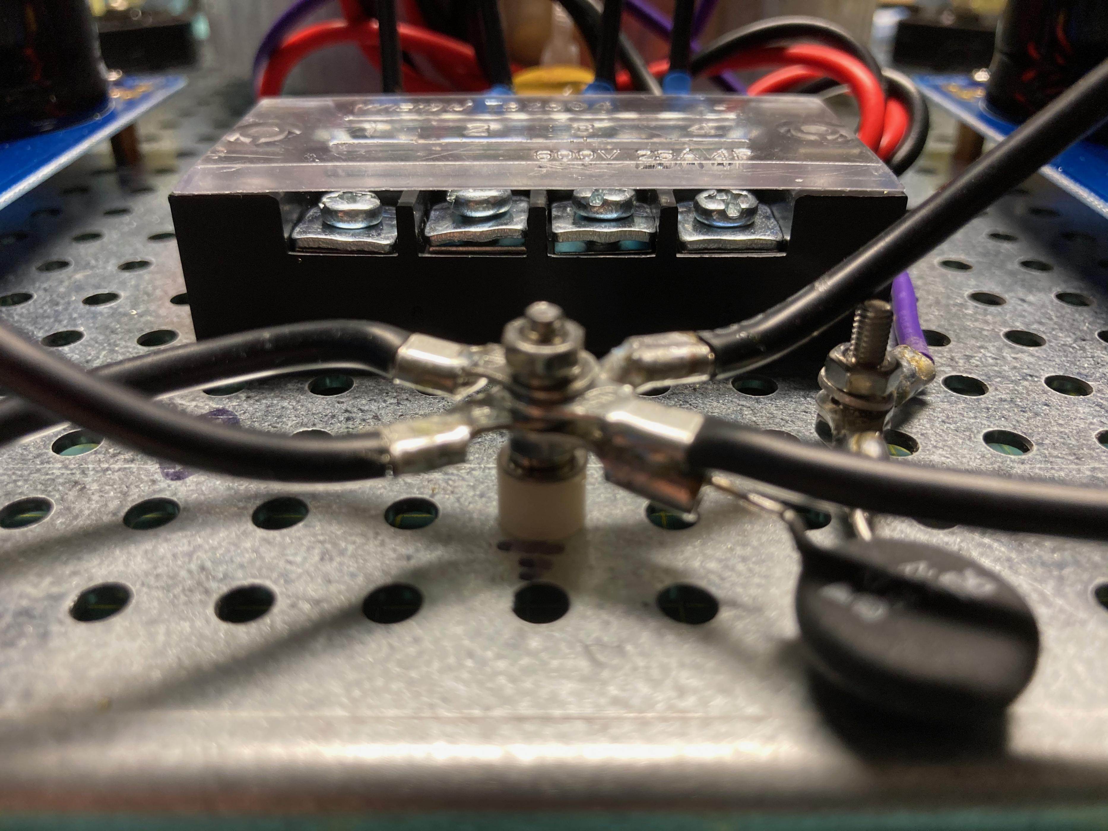

Not sure if this will help you decide or not. I am in the US, so 120VAC. Using a dual primary transformer.
One picture shows the 2 inrush limiting thermistors in series with the primary windings. I kept the leads long so that the thermistors can warm up. If you use short leads, the thermistors effectively get heat sunk to the terminal block.
There is also a safety cap across the input.
The other picture shows the isolated star ground with a thermistor connecting that to the chassis.
I split my PSU boards; one supplies +24V and the other -24V for my class A amp. They are grounded to the star ground, as are the grounds for the amp boards.
I used 16 gauge wire for the bridges, supply rails, and grounds.
