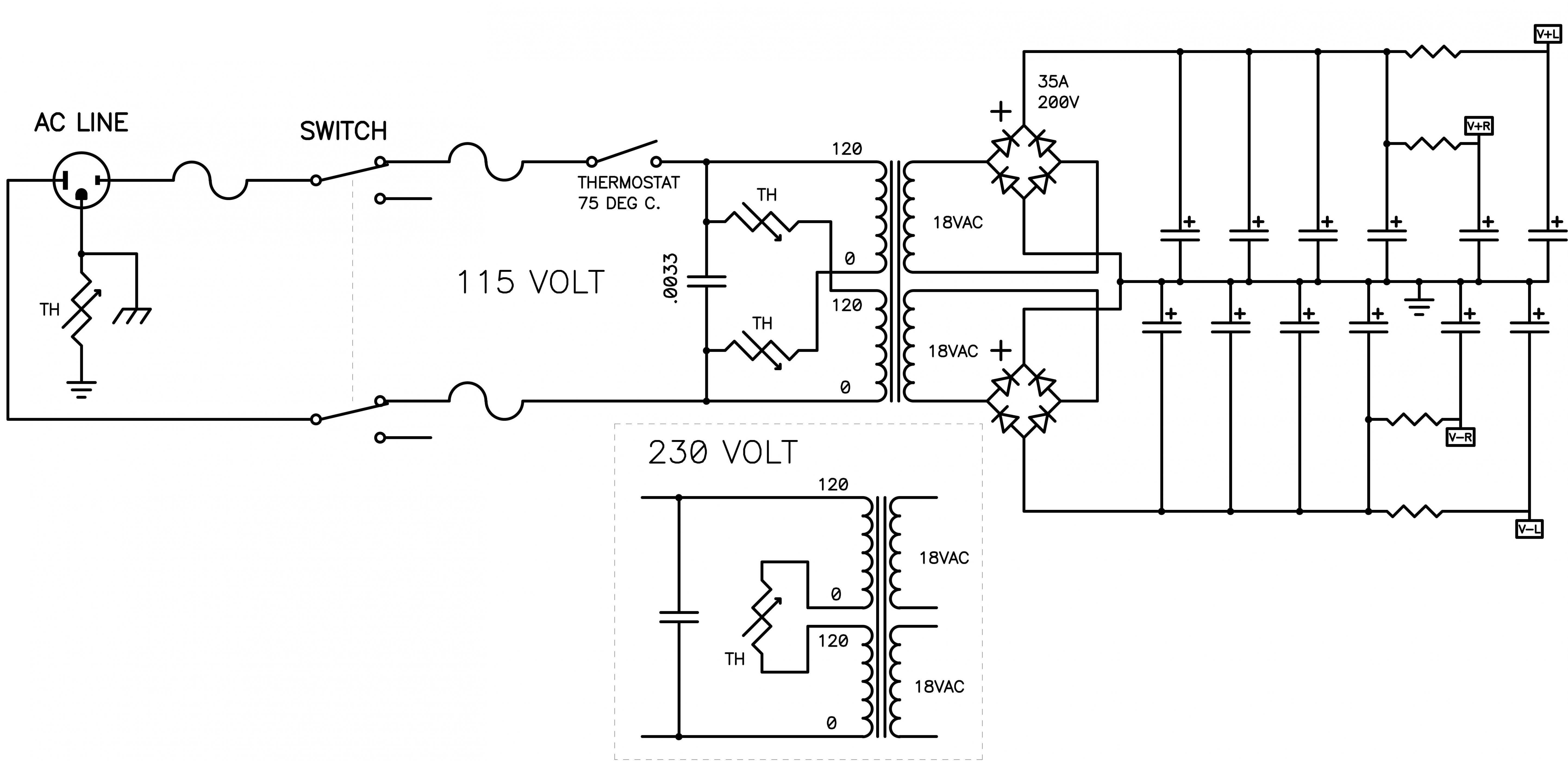

Whit that capacitor bank (88,000uF) and with that nominal voltage (50V DC = low ESR), you'd be exposing the transformer windings/bridge rectifier (not to mention the mains ON/OFF switch!!!) to a short circuit. Hence, definitely use the CL60 (a single one, for 240V AC connection). This will server the soft-start purposes; will limit the start-up current (initial charging current) by introducing the CL60's cold resistance in series with the short -> presented by a fully discharged capacitor bank.

I am using Ametherm SL15 60002 thermistors in my class A amp PSU. Since I am on 120VAC, I used 2, each one in series with one winding of a dual primary transformer. These have a cold resistance of 60 Ohms, which is high by some standards but results in a very low inrush current. They are effectively in parallel, so the inrush is only around 4 Amps.
My amp dissipates about 160 Watts at idle. These are rated at 2 Amps steady-state max. At 50% max current (around 1 Amp each), the hot resistance is rated at about 2 Ohms. I am seeing a voltage drop of about 3 VAC across them. This is a little high - but I would rather trade off low stress on the transformer, rectifiers, and caps for a little loss of regulation. Since this is a class A amp, there is not a lot of fluctuation in the load requirements. If you are building a high power A/B amp, I would use a lower value thermistor.
The Ametherms get toasty warm, but they appear to have a ceramic coating, which I would prefer over epoxy. Also, you want to mount them with long leads intact so they warm up correctly. Use high-temperature insulating sleeves over the leads.
You need to carefully consider your PSU load and look at the datasheets before choosing a particular thermistor, but these are working fine for me.

I'm using SL15 47003 in my M2X on 230VAC. Works fine for me too. A few volts drop across it too. https://www.ametherm.com/datasheetspdf/SL1547003.pdf

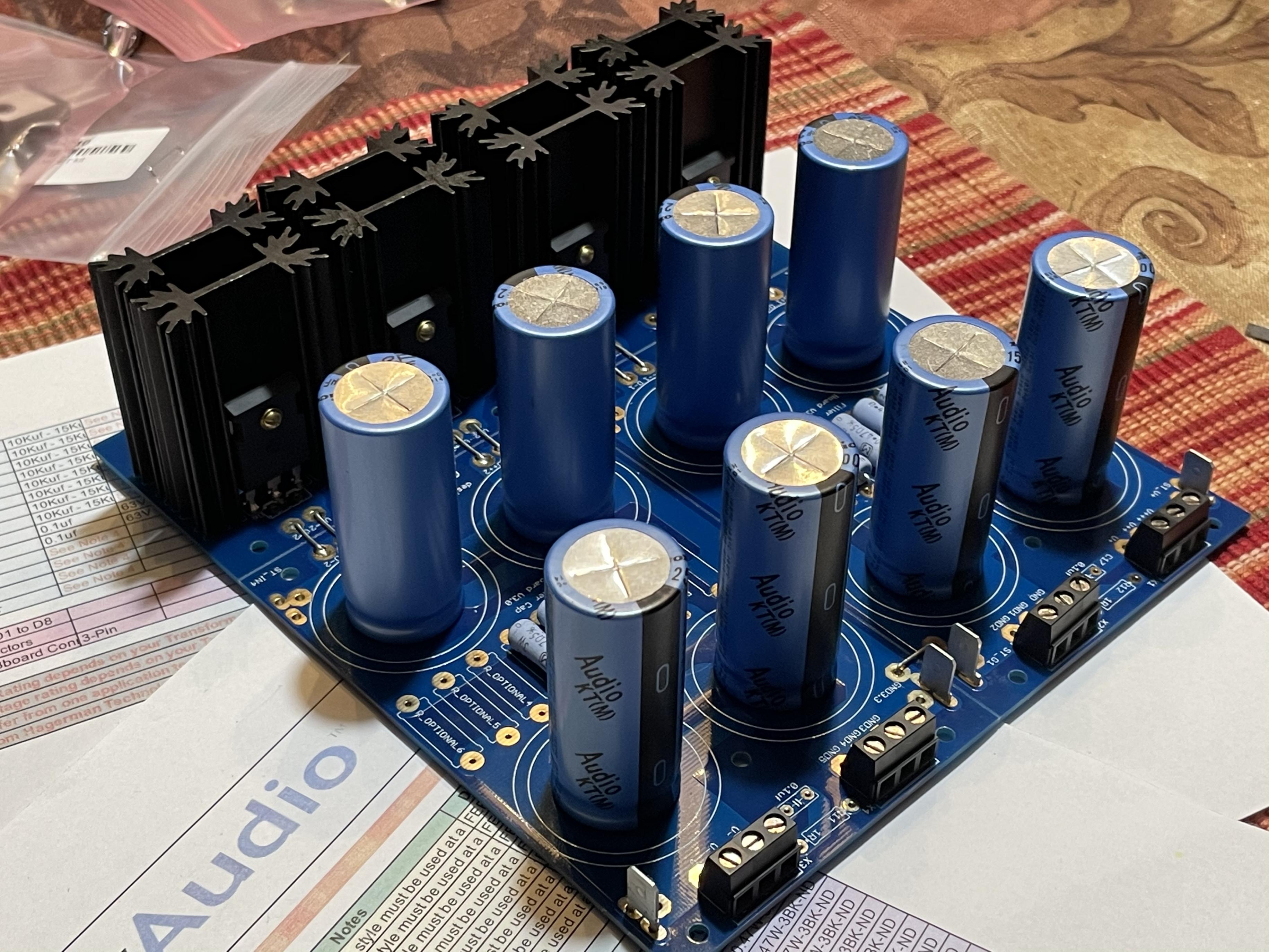

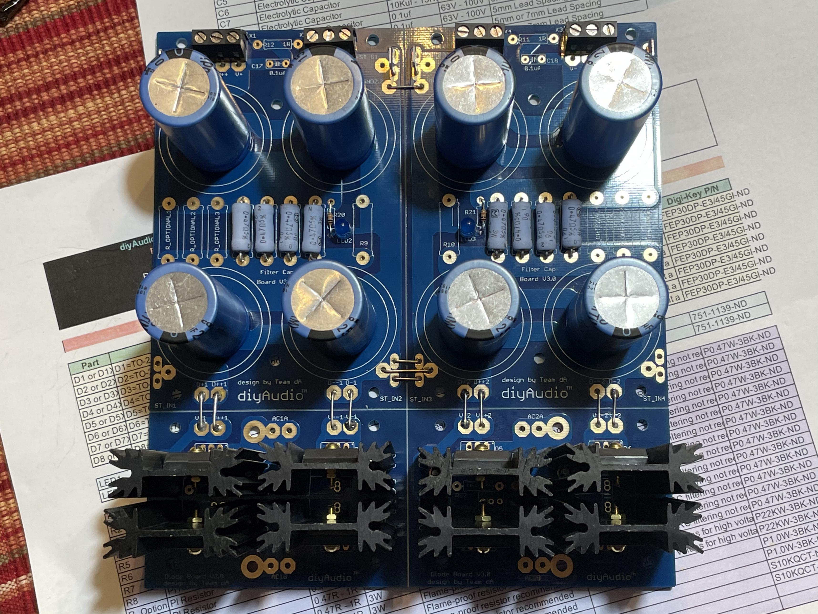

I'm building this PSU for an F4 build. Couple of questions:
1) What is the purpose of the 6 optional .47R resistors. Can I assume of I'm not using them I should install a jumper for each?
2) What should the value of the R9 & R10 bleeder resistors be? I'm using a 500VA 115 x 20V PT.
3) I bought the hardware kit for the 4U deluxe cabinet. Does it come with the hardware to mount the diode to the heatsinks on the PSU?
Thanks!!

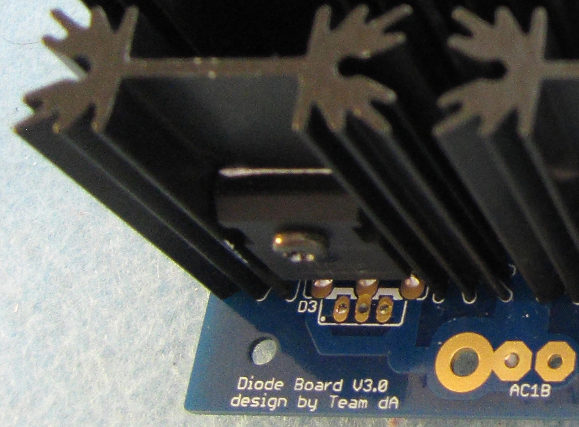

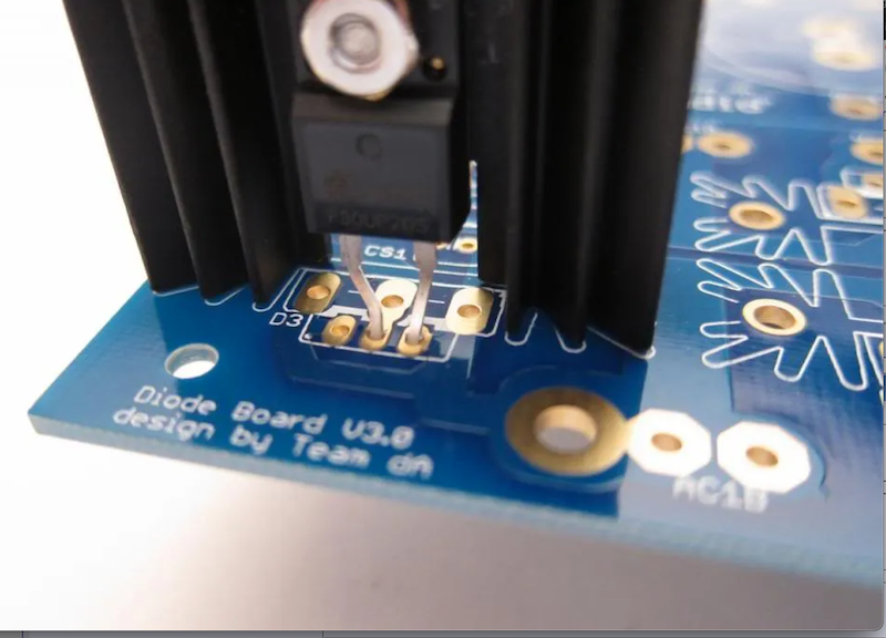

OK, one more question. I'm mounting the heatsinks and diodes. I ordered the part number on the BoM, and that's what I was sent, but they have 3 legs and the one shown in the build has 2.

1. the power supply is CRC, where the R is used to reduce the ripple. If you install the links in parallel with the resistors, the power supply would become just a single bank of capacitors. So, NO - do not install the links.
2. They can be anything between 4.7K and up.... I used 6.8K because that's what I had close at hand. Even 10K will do....
3. It does not. You need fairly short screws here... because they may hit each other when you mount everything on the PCB
4. Use the dual diodes as specified in BOM. Ignore the photo that shows a single diode mounting option. See the photo I attached.
