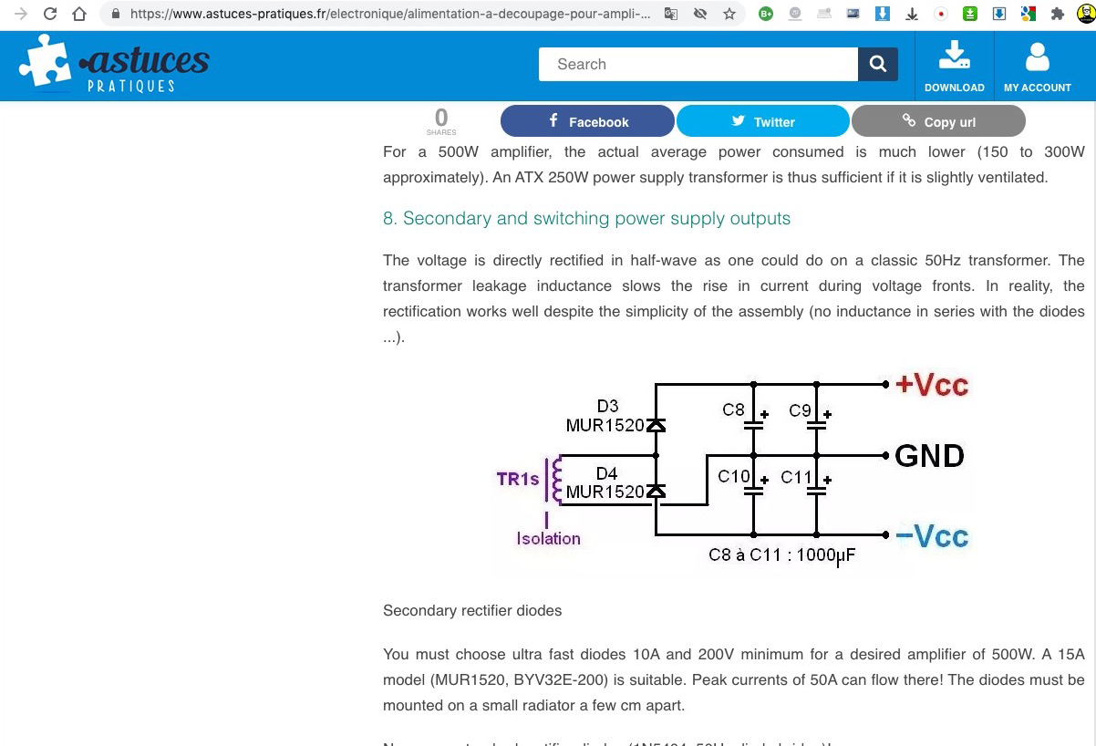

@Drdorkmeister, yes that is very common. The famous "Objective 2 Headphone Amplifier" (sometimes called O2 HPA) does that very thing. It's called Two Half-Wave Rectifiers and it has twice the ripple voltage of a Full Wave Rectifier, for the same amount of filter capacitance. Why? Because the filter capacitor is re-charged twice as often with a FWR as with a HWR.
I used this Two Half-Wave Rectifiers circuit in my Azul headphone amp, and also in my Rojo headphone amp. I exhibited & demonstrated those HPAs at Burning Amp Festival 2019, and listeners seemed to like the sonics.
I also offer this circuit as one of the options in the VRDN power supply PCB that can be freely downloaded from this Forum.
It's a nice option because it allows you to get plus and minus DC supply voltages, from a single wall wart transformer. An AC wall transformer. So the mains voltage never enters the DIY audio equipment cabinet; only the lower voltage AC which is the transformer secondary. The size and weight of the transformer is removed from the chassis. So we can build ultra-slimline line level gear.
The Texas Instruments TLE2426 “rail splitter” is a neat IC.
It’s intent is to make a virtual ground in the middle of a single DC supply, whereas you can do it natively with a single AC winding... as well as get more voltage (DC) at the output because of the way AC and DC volts are measured.
