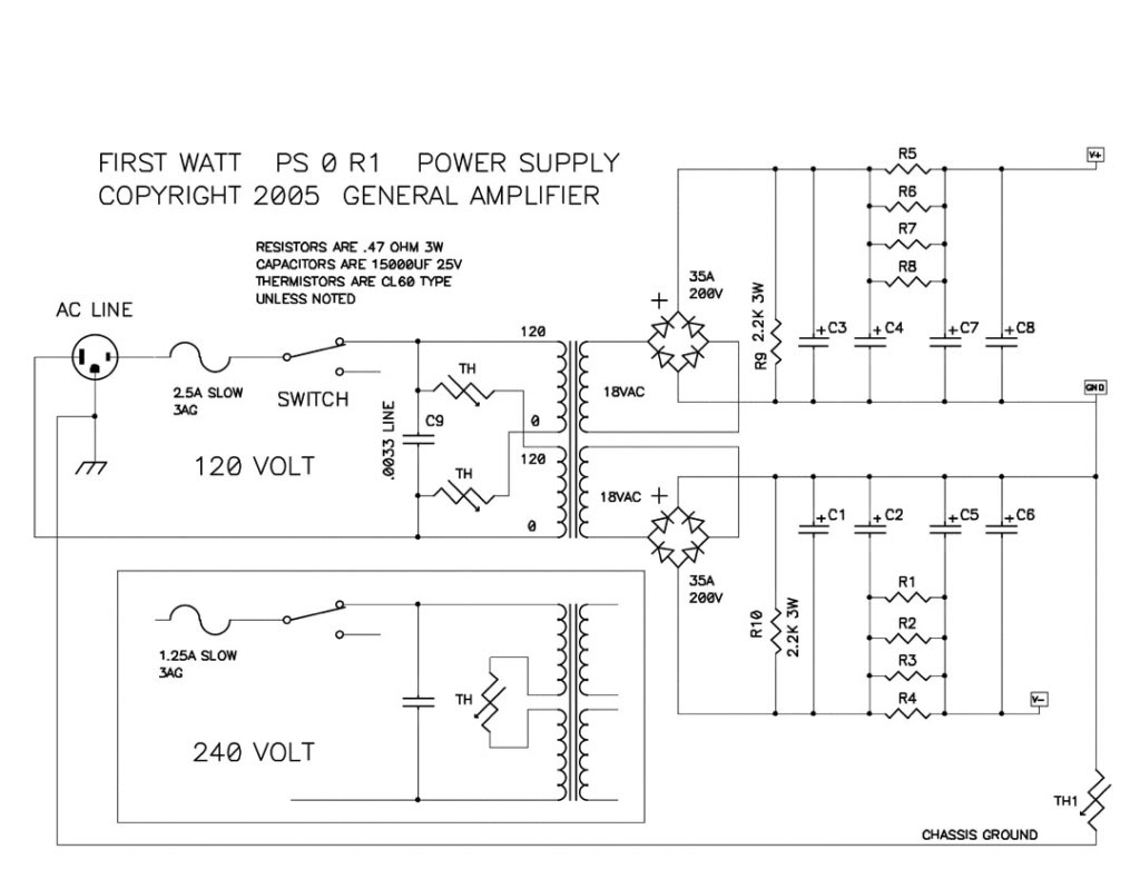

In 240v mains powered supply, should/can I use the safety cap still, and where to mount it? Across primaries?
Nelson omitted that cap from the 240v supplies as far as I can tell, but I might have gotten it wrong. If he did omit, it is of course for a reason. Such as short circuit or fire. My BA allready burned once. Best not repeat.
Andreas
No problem with 240V, Andy. The same capacitor is there. See the schematics attached.
You cannot use just any capacitor on the power line, it has to be X1 or Y1 rated (fail-safe, safety capacitor, for power line usage). Like this one, for example:
https://eu.mouser.com/ProductDetail/81-DE2E3KY332MN2AM1F/
It's 250V rated. You can search for higher voltage rating if you would like to have even higher margin (but not necessary).

What anout R9? Can i put that in too on the stores uniPSU?
And on the BA-2 supply (I use the BA-2 output stage), there av 10uf film caps across the supply lines. I have omitted that, thinking the psu dont accomodate them. Can I put those in too? Just solder on to the bord across supplies? I do use the 0,1 uf output snubber cap, but guess The 10uf doesnt replace that, or does it?
Andreas
Andy, if you talk about the R9 and R10 on the PSU board, then these are called bleeder resistors - they are used to discharge the big PSU capacitors after you switch off the power and have no load connected to the PSU. Without these bleeders, the charge would stay in the capacitors and it would be very danegerous to touch the circuit even when the power is off (that's also why there are LEDs on the board - to show you that the circuit still has active electricity while the LEDs are glowing). So, consider R9 and R10 as a must have!
These resistors have to be at least 3W rated and can be anything from 4.7K to 22K according to the BOM. But I used 2.4K in my PSU. The smaller the resistor, the quicker the capacitors will discharge (it can take a few minutes with the higher values). Perhaps I went too low and perhaps I am loosing a bit too much power on this bleeder resistor during the normal operation. Make your own choice 🙂

Everything is working as expected with the only issue: when turned off, one PSU channel (V+) bleeds quite fast, in ~30 s, but all LEDs in other (V-) stays on much longer, for about 2 minutes. What could be the issue? Voltages on PSU outputs are OK, stable. Transformer 400VA, caps EPCOS/TDK 35VDC 18000uF, R9-R10 22K OHM 3W.

@mcaronas - are you sure your R9 and R10 are of the same denominations? Perhaps you mistakengly put 2K2 instead of 22K on one of the channels? Also, 22K is on a maximum side (longest discharge time), so I suppose your V- side could be as you planned it and the V+ side could have lover bleeding resistance. I usually go with 4K7 or 6K8 with these, and the PSU schematics actualy states 2K2 (though the BOM recommendations are from 4K7 to 22K). Not that it matters much.
Also, is any load connected to both PSU sides? Without a load it takes longer to discharge the capasitors.

Blubugeye - although R filtering is helpful and should be used in these projects, it is also lossy. For a standard configuration firstwatt design the (4) 0.47ohm resistors are effectively a 0.12ohm 12W resistor, and you could use the extra slots to, for instance, use a larger quantity of bigger-value resistors to make the 0.12ohms.
As voltages and currents go up, you might need to do this in general, as shown in the F5T PSU.
More filtering (more resistance) works a tiny teeny bit better, but this is a case where more is not actually better, as you’ll lose power because your rail voltage will decrease, and the rule of diminishing returns kicks in very quickly.
So, use (4) 0.47R 3W resistors Per rail as shown on the schematic.
