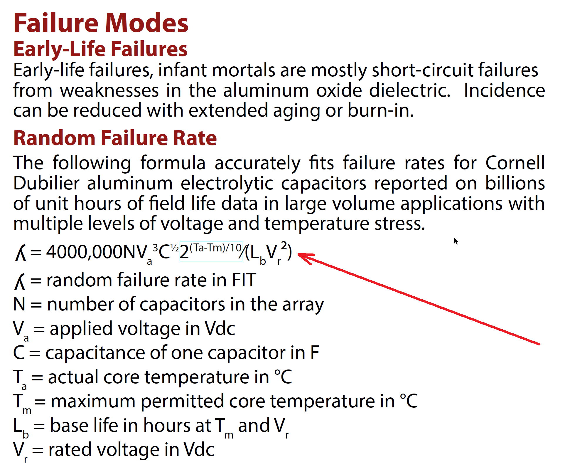

Cornell Dubilier, a manufacturer of electrolytic capacitors, published an Application Guide which I have attached below. Pages 13-14 discuss lifetime ("rate of random failures"). Notice that failure rate is exponentially dependent on temperature (light blue box).

That application guide's tests are interesting, and reconditioning high DCL units. So, using a cap rated higher (well) than expected voltage more than makes sense from an endurance / lifespan perspective. I was looking at caps with very high hour rating, but that seems like spending more money than necessary, at least in this case.

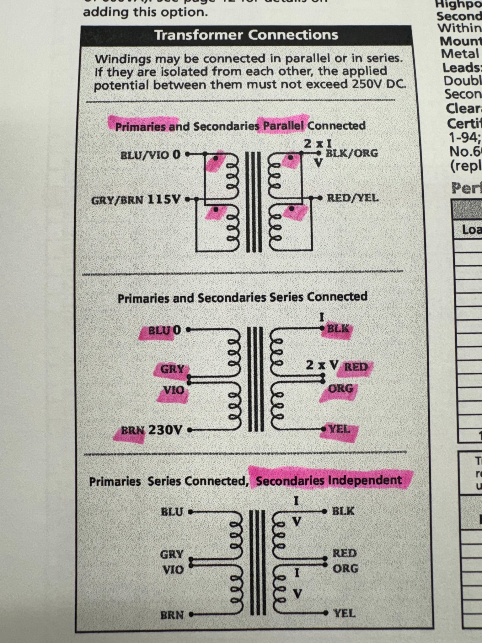

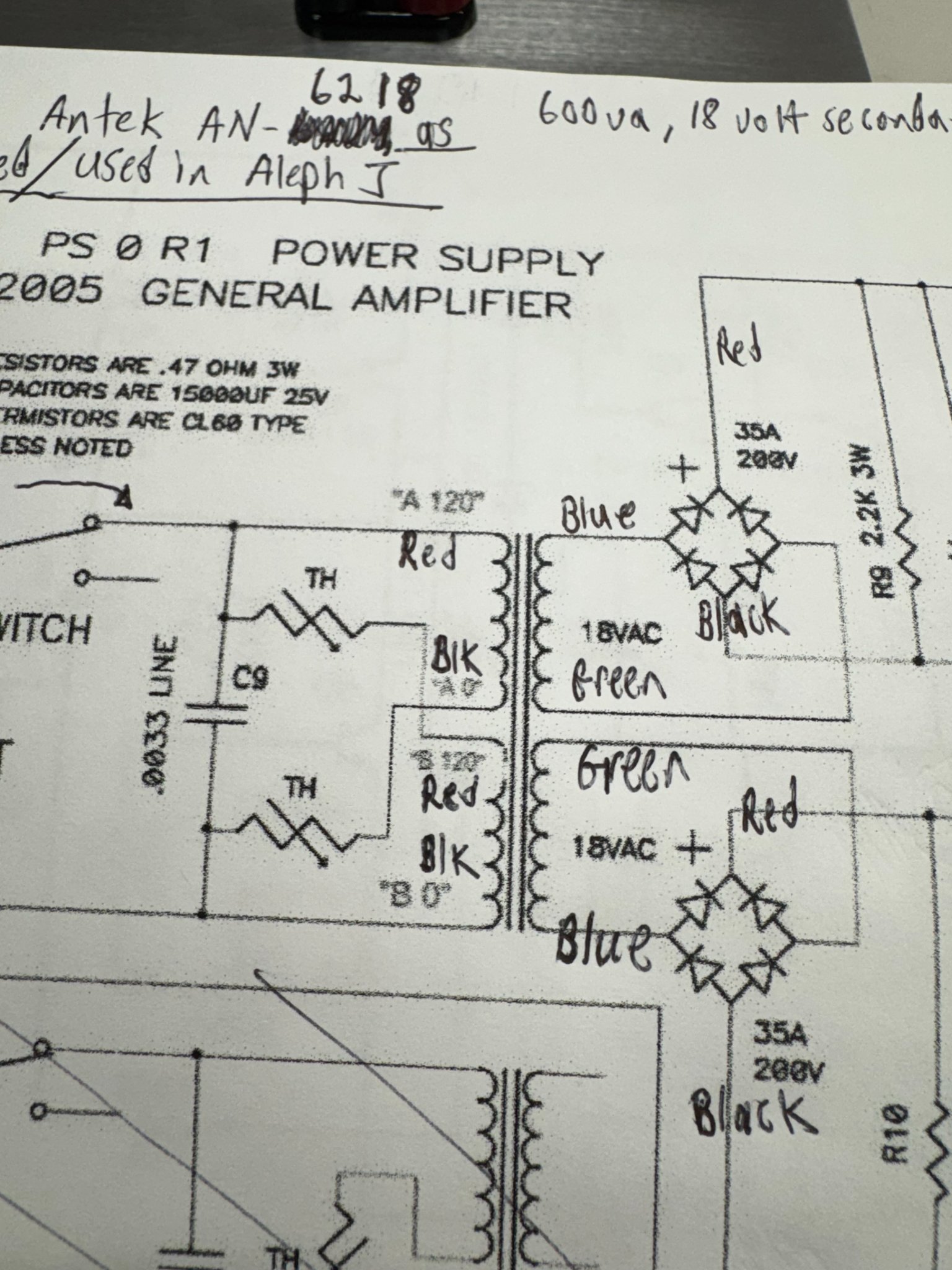

I'm in the process of building Nelson's AB100 amp, using the diyAudio version 3 power supply board and an Avel-Lindberg toroidal transformer with dual 115v primaries and dual 35volt secondaries (Model Y236852). I'm using ordinary 600 volt, 35 amp bridge diodes. I expect to get somewhere around 47 volts DC output from the supply, so I'm using 8 x 15,000 microfarad caps, rated at 63 volts and 105 C. [ BTW, I've built the standard CRC filtered, 24 volt DC, version of this supply 3 times before (for my F5, my F6, and my Aleph J), using Antek's 6218 transformer and lower DC voltage-rated caps. This PS has worked great in each case. And 6L6's excellent build guides have made building and using this supply easy and fun.]

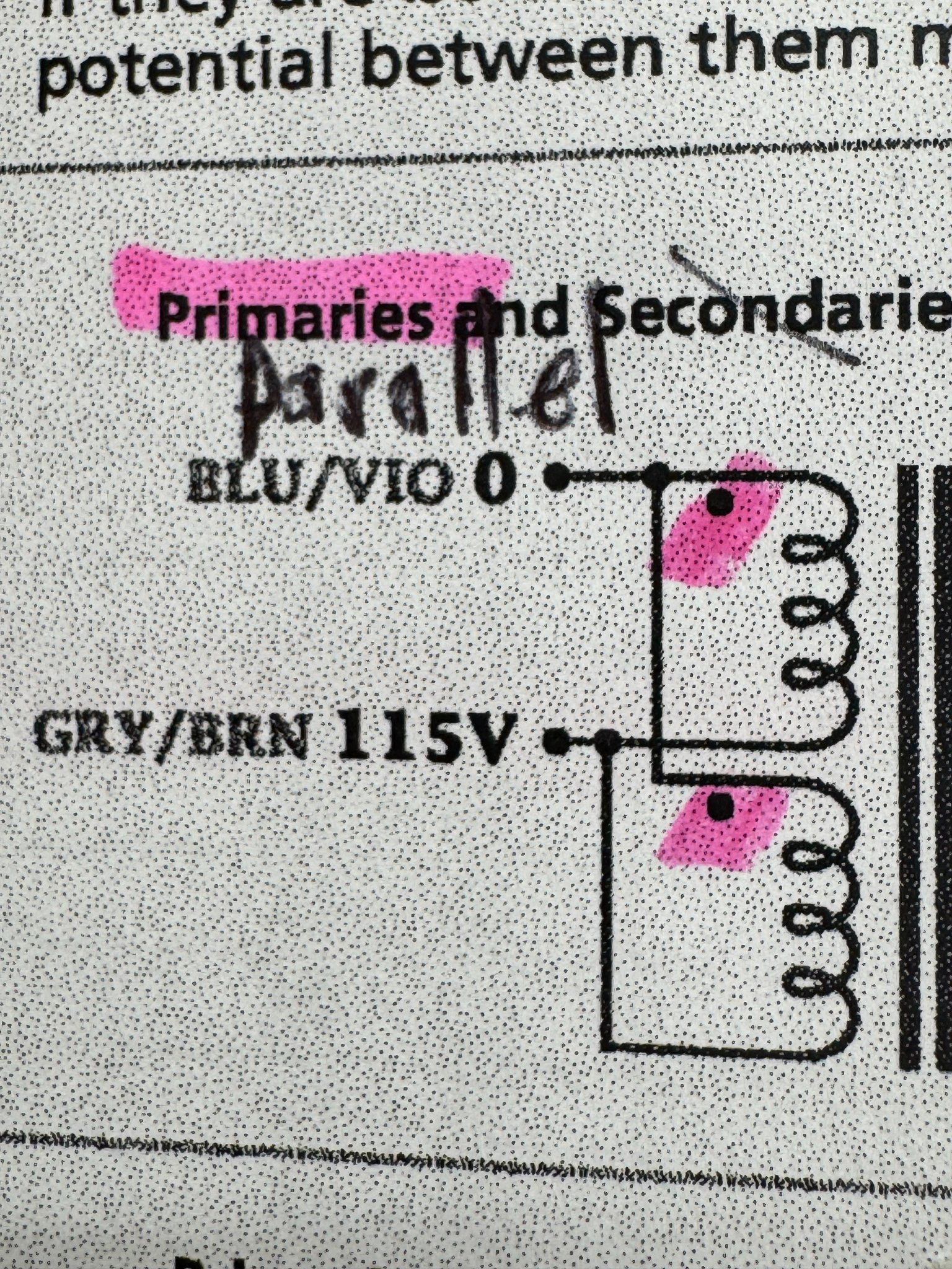

My question: When I look at the schematic for the new Avel Lindberg transformer, I see that the "Hot" and "Neutral" designations for the two primaries in parallel are reversed from those printed in red ink ("A 120" and "A 0", and "B 120" and "B 0") by 6L6 on his annotated schematic for the diyAudio supply, using what I assume is an Antek transformer. On the Avel Linderg unit, a "0" designation appears at the top of the schematic for each paralleled primary winding, and "115V" appears at the bottom of each. (see photo below). What should I do, if anything, to accommodate this difference? Should I reverse the "hot" and "neutral" AC input leads that attach to posts #3 and #2, respectively, on the Terminal strip? (see upside down photo from 6L6 below). (BTW, There is no earth ground connection for this transformer, if that is relevant.)
[If I can get past this issue, I have another question related to phase relationships between the secondary windings, but since these windings are independent, as used by this bipolar P.S., and each feed an independent bridge diode, maybe this is irrelevant too. I've never worried about it before because Antek does not show phase dots on their schematic. Ignorance=bliss?]

Answering your question, the important bit is that the primaries are not inside-out in relationship to each other. If they are wired inside-out, you'll almost be blowing fuses on start.
Do you need to reverse the Live and Neutral at the terminals? Looking around its not immediately obvious if there's a standard to the lead winding getting hot or neutral, you can find it drawn both ways, but perhaps it's more common with hot to the trail winding?
When in doubt, connect as shown on the manufacturer's data. It's easy enough.
Antek actually does show phase, as it's implied in the schematic, but yes, they are sans-dots.
