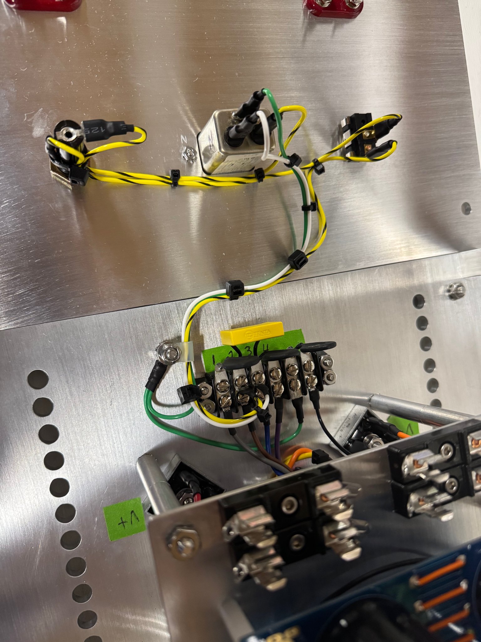

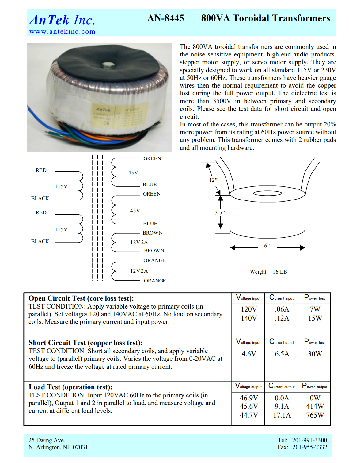

Thank you 6L6 for the very fast reply! I don't understand what you mean by wiring the primaries "inside -out" (other than that it sounds like "double-plus ungood", as some sage once said).
Sorry to be a bit of a dim bulb about this, but I guess what I am asking is: if I simply reverse the hot and neutral input leads to terminal posts #2 and #3 will that work to "connect as shown on the manufacturer's data" sheet (which is what photo image 8041 above shows), without creating other problems, such as defeating the surge protection of the thermistors, or what have you. Thank you very much for your patience and your help.
Yes, if you reverse your live and neutral connections to the terminal post, the transformer will connect as shown on the datasheet. Everything else will work as normal.

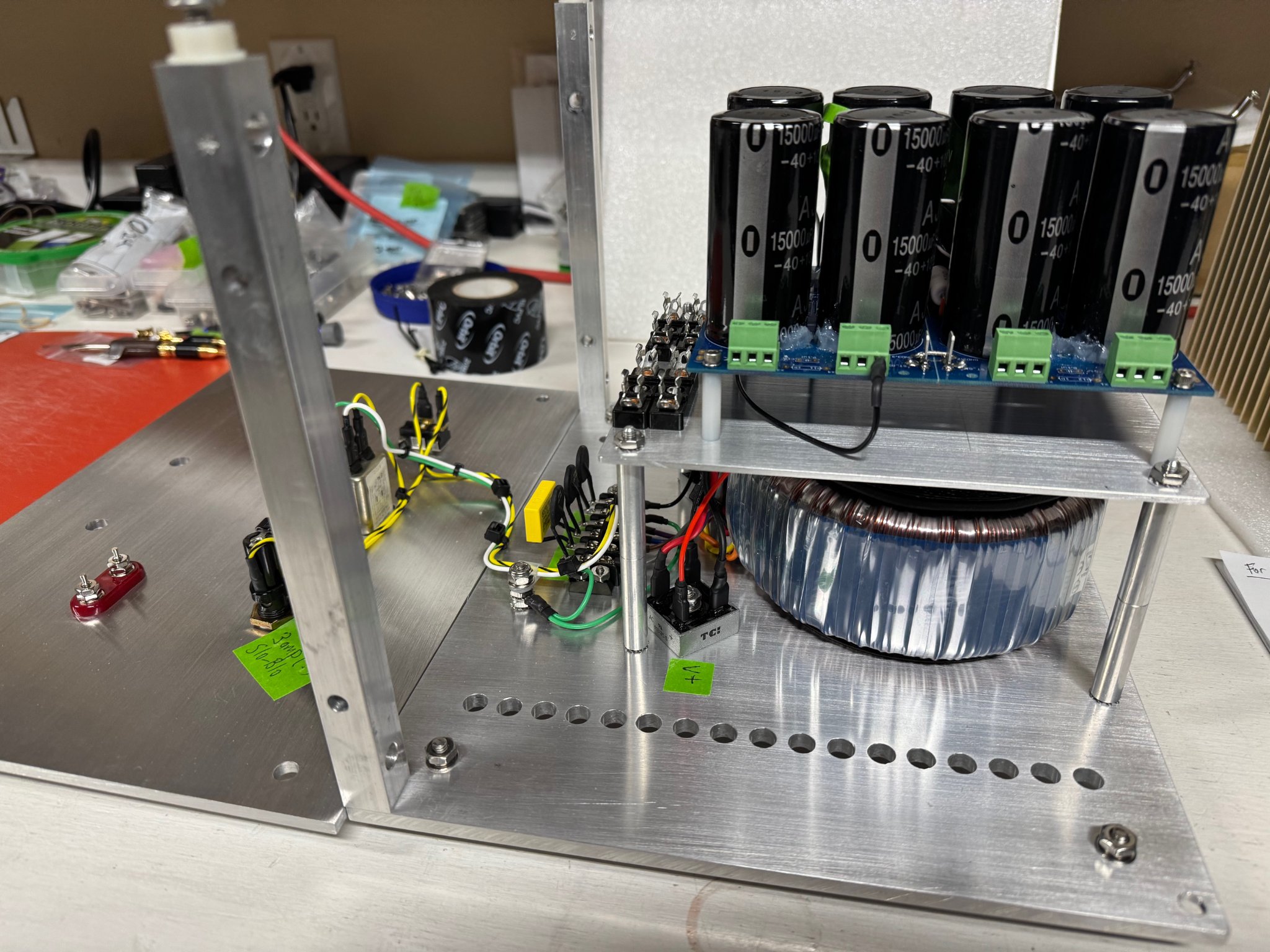

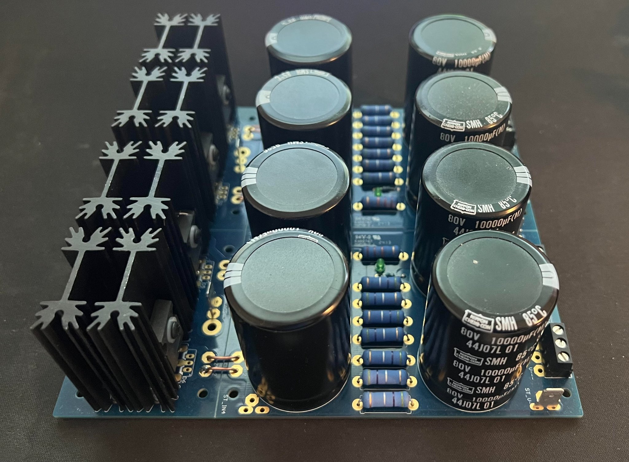

Hi 6L6: I've completed the wiring on my power supply for my Pass AB100, and was ready to set things up with my Variac to test the supply. But I ran across a few threads yesterday concerning the use of the CL-60 thermistors in series with transformer primaries in FW amps, which got me thinking/worrying. In building my F5, my F6, and my Aleph J, I used these devices with transformers rated for 625 VA and a standard CRC filtered PS build with 8 X 15,000 microfarads, yielding + - 24 vdc, and everything worked great (although I am surprised to learn now that these devices run so hot in normal operation! I never measured them in previous builds).
This time I'm again using a dual-primary 625 VA transformer but the secondaries are rated at 35 vac, and my supply may yield 47 vdc. Caps are still 8 X 15K (63 v), but I have left off the CRC filter resistors and installed jumpers instead, in line with comments in these forum threads which indicate somewhat less value using a CRC configuration with a class AB amp.
Do you thinks that the CL-60 devices will be adequate under these changed conditions? I saw a recommendation from Mark Johnson for an alternative device with greater joule surge rating, and possibly better long term reliability, but again that was for a FW amp with about half the DC supply voltage.

Adequate for what? Working normally? Yes, I don't see why not, as they are rated for 5A each and you have two that are effectively in parallel.

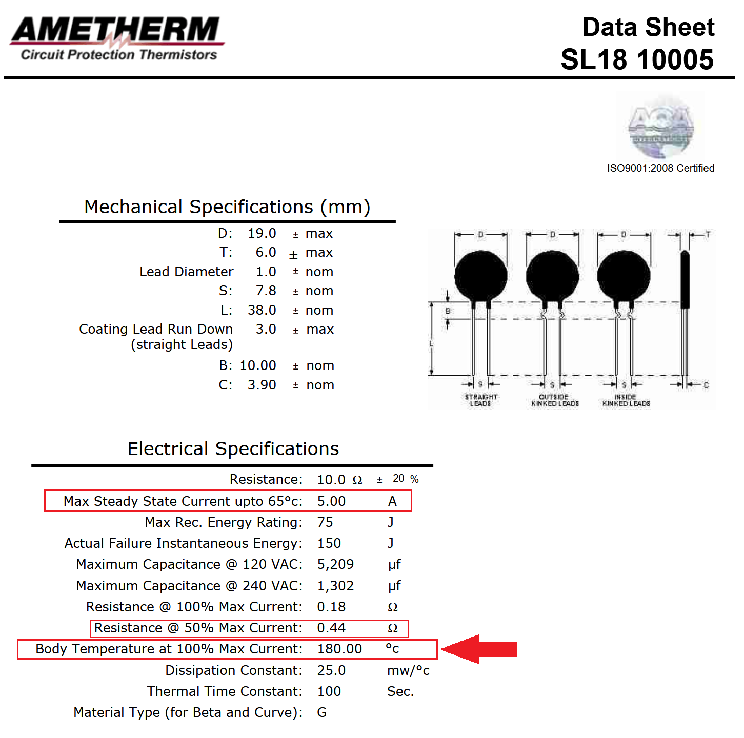

625VA / 115V RMS = maximum steady state current in transformer primary = 5.44A RMS . @6L6 is correct, sending half of that through one CL-60 and the other half of that through a second CL-60 is well below the CL-60's rating: (5.44 / 2) is well below 5.
The manufacturer's engineering datasheet for the CL-60 says that when 2.50 amperes are flowing ("50% of rated current"), the CL-60's resistance is 0.44 ohms. We can calculate the power dissipated in the CL-60 in this condition: Power = RMScurrent * RMScurrent * resistance ; 2.50 * 2.50 * 0.44 = 2.75 watts dissipated by the CL-60. No wonder the darn thing gets hot!!
Of course Amphenol has competitors who make and sell their own line of inrush current limiter discs. One such competitor is Ametherm, who makes an apparently identical twin to the CL-60. The part number of Ametherm's identical twin is SL18-10005 , and its max steady state current is 5 amperes (same as CL-60). Its resistance at room temperature with no current flowing is 10 ohms (same as CL-60). Its resistance with 50% of rated current flowing is 0.44 ohms (same as CL-60). And, happily, Ametherm actually tells you the ICL disc's body temperature when 5 amps are flowing (see below), it's One Hundred Eighty Degrees Celsius! Cowabunga, that thing is hot. I bet the Amphenol CL-60 is the same or very close, but they don't publish that number in their datasheet. I've got a Parasound power amp which includes an Inrush Current Limiter disc. Parasound installed a thermal "sock" around the disc to prevent it from destroying nearby components and burning repair technician's fingers.

Many thanks to 6L6 and Mark Johnson for clarifying things for me! Especially so quickly. I will find a 6 amp slo-blow fuse in my bin of parts, install it in the panel mount, and get my variac up on the bench for a PS test. I have the CL-60 devices installed where they will get some air. And any wires in the area (in fact, all wires in the amp except for the transformer leads) are teflon insulated so they can take a little heat.

Yeah, I was just sitting here thinking "Uh, wait a minute, if the maximum steady state current of the transformer is 5.44 amps RMS, why in the world would I choose to pick a fuse value above that? Where is the protection in that? Duh!!" And I listen to music in a small room! I'm only building the AB100 to see if it makes my power hungry Magnepans sound a little more alive. Maybe I should start with a 3 or 4 amp slo-blow and see how that works. My Aleph J is fused at 3 amp.

The other day, I set up the power supply for my AB100 with a variac and brought it up slowly, using a slo-blo 4 amp fuse in the AC fuse holder. No smoke or other drama! At about a "110v" setting on the variac, the power supply put out about 50 vdc (no load). Beyond the fact that there was no load attached, I wonder if I got a little bit of extra voltage output because I used jumpers instead of the CRC filter resistors.
The next day, I put the variac away and connected the power supply directly from a wall AC outlet, and flicked the amp AC switch on. Again, no drama, and the fuse held in this "instant on" trial. I got about 51 vdc (no load).

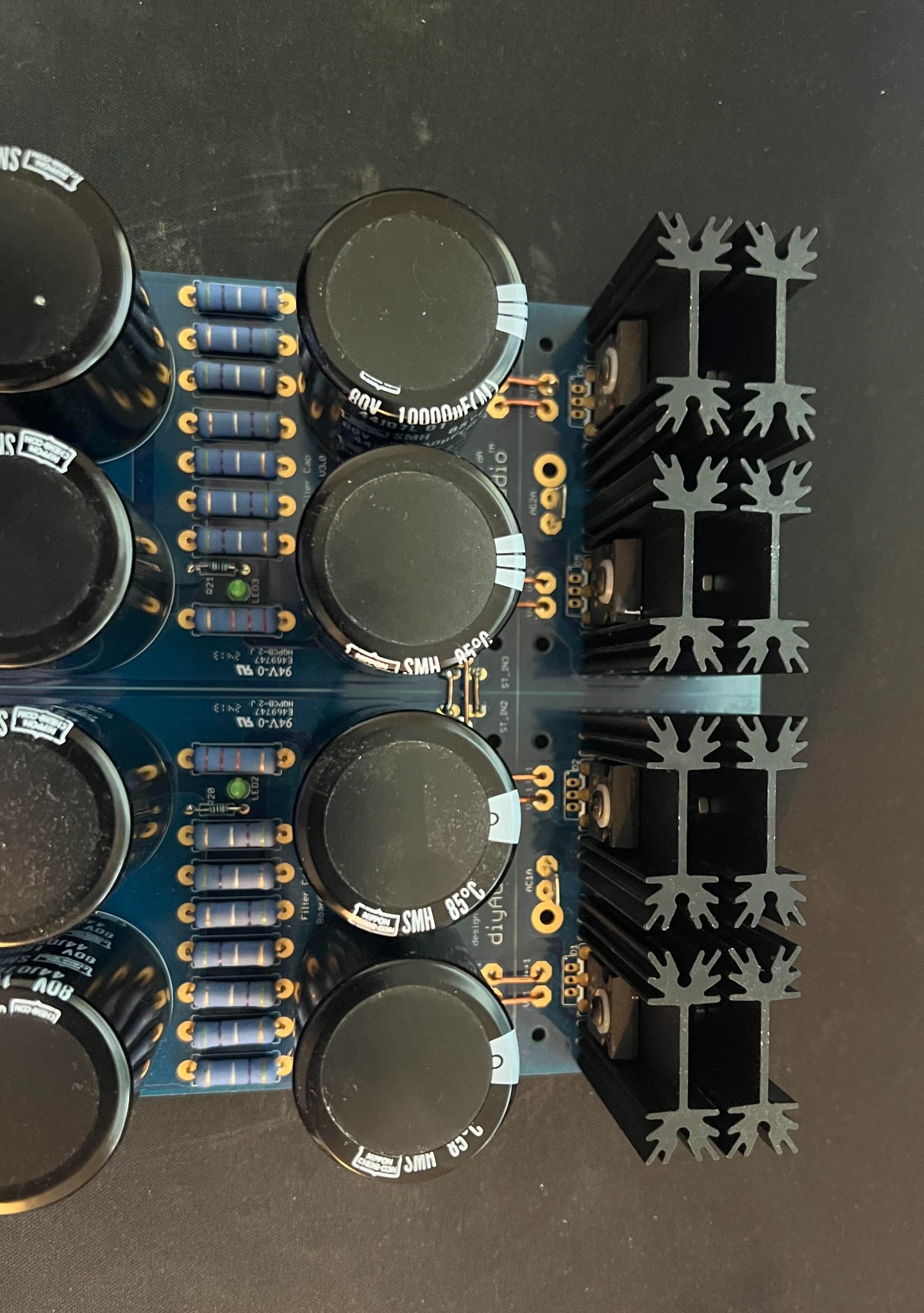

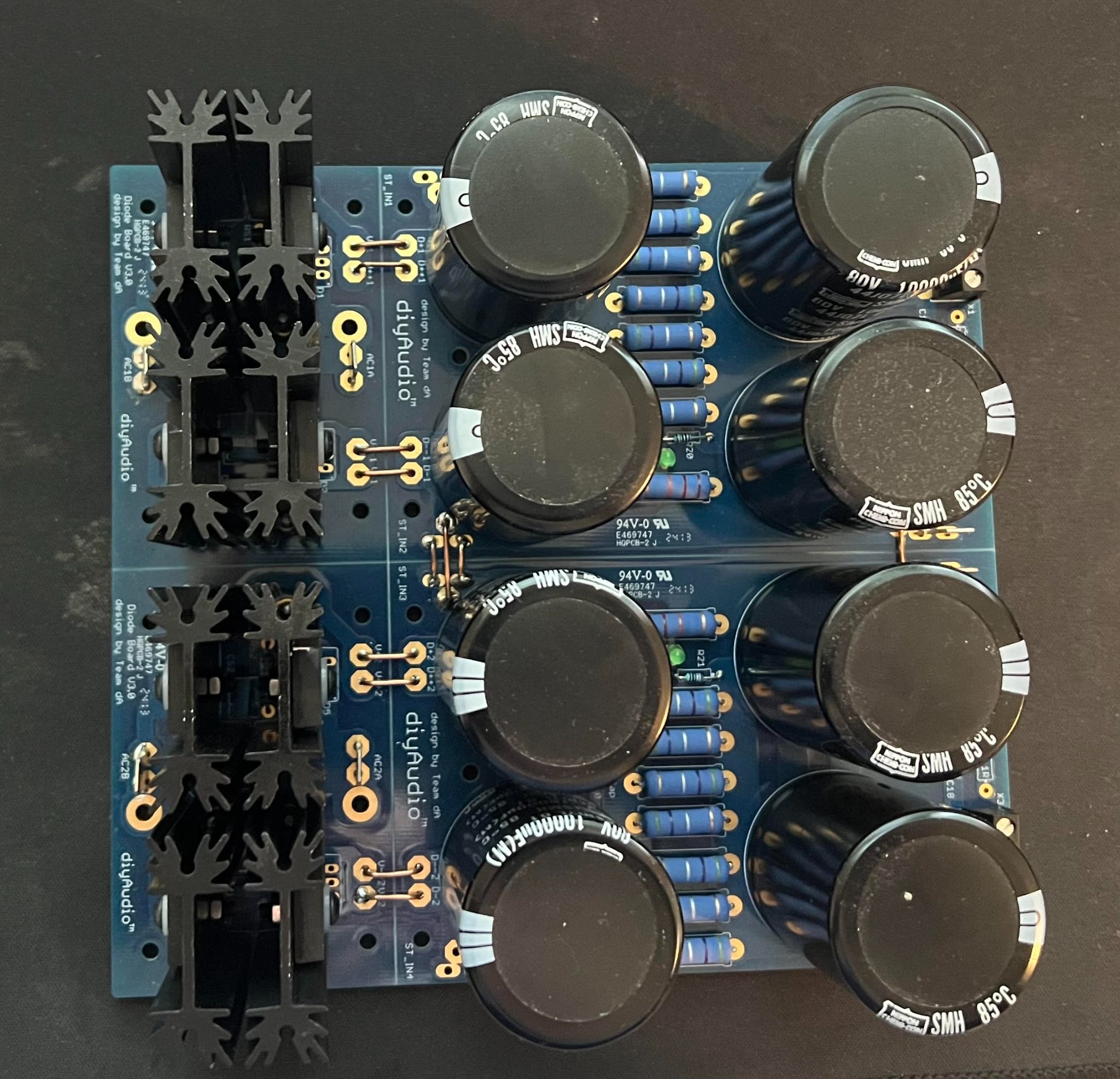

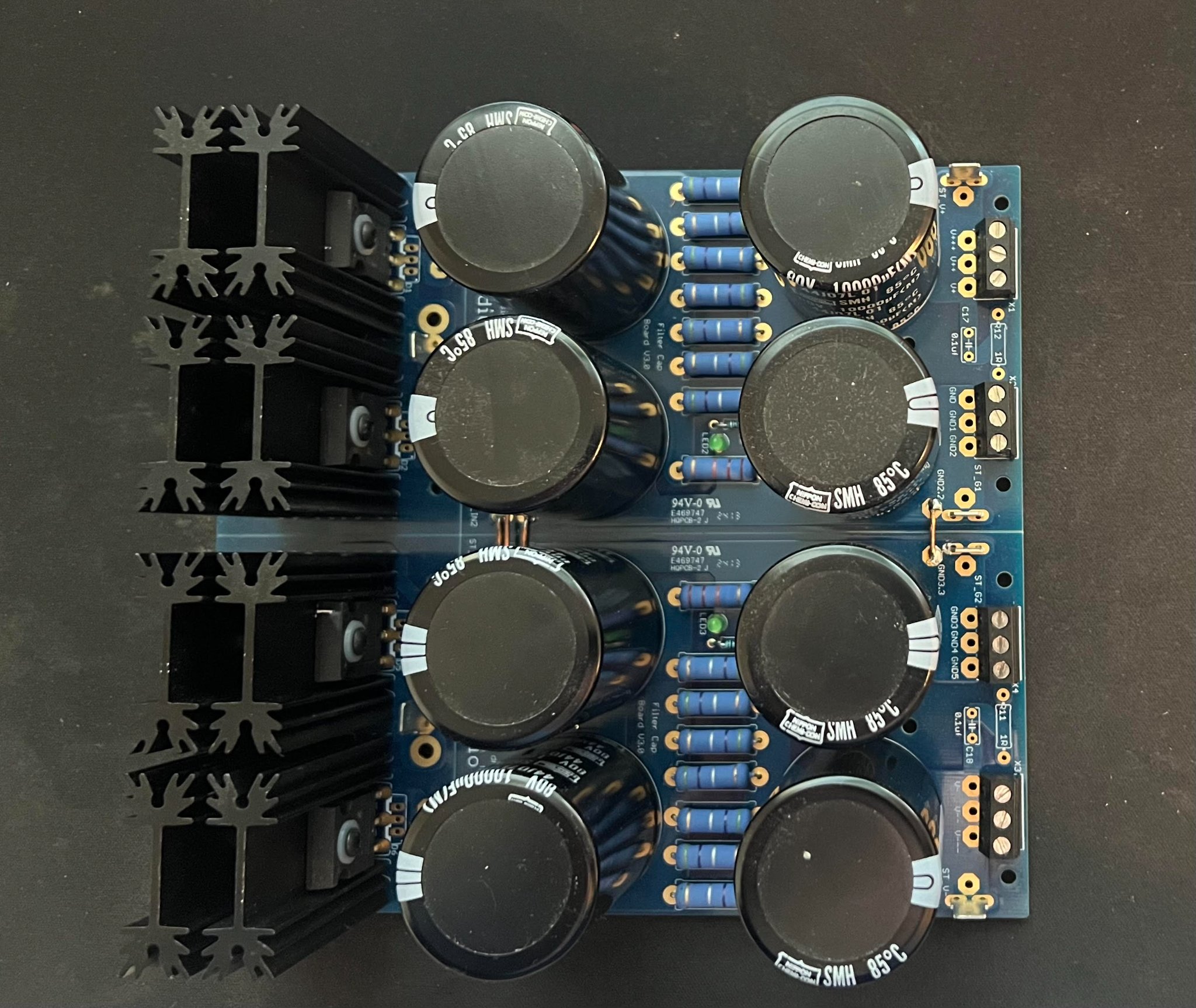

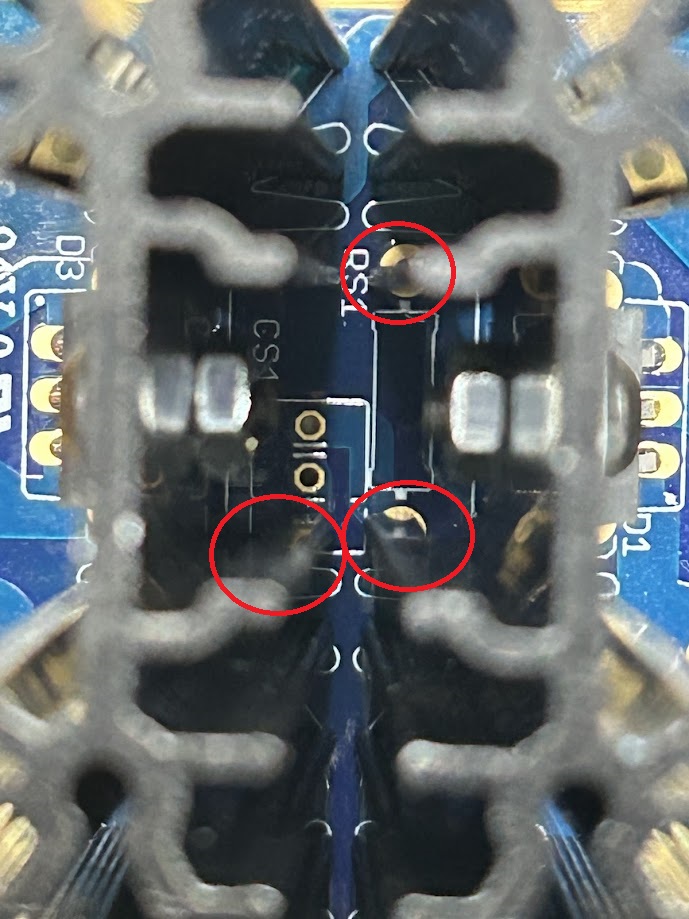

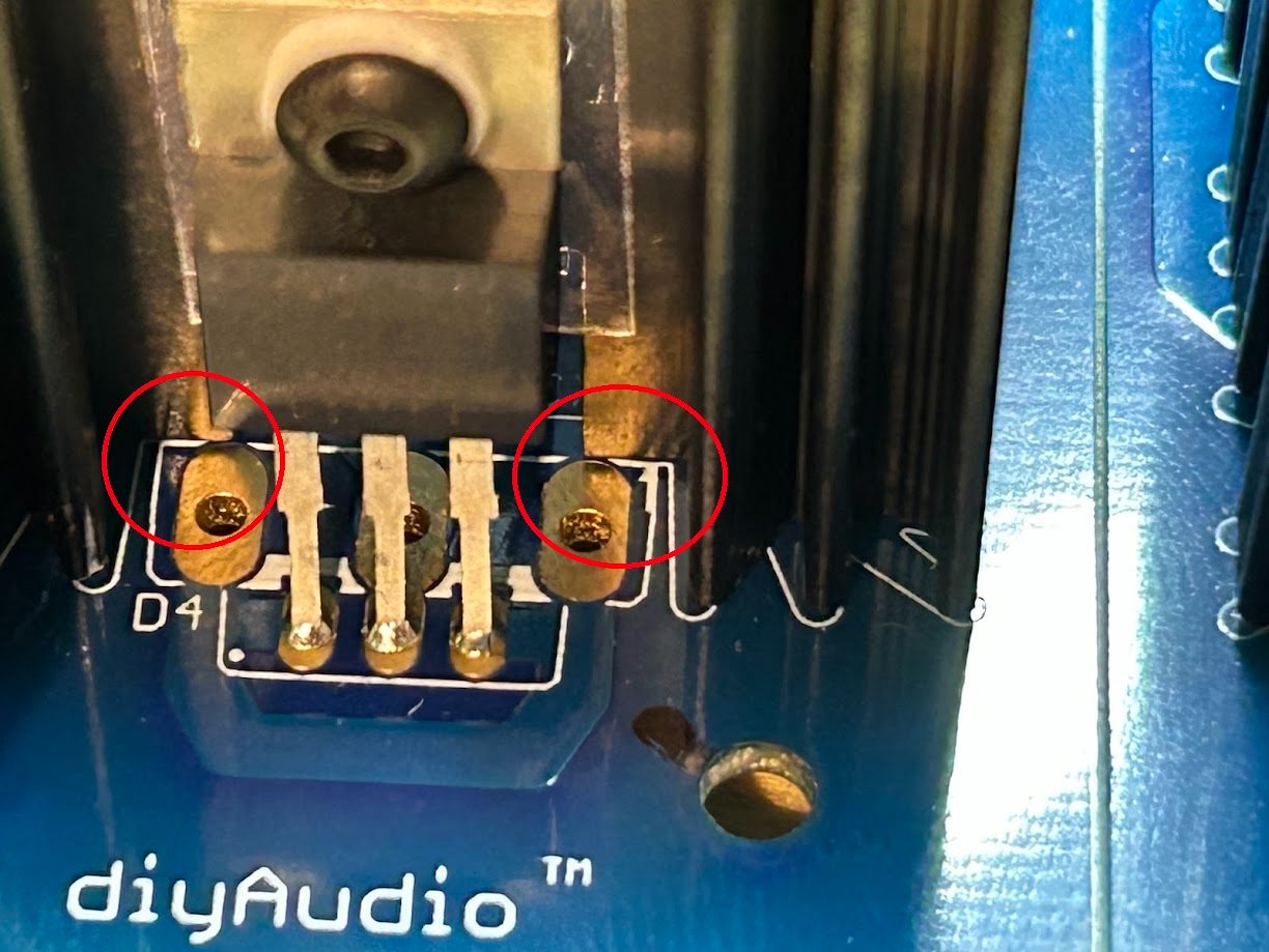

remove 2mm of metal from the heatsink using a file, apply a piece of kapton insulating tape to the heatsink, apply another piece of kapton tape to the PCB
I see that you cleverly electrically isolated the metal back of the diode, which likely is your cathode, from the heatsink. I also noticed that there are traces that connect the two outer pads of the diodes, which are likely the anodes. Shorting the two anodes through the heatsink... I can't see that being an issue, but wiser people would know with more certainty. Shorting the anodes to the cathode would likely be an issue, but your insulator solves that.
Have you done a "beep and wiggle" test to see if there is anything that may be of actual concern? Set your DMM to resistance / continuity and check. Do your best to wiggle the parts and see if anything ever makes contact to something that would cause an issue.
Again, smarter people than I should weigh in.
Thanks for the reply. As far as I know, anodized aluminum is not conducive, that could be the reason why DMM continuity test didn’t show any short circuit. I checked before I lifted it.
Now with 1.5mm air gap should be ok.
