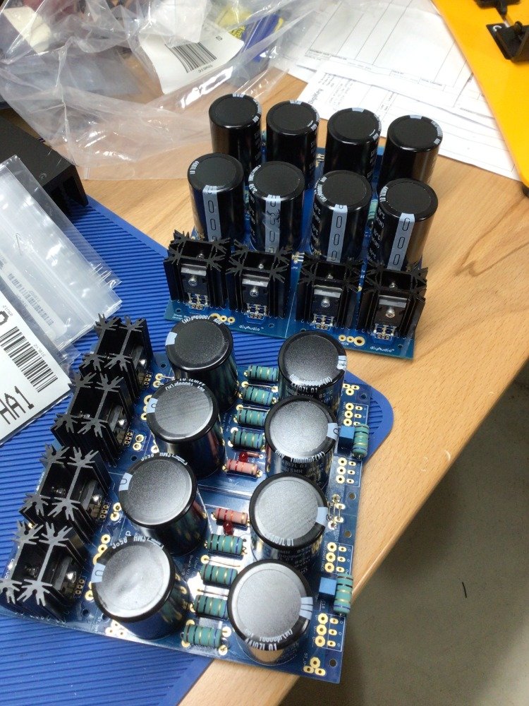

Ok guys, I'll check it out. But it's too late for this project because the power supplies are already built (see picture below). I was instructed to read Rod Elliott's treatise on power supplies. My interpretation of his advice is that for the Wolverine 80,000 uF of capacitance at 80 V per channel was more than enough, so I used eight 10,000 uF 80 V capacitors per channel (I'm building a dual power supply).
I also learned that 35 A 400 V diode bridges would be adequate. I wanted to mount the diodes on the diyaudio store PSU boards instead of using those little diode cases that mount to the chassis. There wasn't much of a difference in price between what I needed and going overkill at 60 A 600 V, so that is what I did. And yes, you have to buy heat sinks for each of them. It would have been much less expensive to buy the little diode bricks.
I did not get a good read on how effective a CRC filter is on a Class A/B amp versus a Class A amp. When I built the F4 I used eight 0.47 ohm 3 watt resistors.......which I now understand is hardly any resistance at all since they are wired in parallel. For the Wolverine I used four 1 ohm 5 watt resistors per power supply board and jumpered the optional resistor positions. I can always swap them out if necessary.
I used the standard input snubbers. I am not currently using output snubbers because I don't have a clue as to what the component values should be. I wish the diyaudio store would make the Quasimodo Bell Ringer available so I could figure it out as I am just about to buy a scope.

Looking good!
For a class-AB amplifier the R value in the CRC needs to be very low, even lower than a alass-A amp.. I'd choose something like 0.47ohm 3W resistors in all the standard and optional positions. Your (4) 1ohm resistors in the PSUs are too much R, however by jumpering the optional resistor positions you have essentially removed the resistors, (because the wires are in parallel with the resistors...) so it will not cause any issues.
Yes, the diode bridges are cheaper... but the discrete solution with heatsinks looks amazing.
Output snubber is useless, you should leave it open. However, you have stuffed the output snubber in the photos... the input snubber is the one near the diodes and is quite useful. Getting PCBs made from JLCPCB or similar is quite easy, use this as a great chance to get Quasimodo made. Or ask in the thread if anybody has a spare PCB, I bet somebody does.

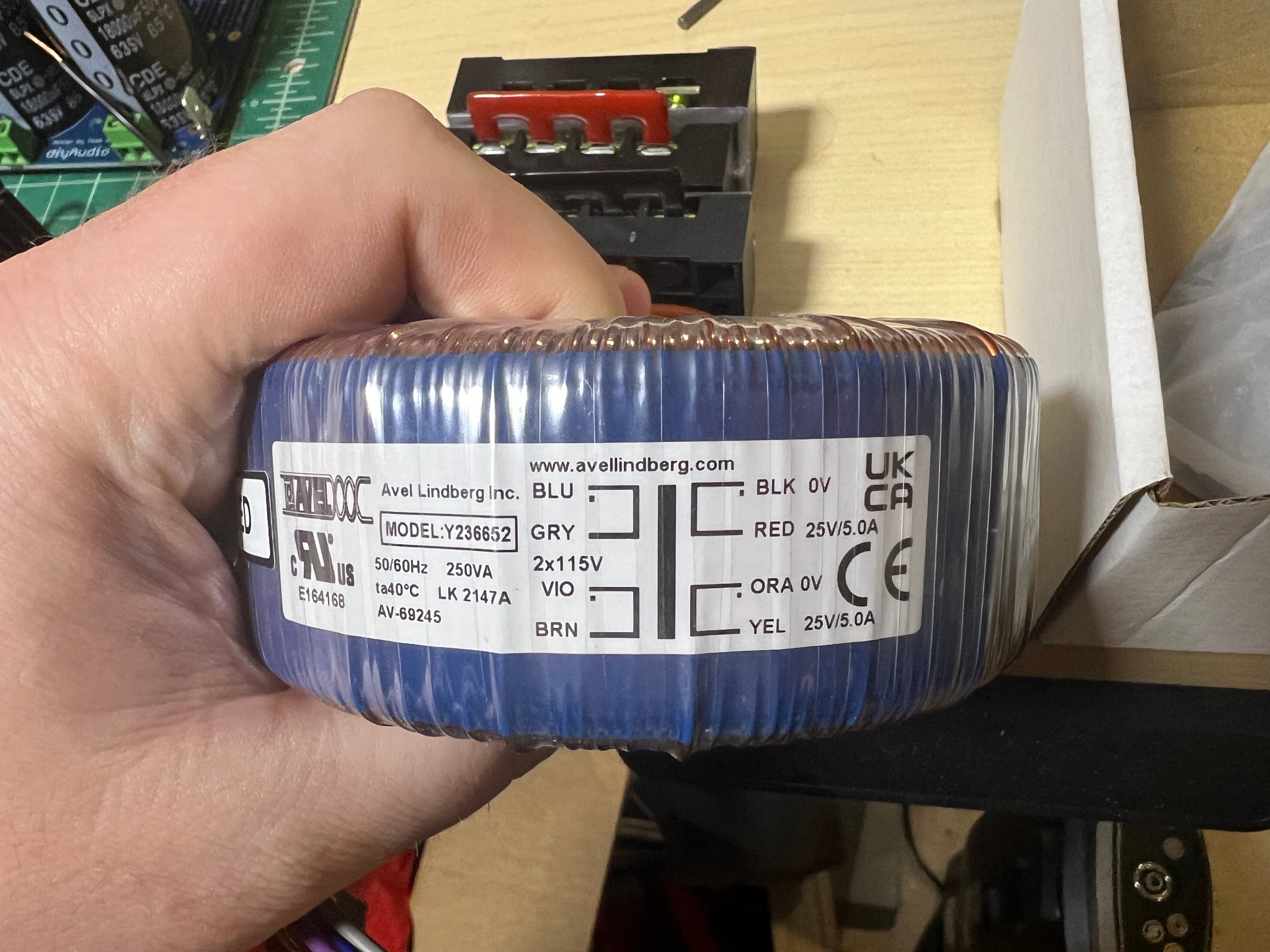

I have v3 of the boards. I've split the boards up into 4 individual pieces and was planning to jumper wire from the rectifier to each of the boards for dc. I have a toroid which has, as I understand it, 2 pairs of 110/US volts ac in and a 25v ac out.
The toroid I have is: https://www.parts-express.com/Avel-Y236652-250VA-25V25V-Toroidal-Transformer-122-625?quantity=1
If I understand how this works I have 2 separate inputs.
blue / gray line in goes to black / red at 25v out
violet / brown line in goes to orange / yellow 25v out
So if I only need a single 25v I could just hook up blue/gray and black/red right? I don't have to use both? Or if I want both I would hook blue/violet to black and gray/ground to white - for instance.
Then on the output from the transformer I would hook black/red to what? This is where I am a little unsure. Would I hook black to AC1A and red to AC1b? I'm not sure what to do here.

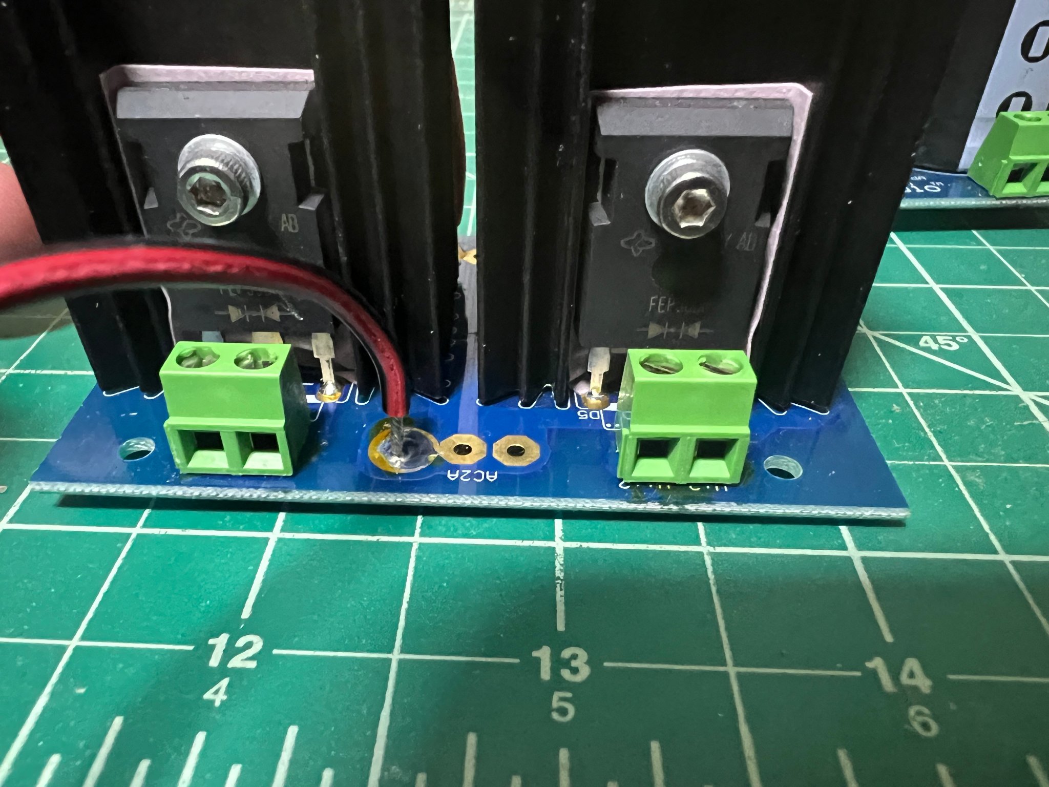

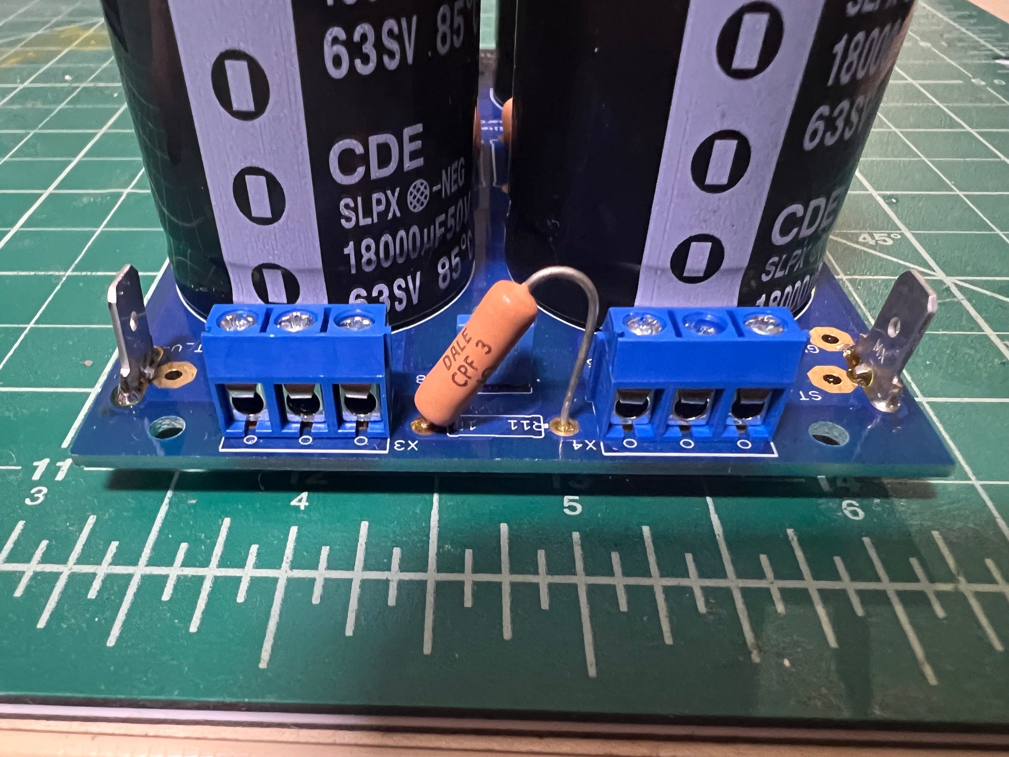

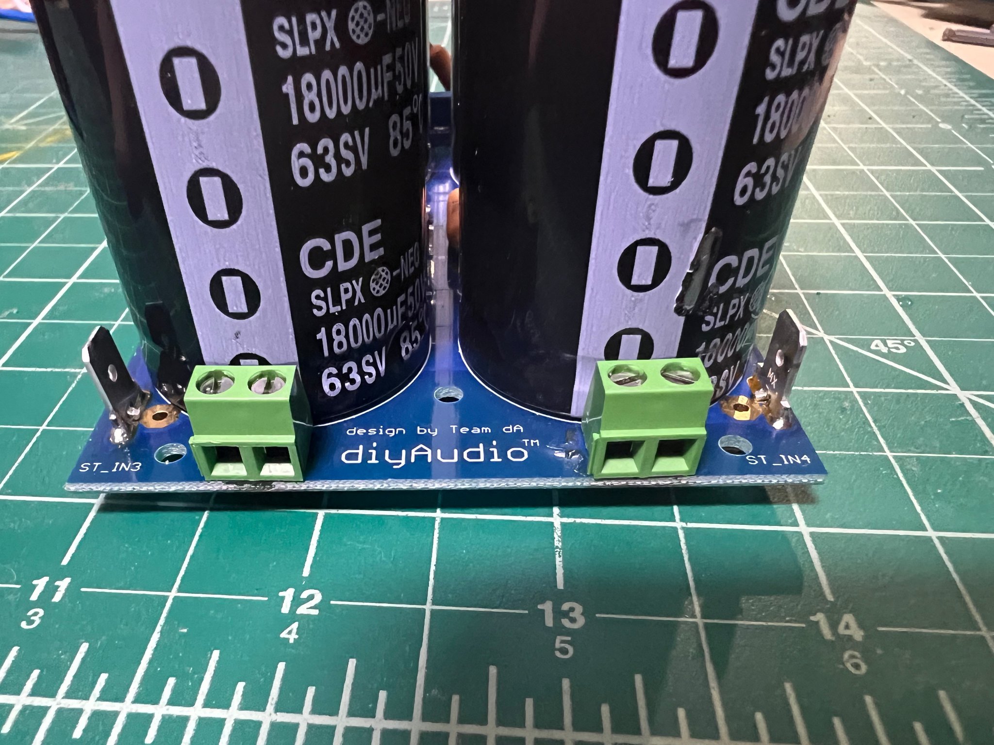

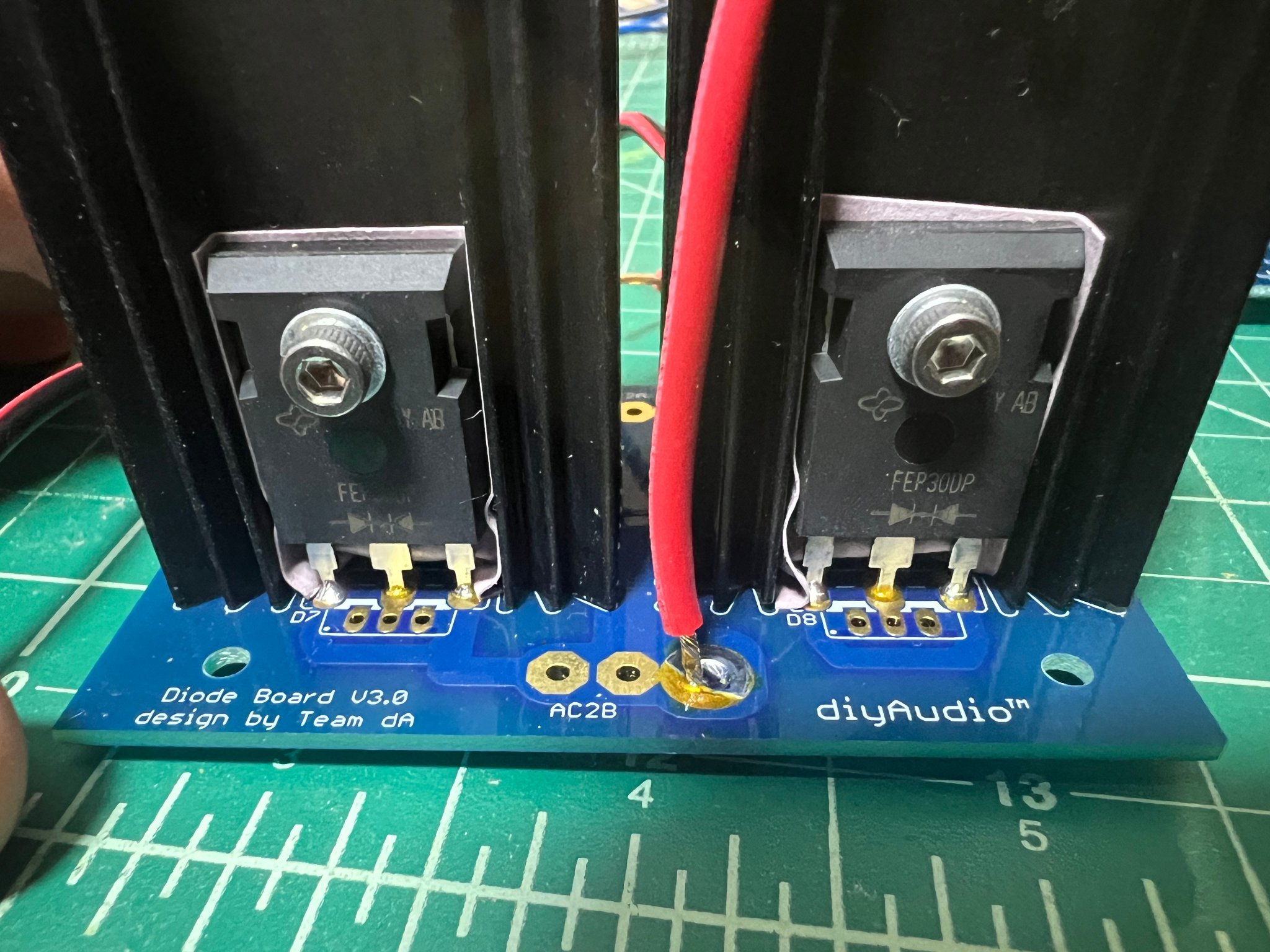

In case it helps attached is the photo from the actual toroid. I also attached views of both sides of the rectifier and dc board. I accidentally ordered the wrong size resistor - guessing thats just an overkill resistor right? 😉

That transformer won't work for ACA. You need 18VAC secondaries to make 24VDC.
Yes, you can use one cap board and one diode section for a single voltage supply. Transformer connections would be primary in parallel, BLU+VIO to live, GRY+BRN to neutral. Secondary also in parallel, BLK+ORA to AC1A on the diode section, RED+YEL to AC1B.
