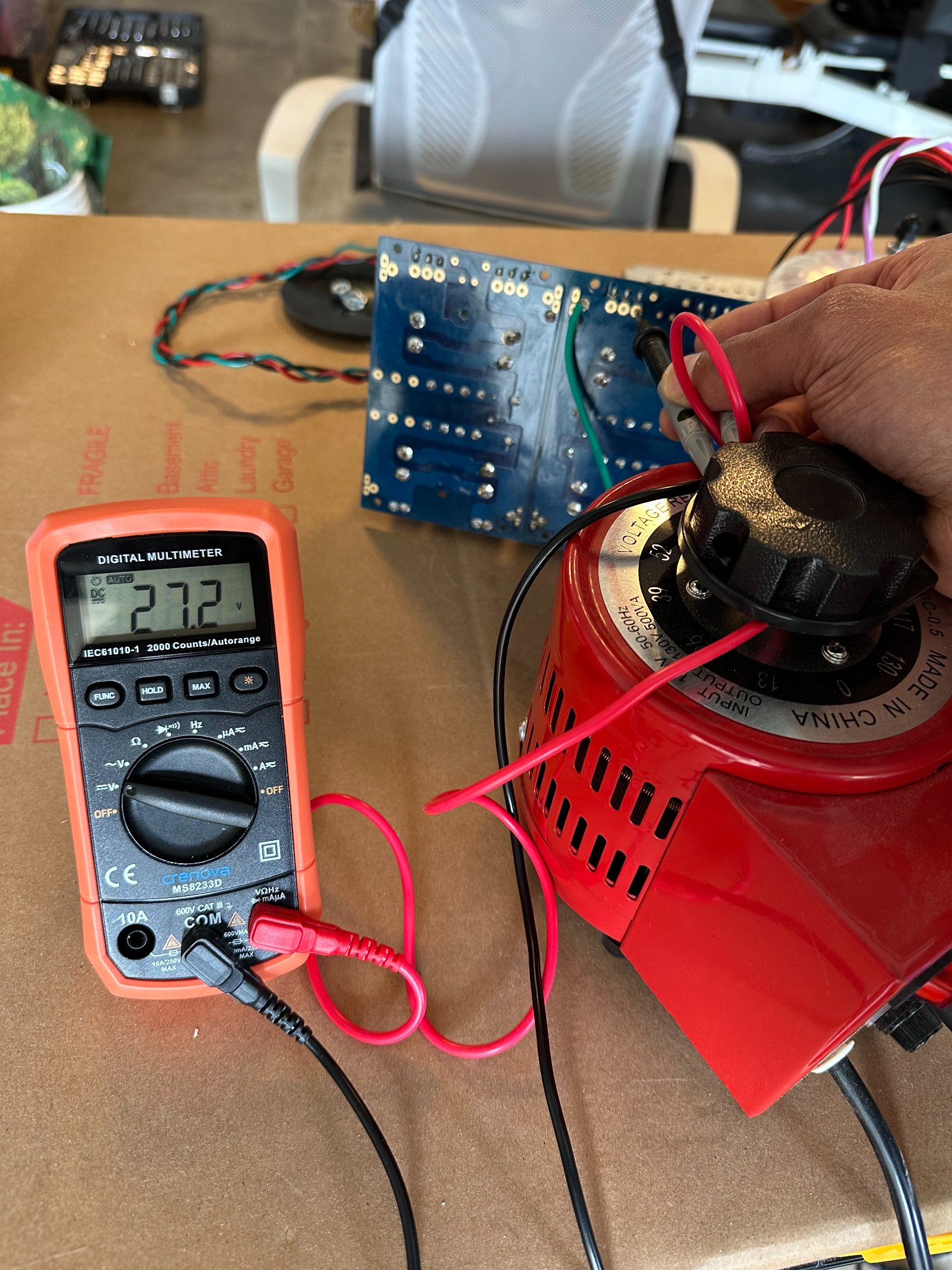

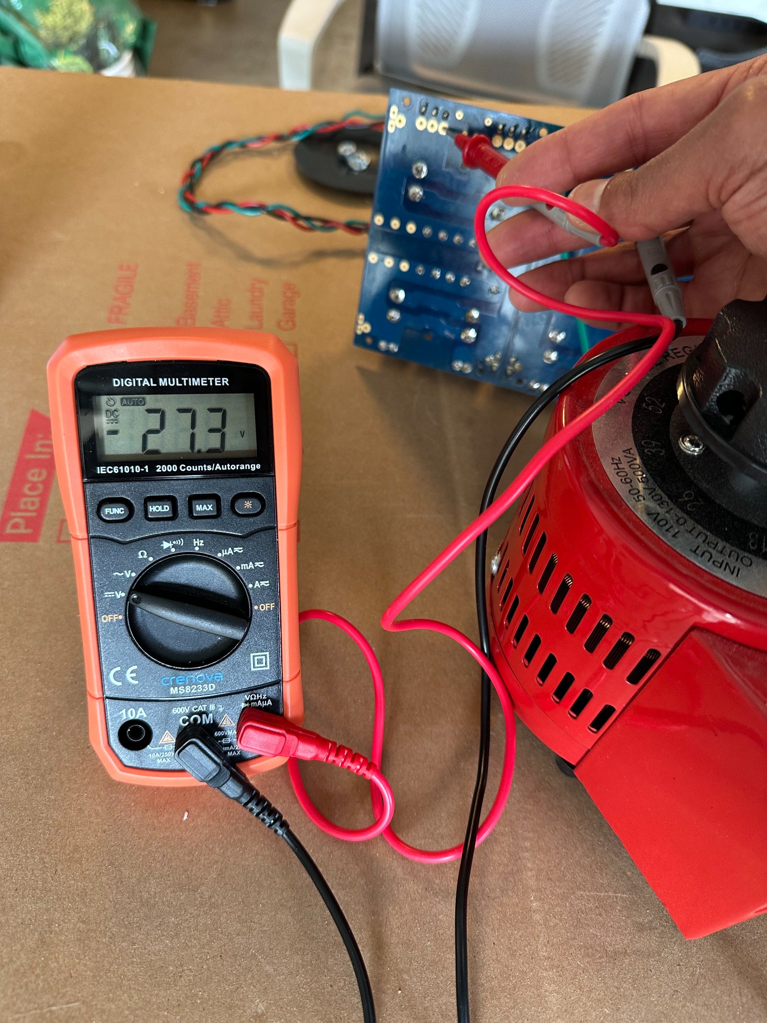

PROBLEM SOLVED - Since I ran everything with the dim bulb test multiple times and I knew I didn't have a dead short, I pulled the DBT and ran with the variac instead. I was able to get everything up to expected voltages (or a little hotter) on the first pass. I don't know if the bulb I was using was bad (we don't have many bulbs around so grabbed the first one I saw that looked like an incandescent, maybe it's not?) or there is something off in the wiring of my DBT, but at least my PSU is working now!
Special thanks to @ItsAllInMyHead to some helpful DMs and encouraging to check for silly errors, like using the wrong lightbulb.

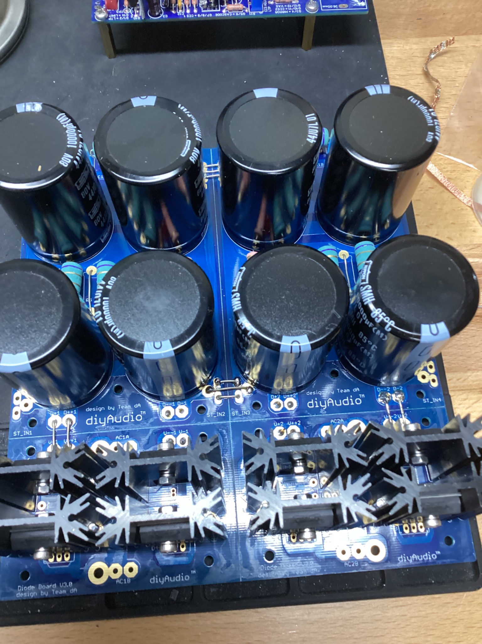

Looking good!
For a class-AB amplifier the R value in the CRC needs to be very low, even lower than a alass-A amp.. I'd choose something like 0.47ohm 3W resistors in all the standard and optional positions. Your (4) 1ohm resistors in the PSUs are too much R, however by jumpering the optional resistor positions you have essentially removed the resistors, (because the wires are in parallel with the resistors...) so it will not cause any issues.
Yes, the diode bridges are cheaper... but the discrete solution with heatsinks looks amazing.
Output snubber is useless, you should leave it open. However, you have stuffed the output snubber in the photos... the input snubber is the one near the diodes and is quite useful. Getting PCBs made from JLCPCB or similar is quite easy, use this as a great chance to get Quasimodo made. Or ask in the thread if anybody has a spare PCB, I bet somebody does.

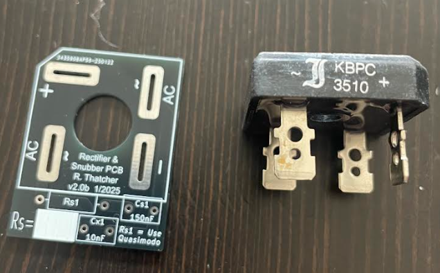

Ok, I built the Quasimodo Bell Ringer (yayyyyy!) So now I know the value of the two small film caps and the resistor I need to parallel with the secondaries on the transformers. Where exactly on the Universal Power Supply board do I mount these components?
In between the rectifier heatsinks... 😬
But don't fret, you can mount them to the underside of the board. What I would do is mark each position carefully underneath with a sharpie. Then install the devices. I get a little dyslexic with these types of things so I am a bit extra cautious. This will be nice because you can always change the value of the resistor in for some reason you change the transformer for a different one some day.
Another note, write the value of the resistor that you install for future reference. I sometimes write the snubber specs on the underside or in a discrete location on my transformer as well.

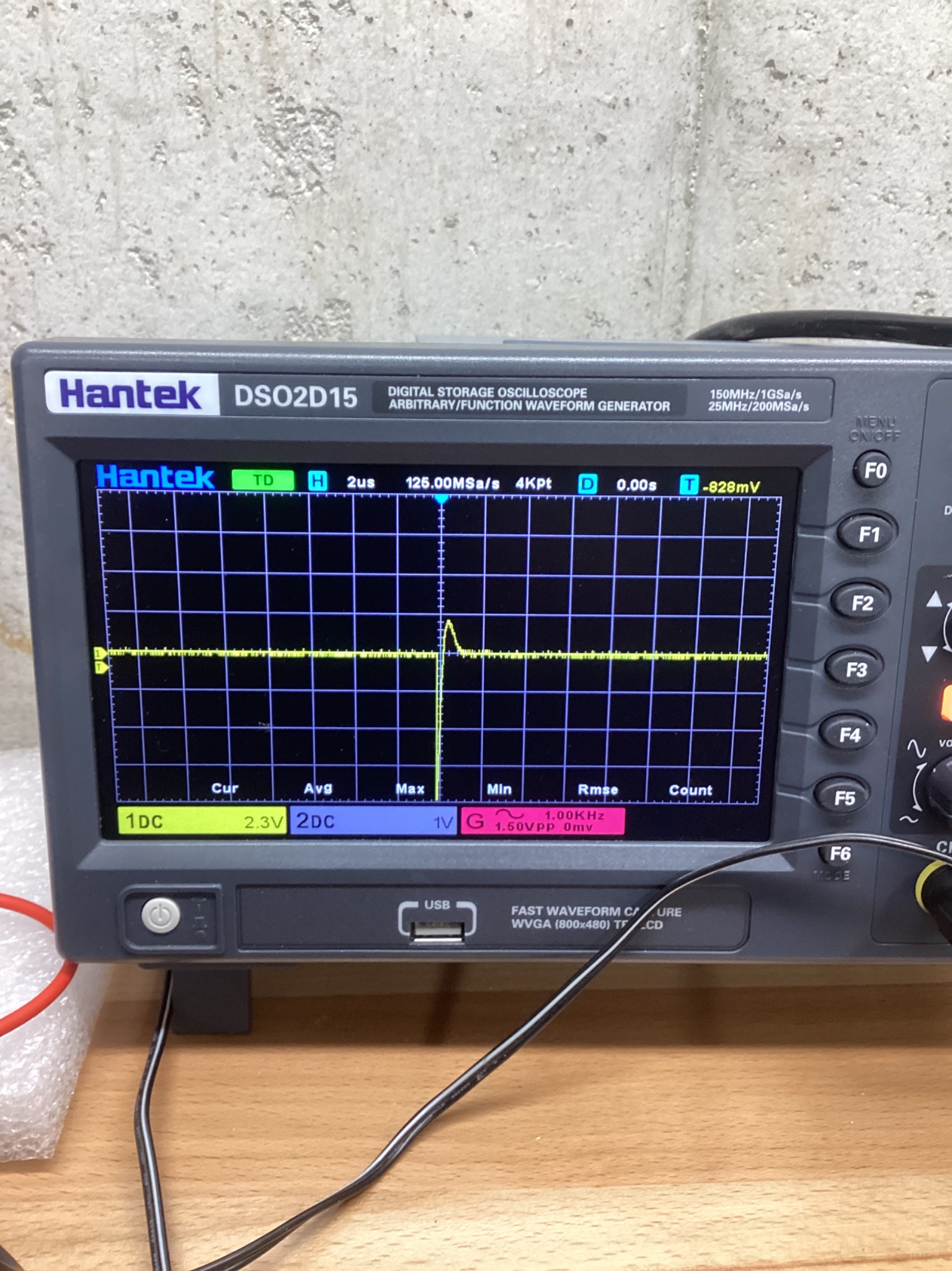

Ok Mike, I guess I'll be able to fit the caps in there somewhere. There are two audio grade 500 VA Toroidy transformers each with its own power supply going into this Wolverine amplifier. I think i's a good idea to note the value of the snubbers, but honestly, if I survive this build I hope I never have to open the chassis again.😀
Just saw your last post, looks like we are building the same setup with the same transformers lol!
I just ordered two 500VA Toroidy monsters, the ones with the stainless steel covers. Are those the ones you have too? If yes, can I just use the same spec components you got calculated for your setup? 😎
Basically all I need is Rs1 value.
dovia83,
Those transformers look awesome, but they are not the ones I have. I have the next level down Audi Grade transformers without the steel covers. They each have twin 50 V secondaries.
So with 0.01 uF and 0.15 uF caps I measured 20.9 ohms for one secondary and 23.6 ohms for the second. So based on this I plan to use a 22 ohm resistor on each secondary.
See my Quasimodo set-up below. The picture on the left is before setting the resistance and shows the ringing. The picture on the right shows the circuit with the approximately 22 ohms dialed in.

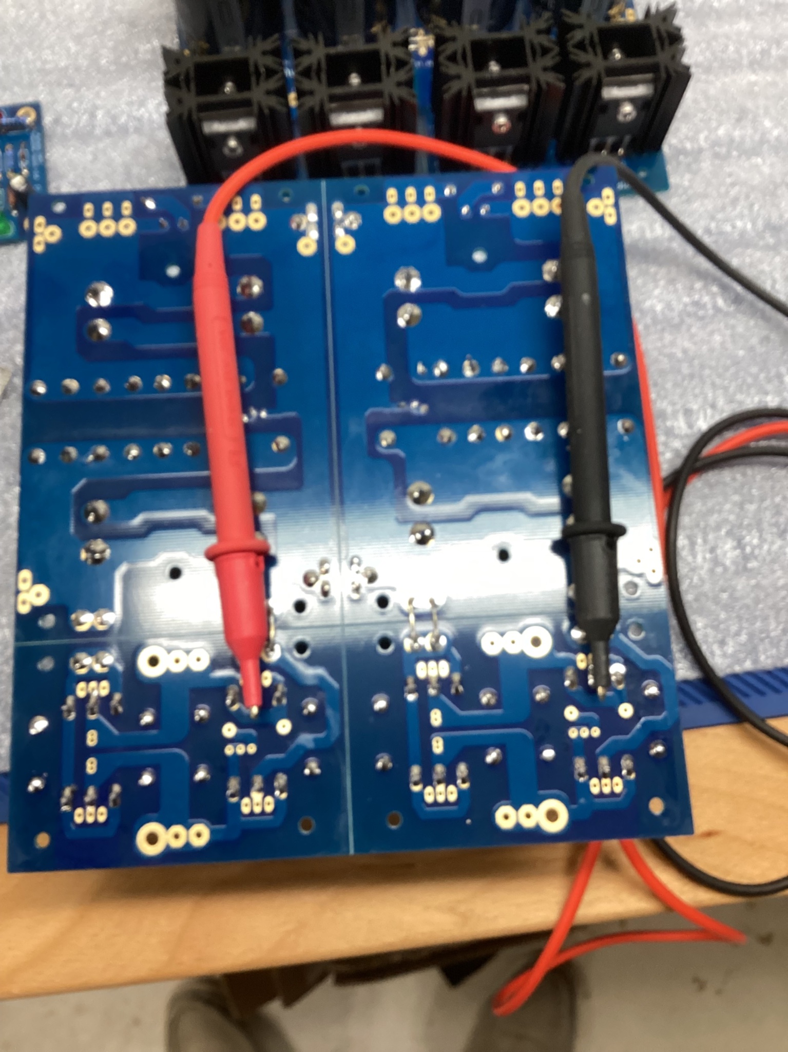

Hi guys,

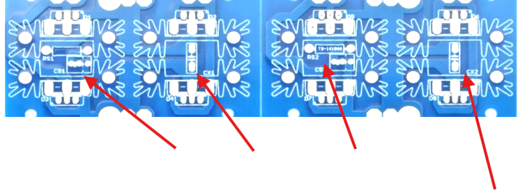

I am still confused about snubber placement on this board. The way I understand the Quasimodo is that I need a 0.01 uF and a 0.15 uF film cap along with the appropriate resistor in parallel with each of the secondaries of a bipolar supply.
When I look at the underside of the Universal PSU I see a place for a resistor and in front of it are 3 holes that could possibly take one of the films caps. Is this correct? Where does the second film cap go? Or am I completely off base here?
Below is a picture of the underside of my Universal PSU board. I have my meter probes pointing at the locations I think the components should go, but there looks like there is room for only the snubber resistor and one cap.
Any help would be greatly appreciated,
John
This is a segment of the schematic for the board. CX1,2 : CS1,2 : RS1,2 are the components. You can find their markings clearly on the silkscreen. You have your diodes and heatsinks installed, which may obscure them. Further below is a photo of the board for you to match if you'd like to install the components on the 'under' side of the board. Further good news is that none of the components are polar, so plonk them into place in their correct spots without regard to any orientation.
