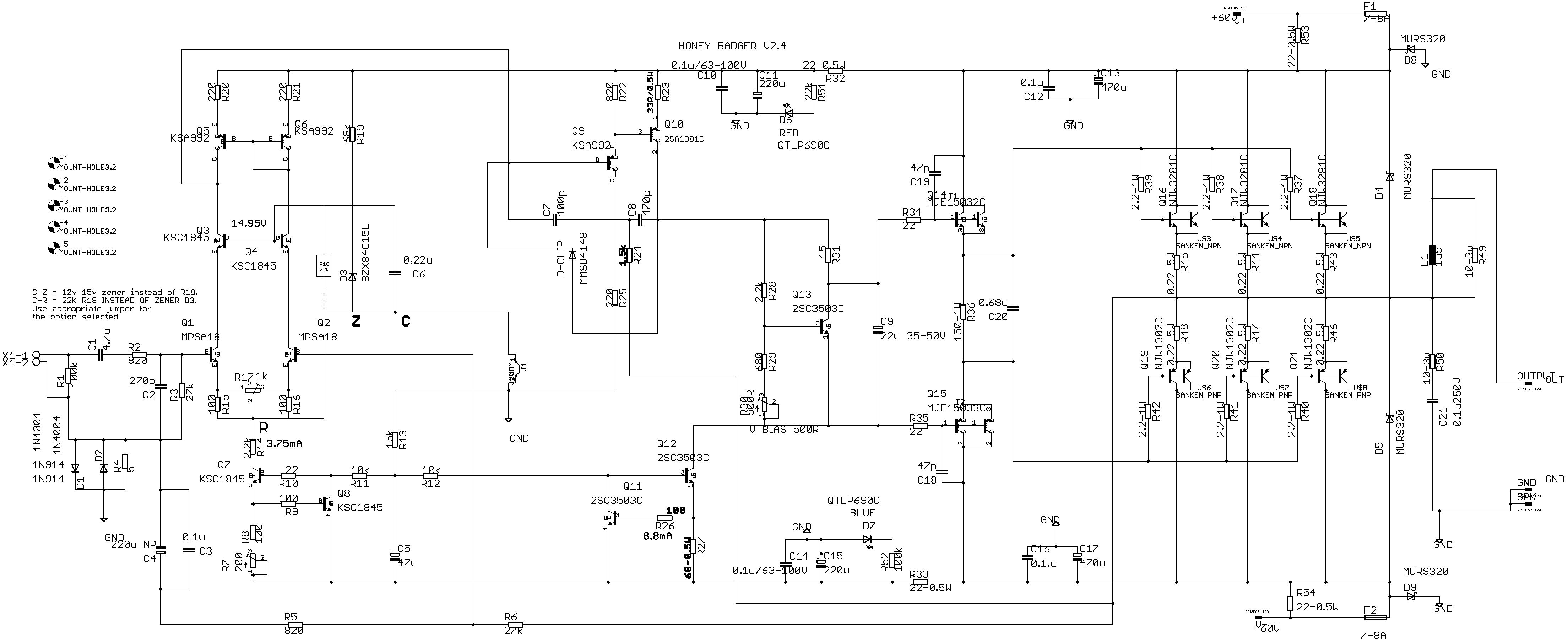

If I get it right, you've arranged the output and input terminals quite close to each other at the PCB's bottom right corner, as shown in the pics. In addition, the output inductor comes close to the input coupling capacitor. Maybe the few pF's between these components are enough to turn a high bandwith amplifier like the HB into a power oscillator.
Best regards!
That large coupling cap also caught my eye. Some say that large caps act as antennas picking up EMV noise, which may cause oscillation. I have never had this issue (not only in the Badger), but you never know. Try using a capacitor of the same value, but at a physically smaller size just to see if this is an issue.
Try a wire jumper instead and get the capacitor offboard, if you need any.
But first short circuit the input right at the board. Does the Boucherot resistor still get hot?
Best regards!

If your homemade PCB is the same layout as the official one, some of your transistors appear to be installed backwards. Q10-12. TO-126 transistors have the opposite pinout compared to TO-220.

Kay Pirinha:when I short circuit the "Input +" and "Input -" and switch on the amplifier, R50 is ice cold and also stays ice cold. So what does it mean and what to do next?
Akimet: I used the schematic of original HB. The layout I made on my own. I have routed the electrical lines different to the original HB layout. I took the different pinouts into account and double checked things like this many times.

a wire jumper for the big capacitor to bring it off the board doesn't bring any changes.
If the Inputs are not short circuited R50 gets very hot. If the Inputs are short circuited R50 stays cold. Independently from the position of the capacitor...

olllo, it is likely the pre output driver. pull out all the transistors on the R50 output and power on again.

I would try removing the 15033,32 and replace with KSA1381 KSC3503. and test for oscillation. These transistors won't be able to drive to full power but may kill the oscillation ( output speed issue). R34,35 could go to 47 ohms. Your schematic appears to have 2 transistors in each of the driver and output positions where there should only be one.

I tried it, Stocktrader. I also take the different pinout of the transistors into account. But there was no change. R50 becomes still very hot.

Hi Olllo,
If the input is shorted and R50 remains cool it seems to me that your input might be picking up RF noise when the input is 'open' and amplifying it.
However it could also be PCB layout related with your output and input being so close together.
May I suggest that you test this by plugging in a normal signal source - eg a CD player turned on but nothing playing. The CD output is very low impedance, like an input short. If R50 remains cool it could be RF.
Now play a CD, preferably a quiet one. If R50 gets hot again you probably have an unintended feedback loop from output back to input.
There should be no load connected of course. I do not know how it would be fixed other than using the official PCB.

As I have two HB boards half-finished on my workbench at the moment, my two cents:
A long time ago I had a wildly oscillating 100W-Elrad-Amp. It took me quite a while to find that the resistors in the Boucherot circuit didn´t look like it, but were wire-wound and caused the problem. You used wire-wound resistors for R49 and R50, which I would try to replace with the 3W metal film types Reichelt offers (Part-ID: AKA RSMF3TB 10R0).
Not related to the actual problem: what I find missing is the thermal coupling of Q1 & Q2 as well as the common little heat sink for Q10, 11 and 12.
Hi Oliver,
well, this exactly confirms my suspicion! The input ist too close to the output, the output couples cpacitively into the input, hence causing oscillation, supposedly in the MHz range.
Just to exclude another possible reason, you might try to replace those six wire wound 0R22 emitter resistors by none-inductive ones. Please look at www.pollin.de, they might still offer these resistors, made by Futaba.
Best and definitive solution would surely be to replace the PCB's by official ones from the DIYAudio store.
