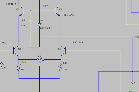

I tried it, Stocktrader. I also take the different pinout of the transistors into account. But there was no change. R50 becomes still very hot.
Oliver
Have you tried removing C6 capacitor?
I found this fixed my huge oscillation issue.
I had an output to input oscillation via the power system coupled by C6.
Removing C6 fixed it.
As the transistors are configured as a common base configuration acting as a cascode, shouldn't one end of C6 be grounded and the other end to the zener diode's cathode in parallel? At least thats the schematic in the LT Spice simulation. The zener just gives a regulated voltage with the C6 in parallel for the common base system and i fail to see how C6 can cause input oscillation via the power system.
Without a Doubt C6 was causing my oscillation. I could trace it from the output, back through the power bias traces, and back into the power input of the front transistors. I tried putting a 0.1uf cap from power trace to earth, it made the oscillation earth out so bad it burnt out resistors on the board. I actually found the oscillation cause by increasing C6 capacitance thinking it may be zener noise. It made the oscillation larger. So i removed C6 and the oscillation stopped all together and i can now use the amp luckily. I dont think one end of the C6 is earth out on the board, its on either side of the zener to snub zener noise. Its not needed at all for a good running amp circuit. This is what i found in my amp. Multiple boards were the same, and i used exact parts list for the current honey badger and the latest diy audio boards. I tried everything else you can think of to fix the oscillation, only removing C6 fixed it.
I dont think one end of the C6 is earth out on the board, its on either side of the zener to snub zener noise..
Yes, C6 is on either side of the zenner, and one side of the zenner (the anode) is grounded, while the cathode is used to bias the common base stage. Please have a look at the diagram below. i am surprised that the C6 which is just used to smooth out the zener caused oscillations.
I have no doubt that what you say is correct that C6 fixed your problem, but I want to know why it was the case when it should not be.
If you look at the schematic on diy audio, the zener and C6 supply the front differential pair transistors with power and neither side is connected to earth.

I quote from page 8 of the build guide itself "The first is a zener referenced design. Omit R18, replace it with a 12V -15V zener diode and set jumper pad "C" to "Z" with a jumper wire. You will have a cascode reference of either 12 or 15V, depending on your zener diode choice"
When you set Jumper "C to Z", you are shorting 'C' which is anode of the Zener to 'Z' which is a ground trace.
I'm sorry, you are correct.
The schematic on the site is wrong then and misleading, it shows the setup for the link C to R only where a resistor is used.
And nothing about the zener C to Z link.
I have no idea why C6 caused the oscillation, could it be a massive earth loop oscillation.
Something i hadn't thought about since i was mostly referring to the schematic which was different to my selection on the board.
If a zener is biased too low it can have negative resistance and oscillate into the capacitor. Cascodes sometimes oscillate themselves and so another possibility is that the zener was acting as a sort of base stopper.
If the oscillation changed depending on source impedance or whether the source was connected, then that would suggest you may need base stoppers.
Are you sure? I've never seen any negative resistance in zener diodes' characteristics.
