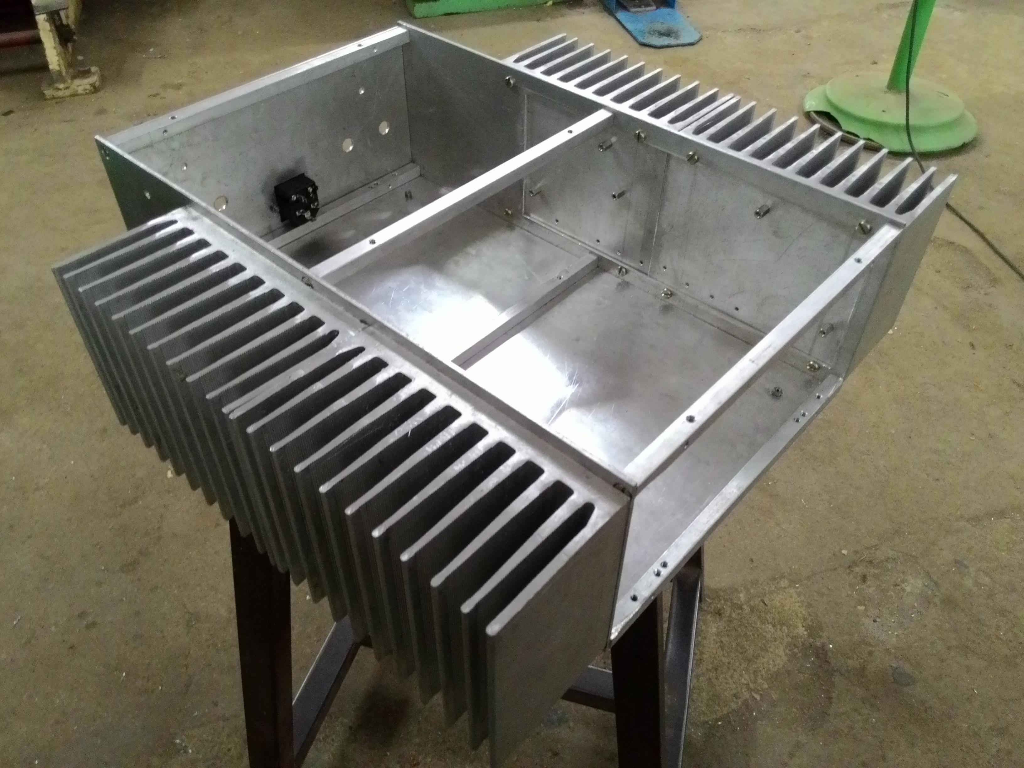

My heatsinks are 3" x 5" x 12". Can we set it higher than the 100mA recommended ? Does it make sense to do this ?
the heatsink looks like they are split in two 6" sections. Ensure that both sections receive a heat load and try to get an equal heat load to both and as close to the ends as your device layout will allow.
Try measuring temperatures after you have it running.
