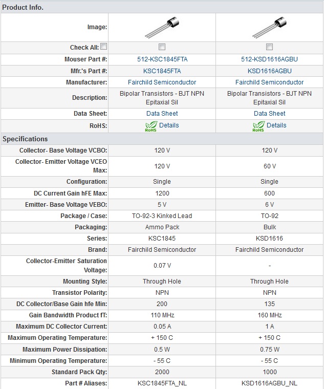

I accidentally purchased and installed some transistors which are similar to - but not exactly the same as - those listed in the BOM. Specifically, Q3 and Q4 in the cascode/current mirror and Q7 and Q8 in the VAS are supposed to be type KSC1845. I installed KSD1616A. They are both BJT NPN transistors. I have included a screen shot of the comparison of the two. My question is: Is it worth the effort to purchase and install the correct transistors?
Any help is appreciated! 😕

They look good to me. I did not know about the 1616a.
As long as they are ECB , should be fine. Faster device (160mhz ft).
Cascode is the only pair that has to be >100V , beta helper in the VAS - also , >100v.
I actually use low voltage for my input pair (ksa/c -1015/1815) and current mirrors.
Input pair only sees @ 12-15V, current mirror just a couple. Cascode sees nearly the full rail.
