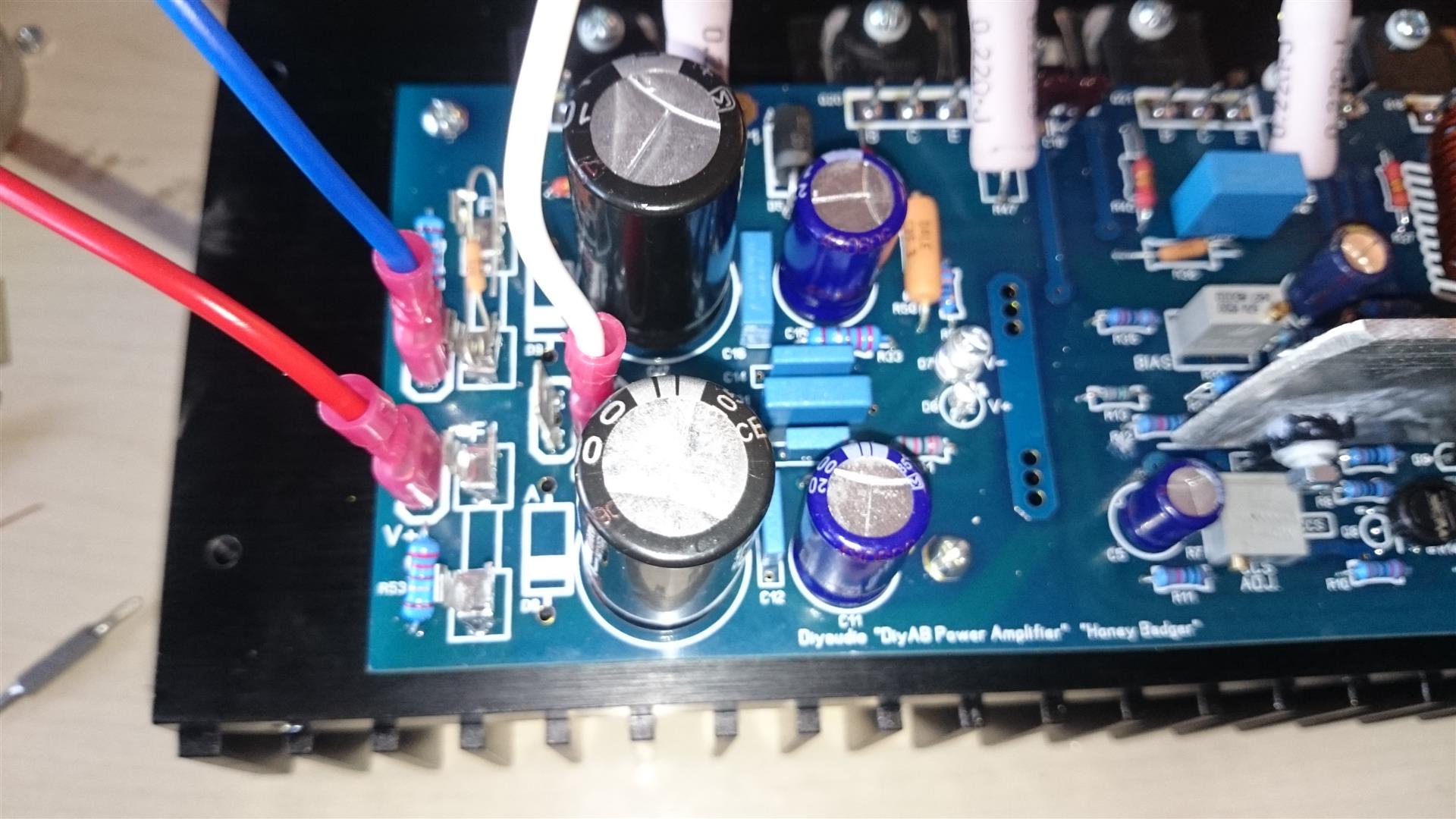

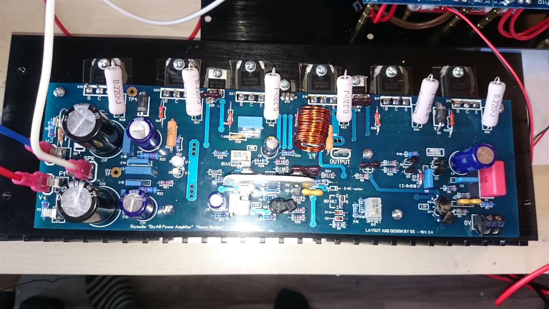

Can you guys see if there's something wrong here?
On both channels the 10 ohm 1w resistor releases it's magic smoke. I measured 5v dc across one of them. There's no light on the led.
Where do I start troubleshooting? 😕
Red wire = +60v, white wire = gnd blue wire = -60v
