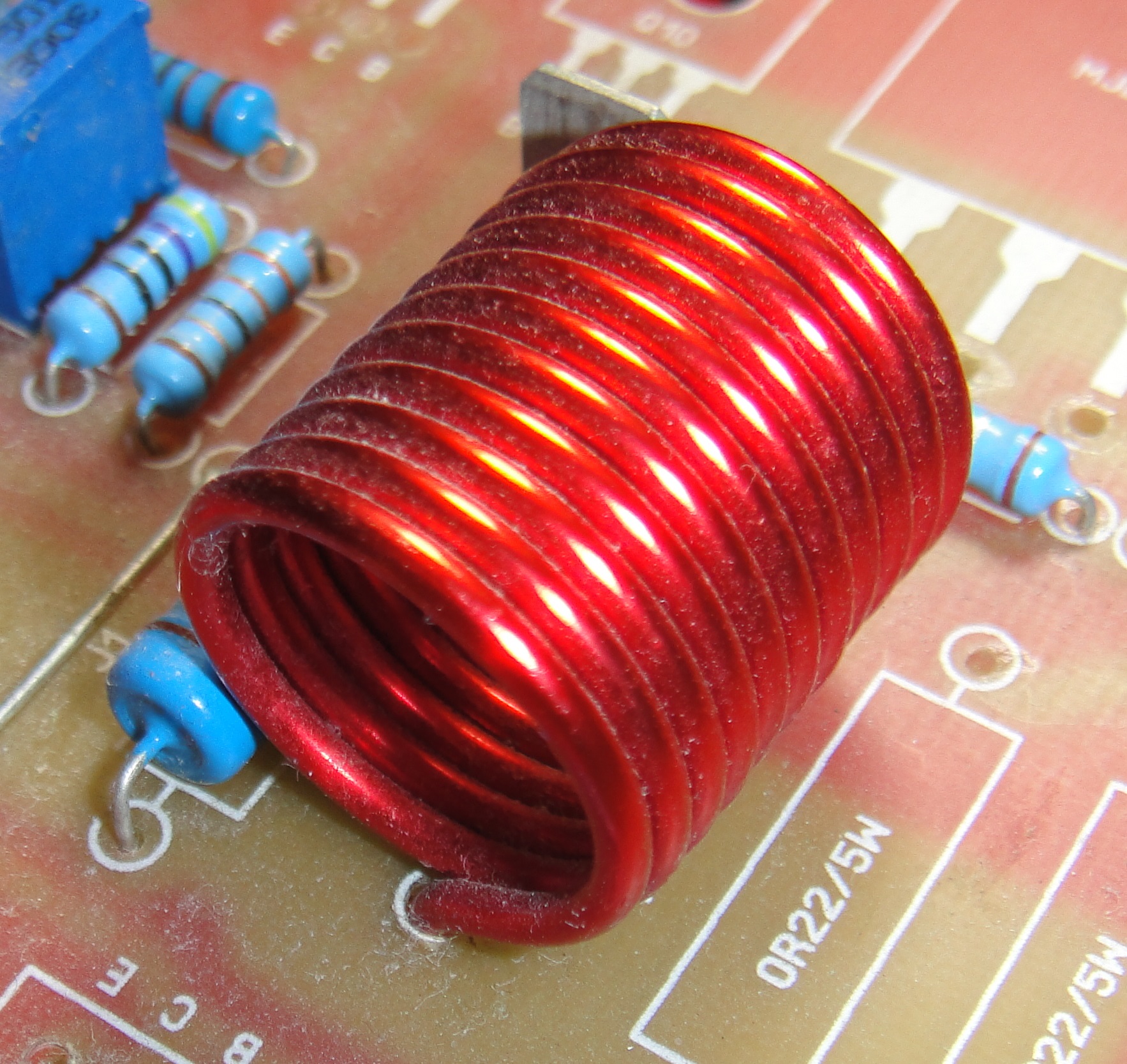

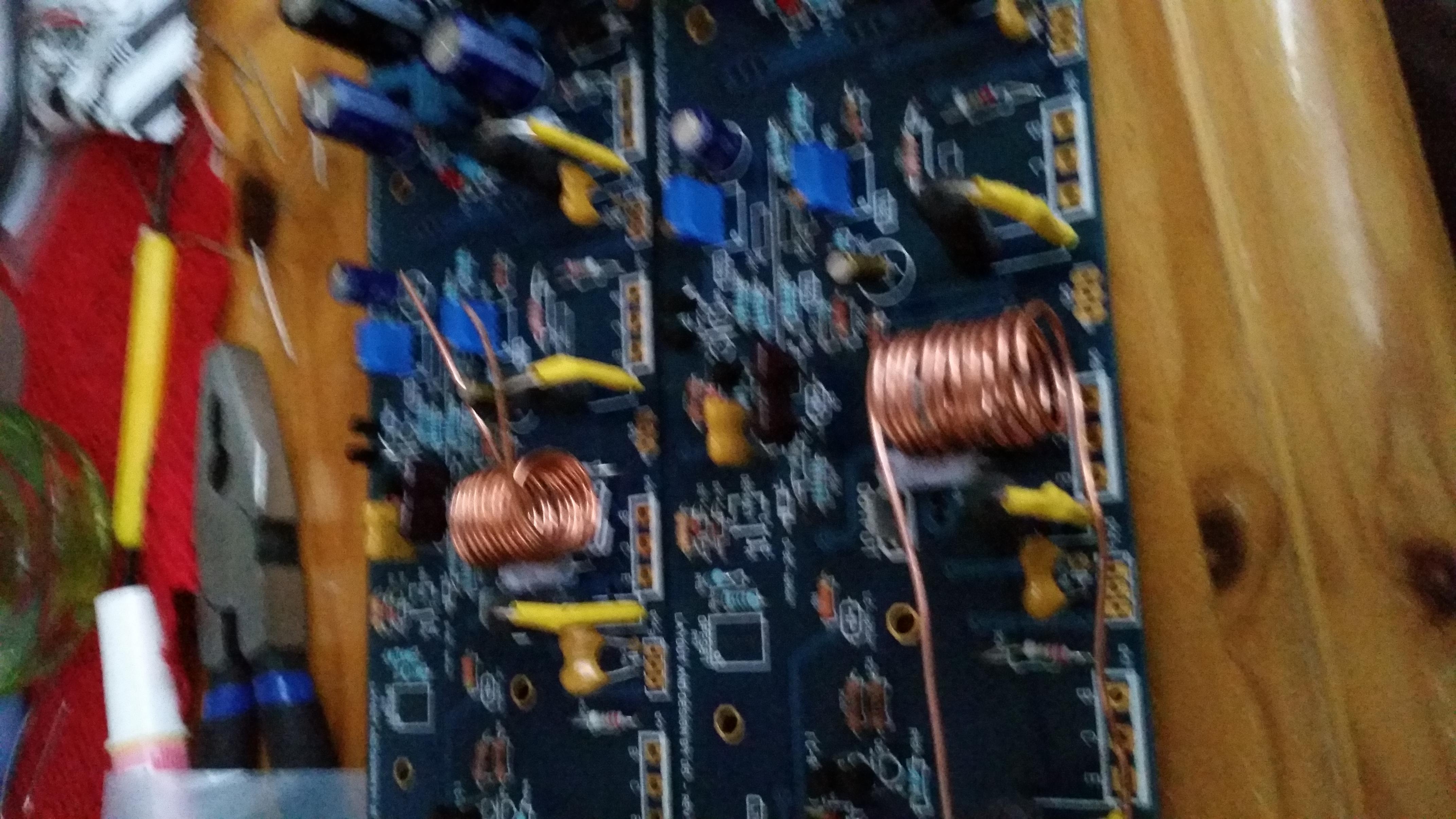

does these inductors looks ok ?
L1 inductor, 1.5µH - 14-16 turns 18ga. enameled copper 12.5 -15mm diameter BOM

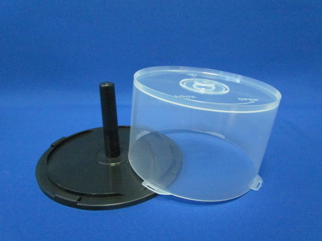

make it tight take your time sir, should look like this image close "example" , I use a pole from a CD container I drill one side to hold the wire then begin turning but tight really tight as possible and will look good
note: I use 15AWG because it retains the shape better in my case
Regards
Juan

Best "trick" of the week !! Thank you !!!
