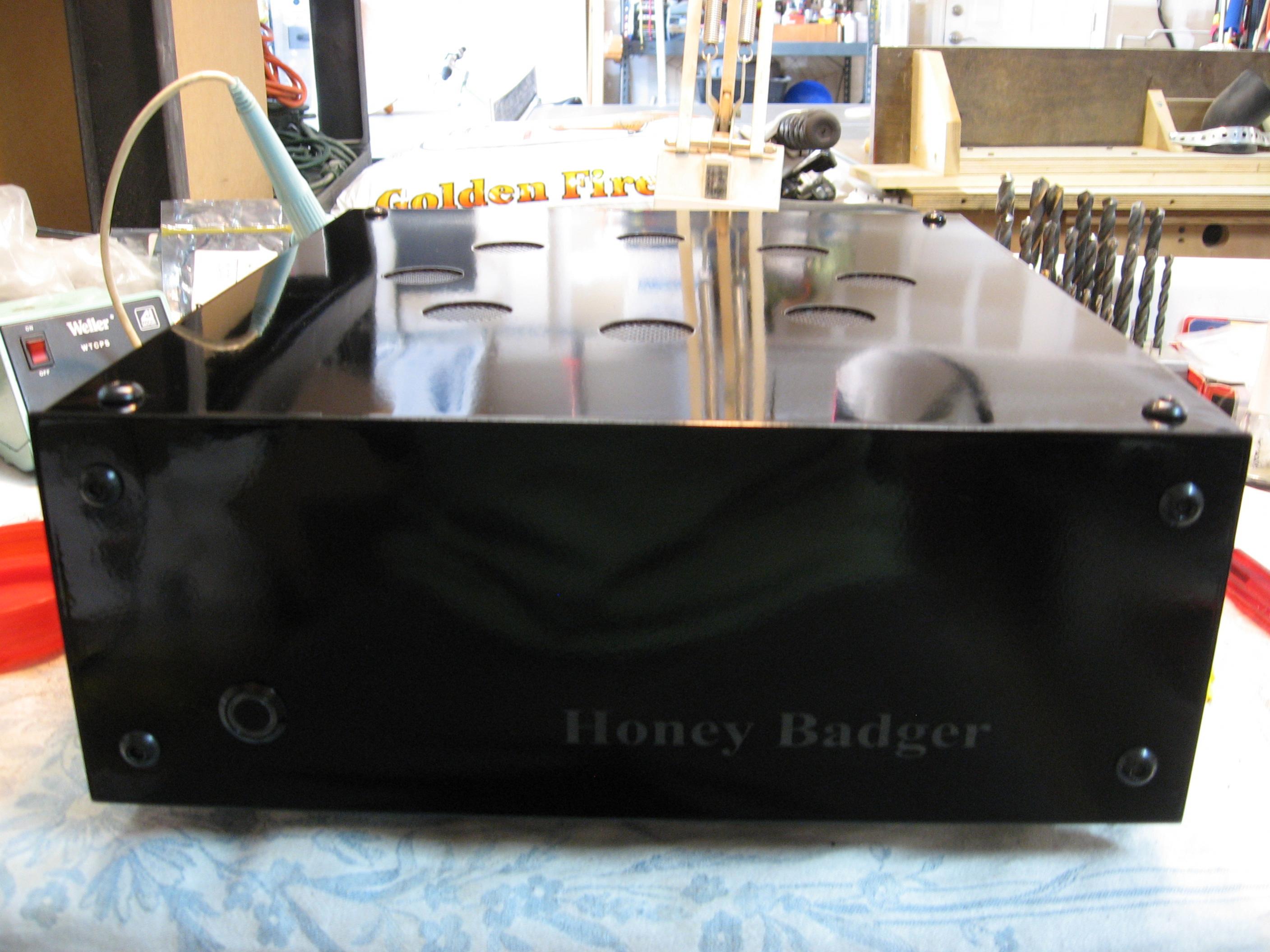

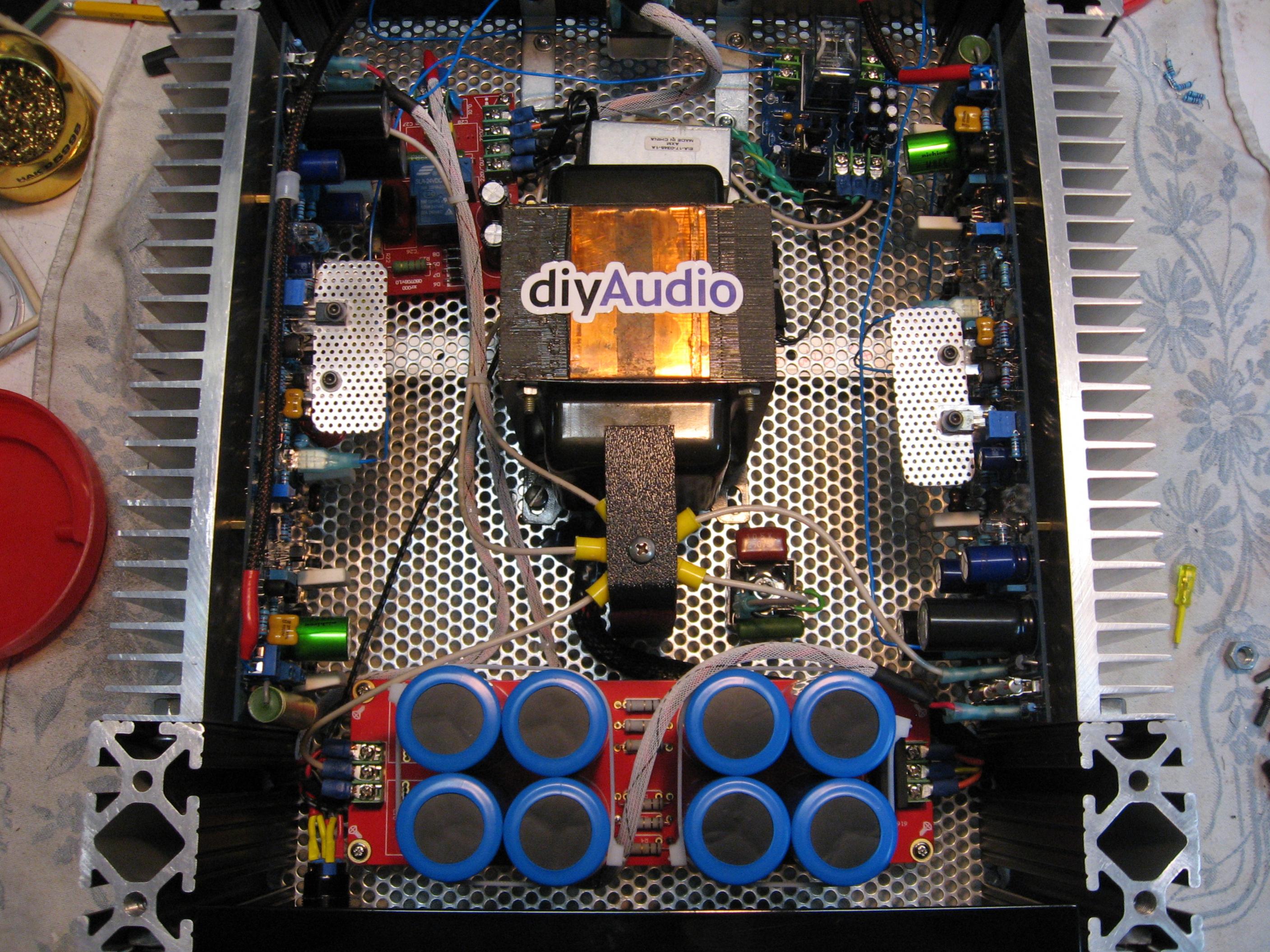

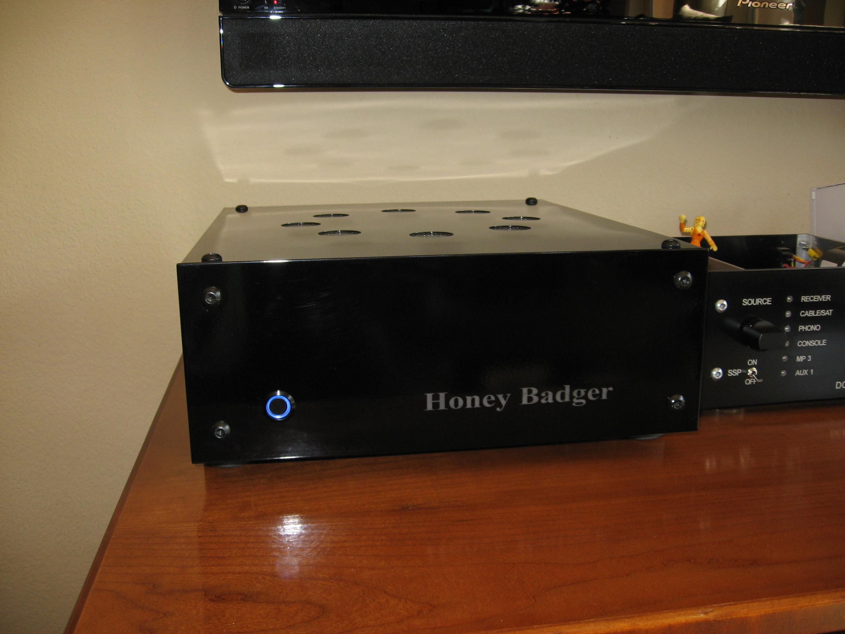

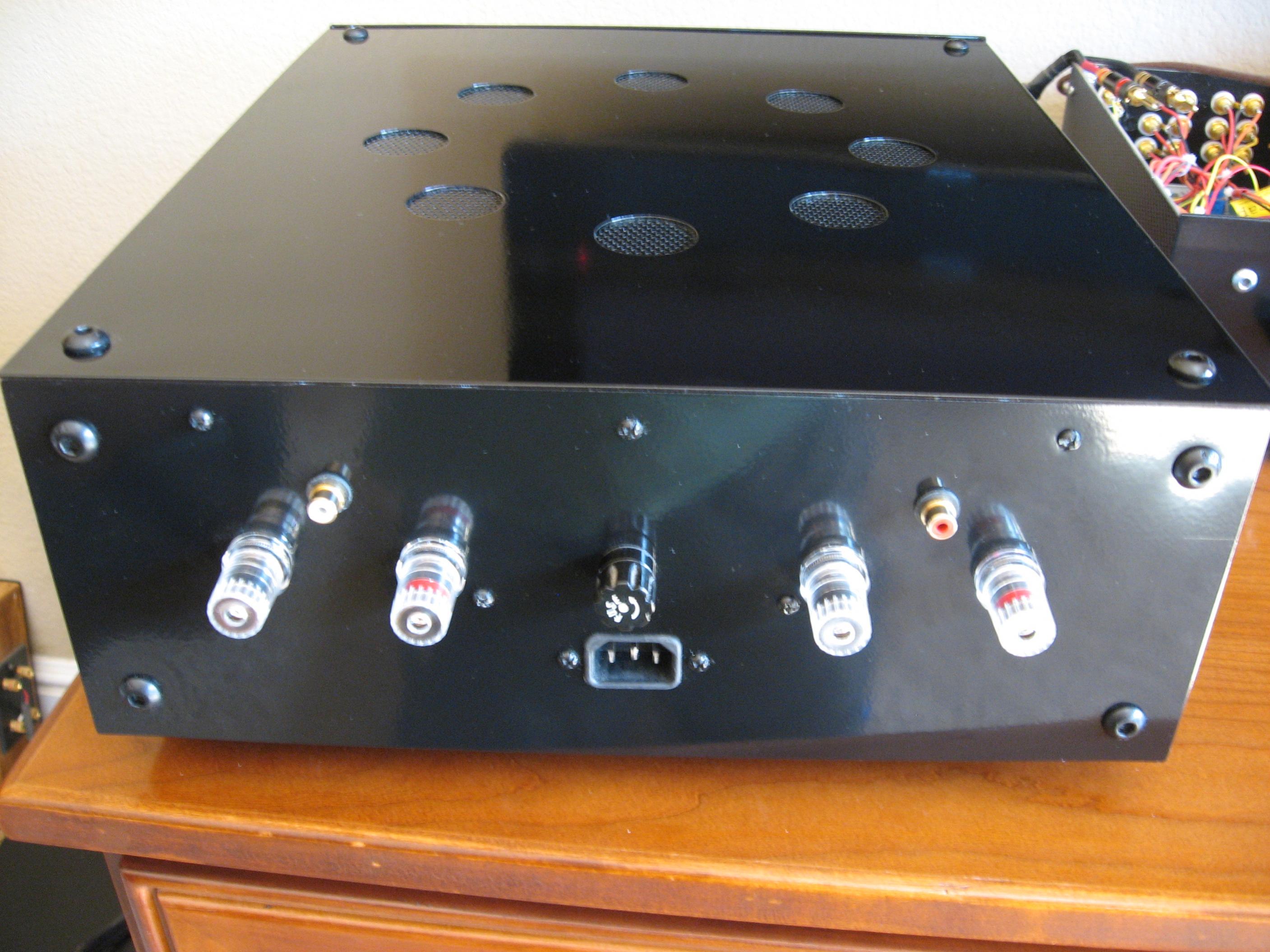

As promised photos of my quiet as the dead H.B.
Zero noise from the speakers until music.
I will give my impression of the amp after it has settled in and the caps have em, finalized. (no flame posts!)
Case is homemade, Transformer is from a Hafler DH-200. (recycled)
120,000uF power supply @ 63V.
Heatsink from Heatsink USA, 10" x 5" polished where transistors are mounted.
Silver 20ga. signal wire. Homemade shielded twisted input (thanks OS)
10 Ohm signal --->ground lift with 35A bridge and cap.
Speaker protection circuit and soft start circuit.
Many, many thanks to O.S. and those who have contributed so much. It IS appreciated. I don't want to name names as I might inadvertently leave someone out and cause hurt feelings. Suffice to say I have learned quite a bit and I am grateful for your assistance and teachings.
This has been a very fun and out of my comfort zone project from the start, but this is how we improve ourselves.
Thanks friends, you are many.
Ron

Renron,
Nice case, very good job.
However, with these swiss cheese VAS heatsinks you are asking for trouble in the long run. The whole area of the transistor must be heatsinked evenly. Somehow bolts got loose on my VAS transistors and although when cool these still measured well they did not perform well when hot.
cheers,
