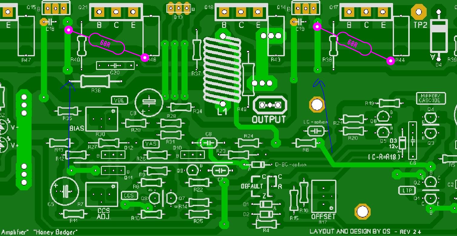

Dan -The fuses "throttle" the outputs.
TSIP - My first projects were an ampslab project and quasi's Nmos amp. I acknowledge this amp is a little more complicated , but it can be done by a beginner.
If this is built right up to the drivers(don't put the expensive outputs in yet) and Q14/15's emitters are tied to the output (L1) with 68R resistors (temporarily omit r36) , you will not blow anything -hopefully.
Adjust R30 (Vbias) for 1.2V between the emitters of Q14-15 and this amp is ready for the outputs. I use this for OEM repairs and all my builds (frugalamp , etc) ... only fried a couple of devices with probe slips and other stupid mistakes 😱 .
OS
Hello OS 🙂
I try to "visualize" the procedures of adjusting bias using the two 68R resistors method, so it will be like this image ? and then read with DMM 1.2V between emitters, and yes no r36 on the PCB 😛 " I just want it to be sure English is my second language and I see differently sometimes jejejejeje 😀
for me any detail it is really "mucho inportante" to make sure all goes smoothly
Regards
Juan
Hello OS 🙂
Regards
Juan
Yes , Juan.
The two 68R's will just form a class A "buffer" with the driver devices ,
with sufficient low Z for NFB to be derived.
About 1.1-1.15V will result in 0-10ma bias per device when the outputs
are soldered in.
I even do this for repairs. NO blown outputs (unless I'm drunk 😱).
PS - NO R36 ... the 2 X 68R's replace it temporarily. 2 X 82R will also
get you "close".
OS

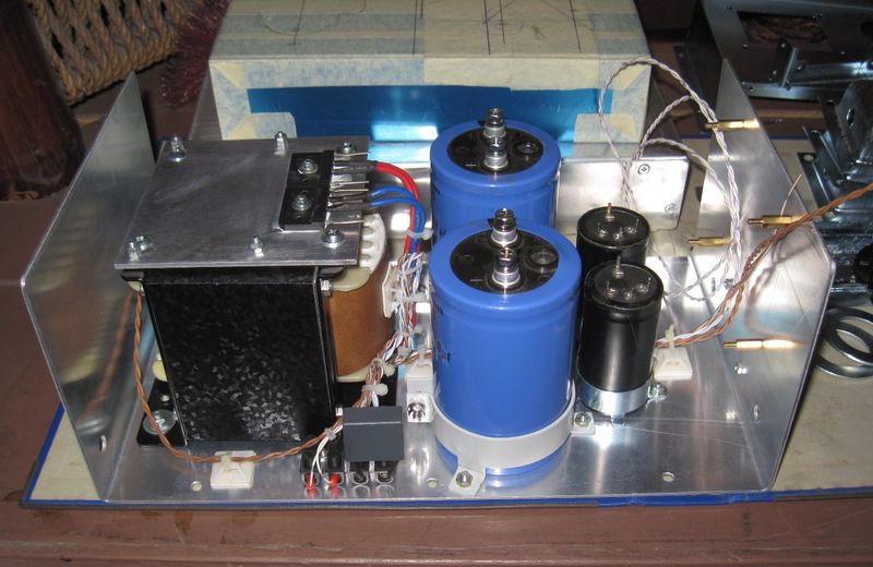

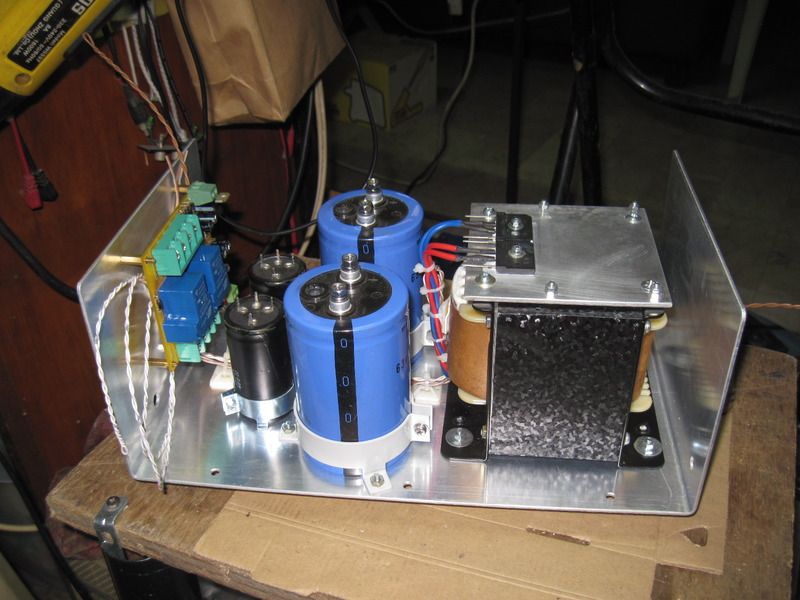

i am building mine using a sub-chassis for the psu, it will hold most of
the psu components including the speaker delay/protector board and
the soft start boards, so then only the mains switch and power inlet needs connecting.
with it i can test the badger modules even without a final chassis...
