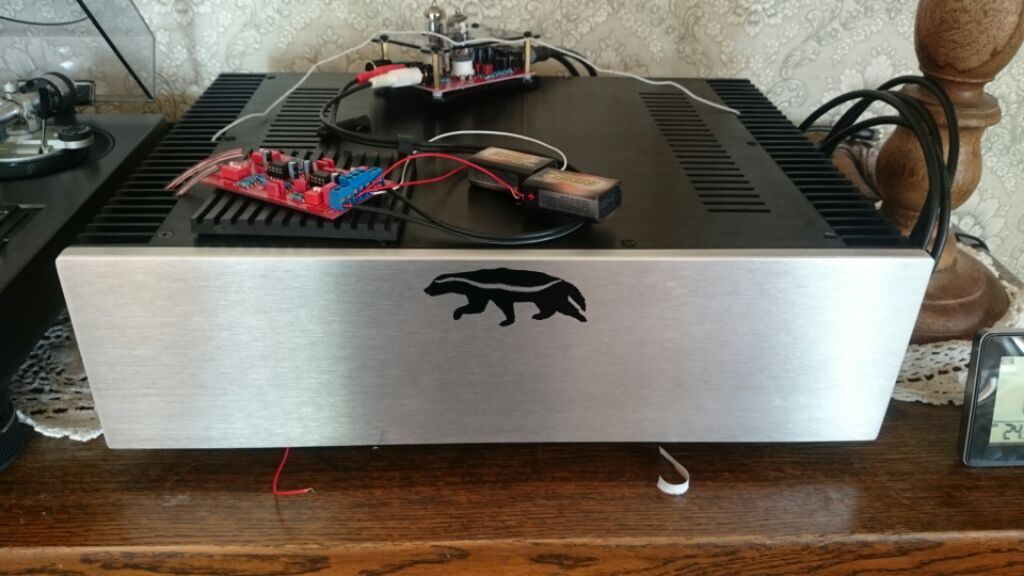

A finishing touch. 🙂

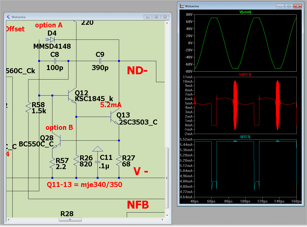

But not with a TMC compensated amp.
(below 1) , a transistor clamp produces a little negative resistance right when
the transistor clamps the saturation. This is just enough to kill the phase margin
for a few uS and give a short burst of oscillation.
(below 2) , the diode is fast enough to just shut things down faster than the
VAS device can saturate ( no "burst").
This does not happen on a standard miller compensated "blameless" , or
is you use a transistor clamp that is the same as the beta enhancer device.
Jung's "transdiode" might of worked for a slower MJExxx type VAS , or
non TMC setup ..... but not on these fast fairchilds.
Also , the diode's reverse breakdown is better defined than the transistor
in a "transdiode" arrangement. - https://www.onsemi.com/pub/.../AN1628-D.PDF
The more typical transistor clamp (below 1) , is never reversed (B-E).
PS - the blue plot is what happens to the VAS CCS , BTW.
OS

option B seems to cause the oscillation. that was discussed a few weeks ago.
option A seems to give that pulse, but no oscillation.
What operating conditions causes either option to turn on the protection?
Is it simply voltage clipping, or does some other condition have to apply, like excessive VAS current due to a load?
W.Jung was not using the transdiode in a power amplifier, it was a completely different duty.

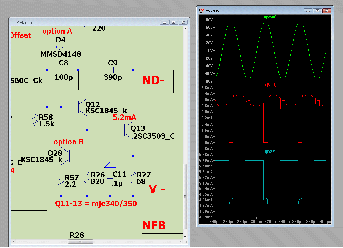

Forgot to show , if Q28's saturation characteristics match Q12's - TMC + the
transistor clamp works as well as the diode (below).
Tried to show this to Mr. Self ....who did not acknowledge this as a "blameless"
errata - then backpedaled and said "just don't clip it". Never explored the TMC
aspect , either. Good thing I don't listen , huh ?
OS
Voltage clipping , my EF3 is a VERY minimal load. But even the mA or two
that the Badger EF2 might draw at load would not be a factor.
As you see , it is the timing of the clamp that makes a difference. Either method
is quite flawless as described in self's book (typical miller compensated blameless).
Edit - both clamping methods were perfected on actual slewmaster tests with the real amp
driving real loads.
OS

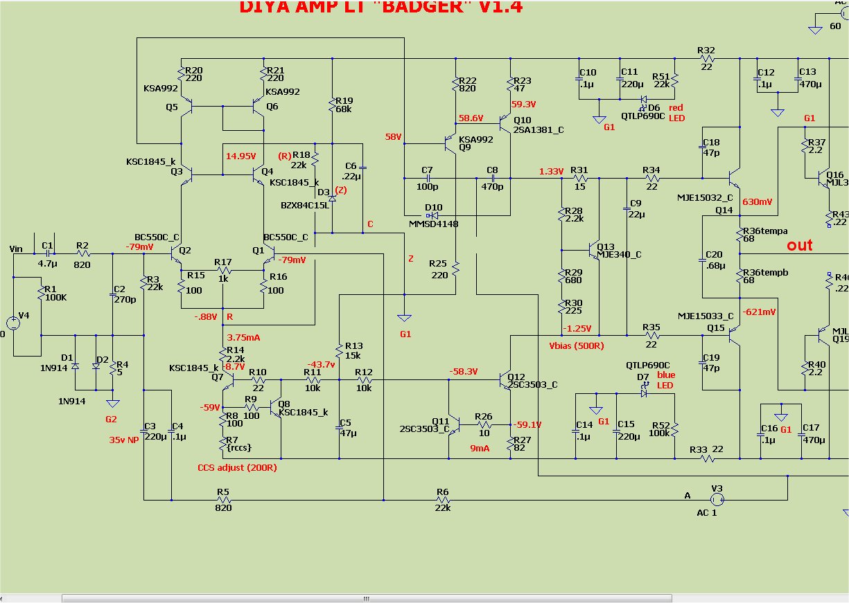

To do the badger , split R36 into two 68R -82R resistors in series. from the center
of the two , take R6's feedback signal. On the badger PCB , this would
just be as simple as each 68R soldered to the output rail.
What you have is a small amp , with just the drivers as outputs. read across Q14/15 (emitters)
OS

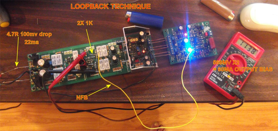

Picture = 1000 words (below)😀 .
R36tempa/ tempb keep the driver current at @ 8ma. they temporarily
connect to output. Read about 1.1V between the driver emitters ,
any connected output will be just short of conduction (safe).
You will also know the rest of the circuit works before you solder in
any high current semi.
PS - I'm about to actually do this on 2 new output stages.
OS
Here is a picture (2000 words). You can leave the badger 150R driver resistor
in , just use two 1K resistors across the 150R (R36) , (the middle of them) fed back to output.
Shown is the exact setting of what standard a NJW0281/0302 pair will require
across the 150R for 60ma per device final bias (1.138v).
Amp pictured is nearly the exact same as the badger. In this loopback mode ,
about 22-25ma per rail will be drawn. (8 ma drivers- 15ma+ VAS/input stage).
This is how I get every single one before I load the OP devices.
Vbe can be hit with the flame of a lighter of even a finger touch to see if
thermal compensation is working. All other input stage and current source
operating voltages can be checked as well. Offset can be set close , but you need
the low Z of the real output devices to finalize.
