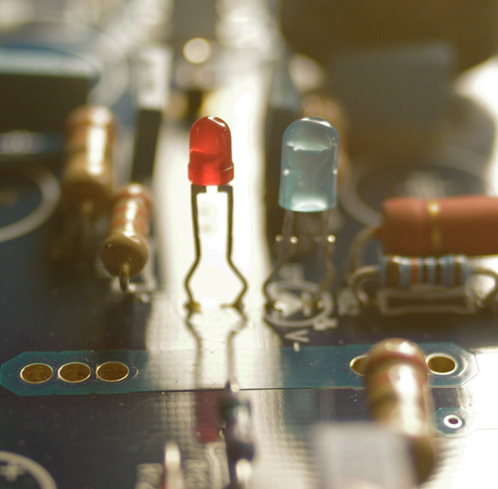

LED polarity check

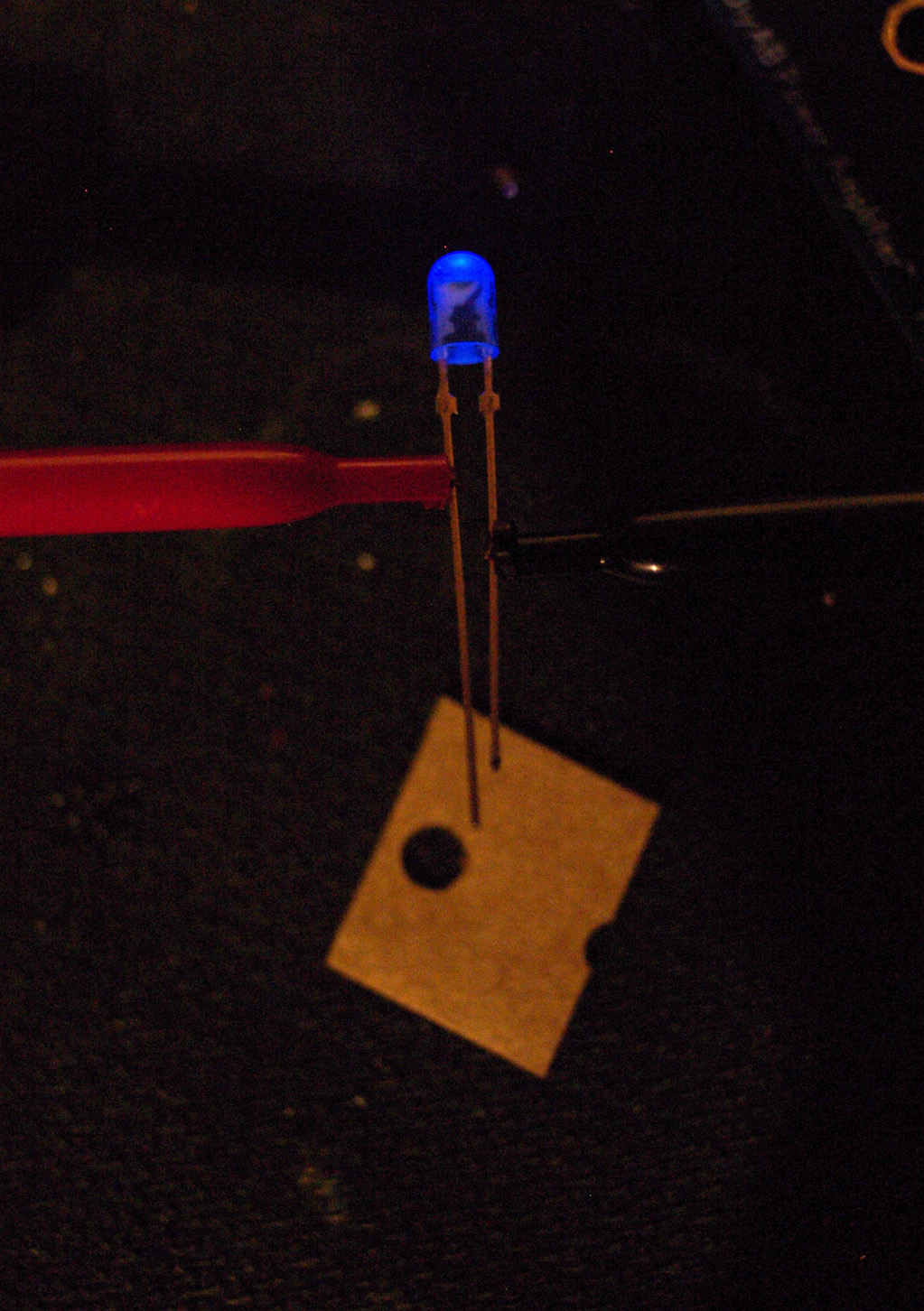

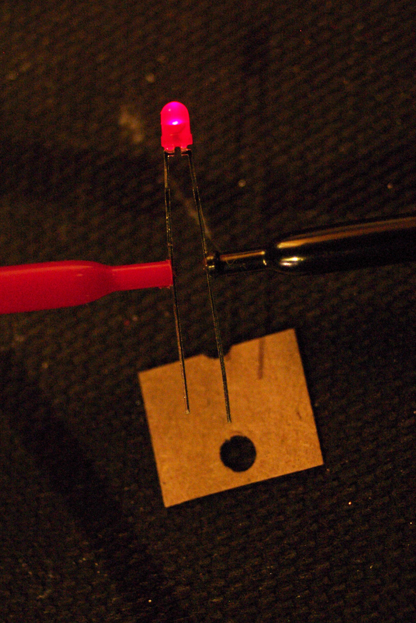

somebody help?
I was installing a red and blue LED on the HoneyBadger board being very careful of polarity as the guide rightfully suggests and it put me in a quandary…
Web guides say the long leg of the LED is Positive, smaller interior section (electrode) of LED is positive and the schematic marking for positive is the broad perpendicular side of the triangle (opposite the flat perpendicular "bar") is positive. Cool. Except my two LEDs would beg to differ.
Using the diode setting on my DMM almost none of the above is consistently true IF a lighted LED is the best indication of which end is positive and which is negative. (YES I have checked the markings on my DMM and even measured a battery to make sure things are correct with the DMM 🙂
SO, go with the lighted LED as best indicator, yes?
May I assume too the LEDs are not uniform in their construction cuz I'm going to be crazy if I don't get this all to make sense.
note: in each picture the left lead (red) has the larger electrode

5mm LEDs have a flat on the flange.
That flat indicates -ve.
My 3mm and smd leds do not have a flat.
The -ve lead connects to the big "bowl" inside the LED. A clear LED, even red coloured LEDs, allows you to see the bowl. The +ve connects to a very fine wire that leads into the middle of the bowl.
The schematic diagram shows a bar on the end of the diode arrow.
All these -ve indicators are consistent.
Big Bowl, flat on flange, black bar on arrow, they are all -ve.
BTW, your blue LED pic shows the "bowl" connected to the red croc clip. This confirms that the "conventional current is flowing from black croc clip to red croc clip.
Can you see the "bowl" in your red LED?
Can you see a "flat" on any of your LEDs?

I understand the flat...
Hey Andrew,
I understand the flat mark as an indicator (ve-) in this case they are 3mm LEDs and have none. The plastic bubble around the electrodes is colored but I can see the structure inside (see: pic). In both cases the "bowl" is the positive electrode (ve+). You can see the markings under the blue one; I have kept the LEDs in the same orientation all through all my photos to be sure I am seeing what I am seeing. The ve+ is on the left as is the large "bowl". They light up this way; it must be "correct" even though it goes against convention.
You can see the legs length as polarity determination is not holding true in the earlier photos too.
I guess all I need to have confirmed is that there is not truly consistent standard for LEDs so one must apply power in both polarities/directions to be sure.
If testing for polarity is what was said most commonly on the web I'd take it for truth but what I find most directions match what you have said Andrew (with the addition of the leg length thing)...yet my experience does not jibe.
Arrrgh.
Anybody else out there have contradictory experience like mine? As a new guy (this is my second amp build) I have a tendency to doubt myself keenly. Yet my evidence is pretty clear...to me. How about you? 🙁
For the record I am a pretty long way off from applying power to my HB boards but I have reviewed the tracings to make sure of the polarity - the board is correct. The part numbers for these two leds: blue is c4smk-bjs-cq0t0352 (mouser) red: 160-1035-ND (digikey).

The large "bowl" on the left of your LEDs is connected to the more negative voltage to allow current to flow.
A diode that is BLOCKING current flow takes the -ve lead to the more positive voltage.
An LED passes current to light up. It needs the -ve lead to be more negative to allow that current to pass.

Test your LED with a 9V pp9 and a ~2k2 resistor. It will flow ~3mA and do no harm. Once you have convinced yourself, go back to your multi-meter and determine which lead is +ve and which is -ve.

Bless you Andrew for your patience. I am an artist by disposition and a teacher by trade so I have a weird mix of logic and not. I TRY to imagine electrons racing around a schematic but I'm a long way from being able to predict where they actually go. You post helps. Thank you.
Thus what I am trying to do here is build something then without a complete understanding of how it works. "Just enough information to be dangerous" don't you know... And if I thought I was alone in this universe of dim understanding I'd shut up and not ask silly questions.
Nor am I surprised that info posted on the net is contradictory 🙂 What I am hoping for is a way not to screw up building this thing I don't fully understand: the Honey Badger and all future things I might want to attempt. I want to follow directions!
So, to assist all those out there who are like me, trying to learn by remote how to do something useful I am trying to get to the bottom of a perplexing thing (for me) a lack of consistency in how a gizmo is connected to its PCB: a simple LED.
It seems to this novice that the cathode of an LED must be connected to the NEG or ground for an LED to work, right? 🙄 I should put the cathode into the PCB at the "bar" end of the symbol...
Yet the cathode (the bowl or larger electrode in my red and in my blue LEDs) is connected to the positive lead on my DMM and the LED lights up. This would indicate to me to install that larger electrode, that cathode (cathodes seem to be consistently marked (-) right?) into the board where I have, at the base of the triangle of the LED symbol (this is the anode side of the symbol!)
Am I just NOT understanding how my DMM works?

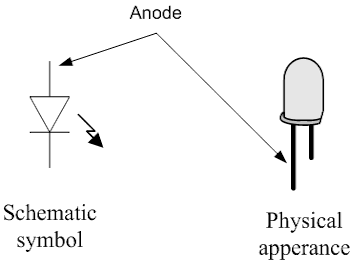

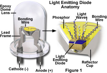

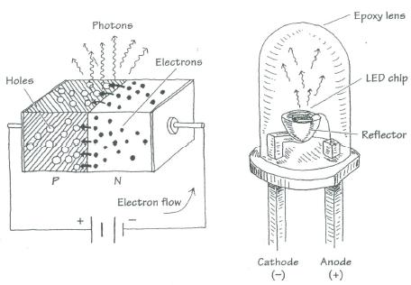

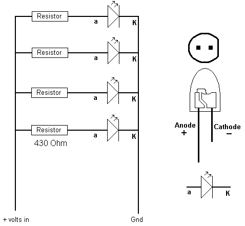

I have included some of the inconsistent images I have found of LED construction/designations; I have not found the LED symbol itself to be inconsistently labeled for cathode and anode so I trust that.
I'd like to just insert the longer lead into the anode end of the symbol but no can do: my two LEDs do not match for how they light up, one lit with the long lead to red (ve+) of my DMM and the other lit with short lead to (ve+).
I'd like to look into the construction of an LED and know which electrode to put into the "bar" end (cathode end) of the symbol. If the larger electrode is the cathode (-) then I could put that end into the PCB at the "bar" end (cathode end) but... then why do my LEDs light up when that larger electrode (cathode?) is connected to the red (ve+) end of my DMM? (Obviously I cannot use the short leg theory and in this case there is no flat to indicate cathode).
Forgive the iteration, I'm just looking for a rule. If the dern thing lights up, insert the lead that was on the red clip of the DMM into the anode side of the PCB symbol right? And forget about construction, lead length etc 🙁

we're all right, some LEDs ARE reversed
OK guys, I am convinced I am not crazy nor are any of you who thought I was…
I tested a few other types of LEDs I had on hand that I never used because I found "better" (brighter). They are 751-1139-ND (digikey number) , VAOL-5GDE4 (mouser) and 593-VAOL-5LDE2 (mouser) and a fourth type I got in bulk from a friend. All of the above tested as you would expect and is most commonly posted with the larger electrode functioning as cathode.
I went over this three times this morning checking both with a battery plus resistor as Andrew suggested and with my DMM. The two I originally posted are the odd ducks and work in reverse!
Dang! How did I get so lucky :-( to pull out a pair like that?
So, I'd hope no one else gets ahold of odd ducks. blue is c4smk-bjs-cq0t0352 (mouser) red: 160-1035-ND (digikey) Of course, there may be more 🙁
Bob Ellis had it right, short and sweet: if it lights up you're not crazy!

As for LED's, routinely, some LED's are internally backwards. Except, usually, the clear body Red, Orange, Yellow are not backwards. However, it is highly likely for anything else to be backwards, especially phosphate coated lighting grade LED's--Those are always backwards from classic red/orange. And all of the markings, yes, also backwards. I just checked one of my lighting boards, which have 2 cool white, 1 warm white, 1 orange to simulate normal (and 3+3+3+2v=11v=minimum waste on a 12v supply), and anyway, the internals of the orange are visibly opposite orientation, because the rest are backwards. They're supposed to be.
