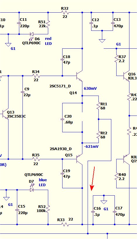

I am trying to be very, very careful with this Honeybadger build so I am asking what OS had in mind within his build guide (DIYaudio Class AB amplifier - "options.txt") for a sort of "pre-test" of the drivers to keep from blowing up the outputs accidently upon start up.

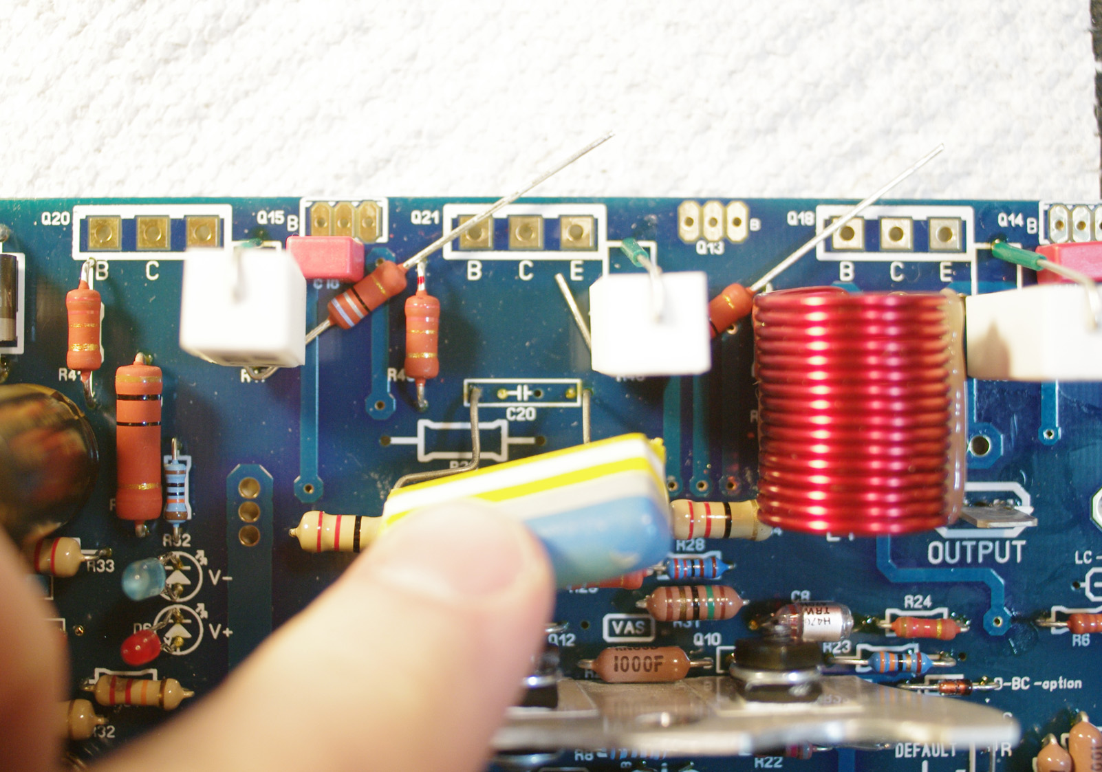

IT says in that text found under --general construction tips --point C, : "Build the amp totally EXCEPT for the output stage TO-3P/TO-247 devices, DO NOT solder in R36. Instead temporarily solder 2 - 68R reisstors between R40 and R37 and the long output trace that is hooked to L1."
Pictured are a pair of (at the moment) unsoldered 68R resistors running from R40 and R37 to a lead of a 0.22R that is soldered onto the large via that L1 is soldered to. I think this is right. If this is what OS had in mind please indicate. I'm not adventurous and my understanding is slight...
Also in point C, it says: "When powering up for the first time either use the 2 fuse safety resistors (R53 and 54), or solder 2 "sacrificial" 10R 1.4-1/2W risistors to the V+ and V- terminals (after the fuses)."
___To be sure then, it means the boards will work and be safe with nothing in the fuse holders if the R53 and 54 resistors are soldered in? R53 , R54 are 22R; this seems like it might change the readings/power - it seems like the fuses should be in place too...
Later in the same point C, it advises: "Adjust R30 for +/- .55V "on" resistors R34 and 35...output should just be a few millivolts."
____Should "on" resistors say "across" resistors R34 and R35?
As a complete neophite I need to be sure where to place my probes for the reading. To me "on" means to clip red to the resistor (and which end is at question to me) and black to ground..."across" means to clip both probes to the ends of the resistor. I told you I was unsure/new 😕
___I have the same kinda worry for the last sentence: "...output whould be a few milivolts" ___This means to me, clip (red) on to the "output" fast-on (and black lead to ground) to read mV?

(below) is what I meant.
"RT1 / RT2" form a small class A amp and the center point is fed
to the output - feedback resistor.
In this form the amp will draw just 40-50ma per rail (If that).
Emitters of the 2 drivers can be set to .5 - .6 V (each - 1.1-1.2v total)
referenced from output.
when you do put your output devices in , they will be underbiased.
And , unless they are defective ... they will not burn up !
OS

If you want to go this way then do not solder in R36 (C20 may be in or out). Solder 68 resistors between emitters of Q14 and Q15 to the output path. Get rid of R53 and 54. These will catch fire if fuses blow. You do not wat it happen with your boards mounted in a closed case. Instead of fuses solder 10-12ohm 1W resistors. Before applying power with your PS in series with 100W globe set multiturn pots as recommended.
After applying power set current to LTP to the required value. I have ss9014D so I set it to 3.2mA (voltage drop across R14=2.2k is to be about 7.1V), then set offset to ZERO (R17). Now turn R30 to get voltage drop of about 1V to 1.1V (no more than 1.1V) across both 68 ohm resistors, that is between drivers' emitters - Q14 and Q15. I was happy with 1.05V. Voltage drop across R34-35 should be ZERO.
If you use 2sa transistors as drivers with Hfe of 150 plus change R29 to 560 ohm. You may also change R12 to 6.8k and R13 to 6.6k - 8.2k. I have 7.5k for R13 and C5 is nominal 100uF/50V (actually 90uF measured). I have also reduced R2 to 221 low noise and increased C2 to 470-560pF. R24=1.2k, C7=82pF and C8=390pF. But do all that before tests.
If everything is fine, globe dimmes to blackness, temporary resistors did not catch fire then keep it on for 10-15 minutes, disconnect, desolder temporary resistors, solder in R36, C20 and power transistors, place fuses in fuse holders, check boards for soldering problems. If none and heatsinks bolted to transistors power up the module via a 100W globe and see what happens. If there is no fire, trafo is quiet, globe dimms check current to LTP, then zero offset and finally set bias to read about 15-18mV between TP1 and TP2. If your emitter resistors are .22 ohms. Keep the amp on for 20 min, check if readings do not exceed 18mV and disconnect. Remove globe from the line, plug in again and redo the settings with bias now to be about 50-60mA. I set it to 60mA (26mV between TP1 and TP2 with 0.22 ohm emitter resistors).

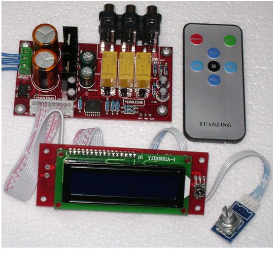

PGA2311
There are 2-3 vendor's for these kits. (below)
I think the >59$ one has the better PS/layout.
They spec out REAL good (google the PGA2311).
I am willing to try this for one of my amps (either badger or slewmaster).
😎😎 remote + digital readout ...
OS
