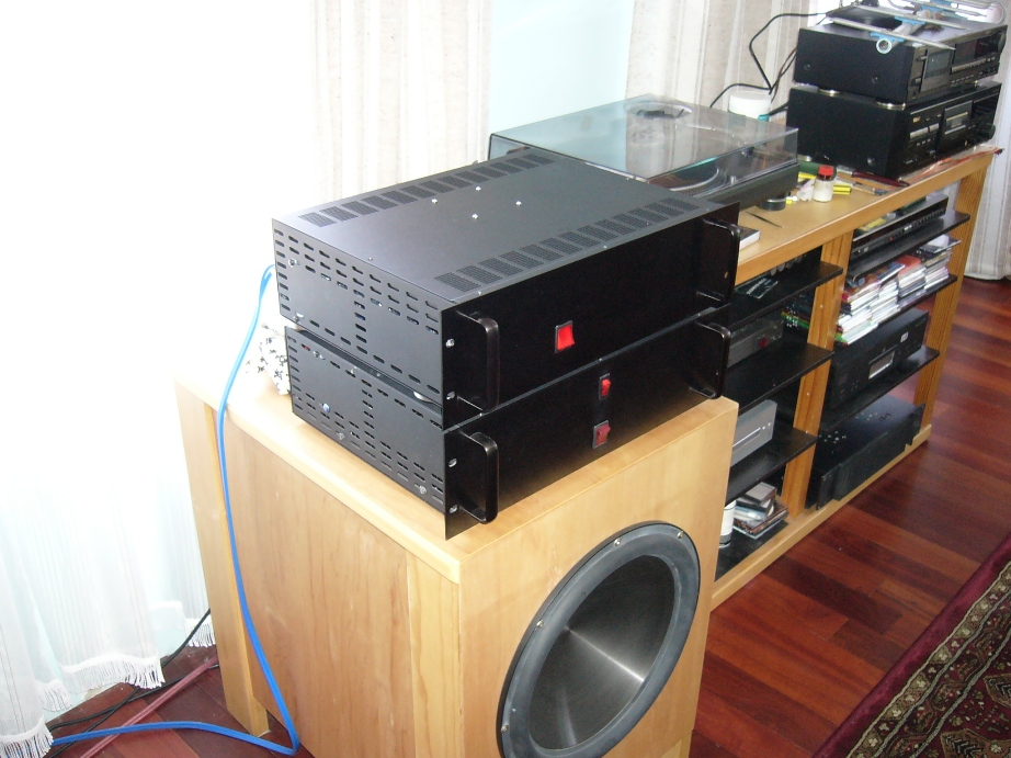

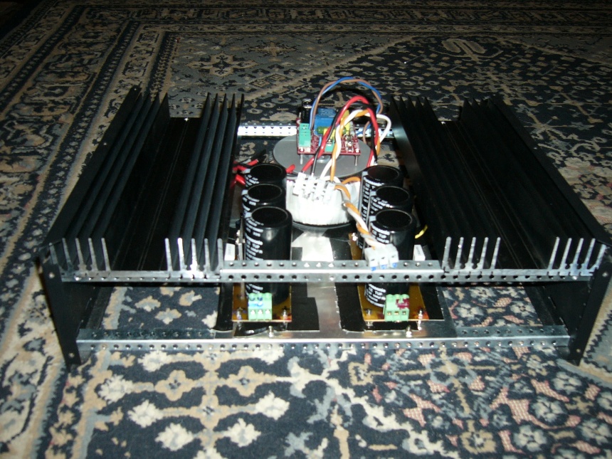

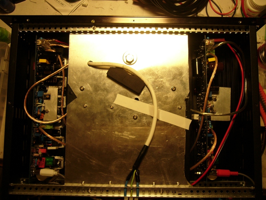

Three pictures of my first HB unit. There will be at least one more like this one.
It's a terribly compact case. Speaker protection is bolted to the upper cover above and between PS caps.

OK I'll install sink before doing anything more. what is the purpose of R53and 54, the 22 ohm resistors to each rail. looks like they would only come into play if fuses go out.
Yes, OS calls them safety resistors. I call them board burners. I would leave a space between them and the board is you use them. If the fuse blows, they will probably burn as well, mine did.
