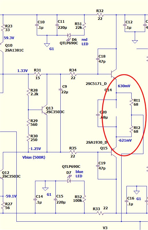

Question about OS construction notes
If anyone can help clarify some instructions, I'd be very happy.
Instead of focusing on my one not-yet-functioning amp, I'm trying to attempt the power-up sequence/method proposed in OStripper_notes.txt. Specifically I've managed to get 2 amplifier channels each running with output transistors Q16-21 and R36 uninstalled, but with a 68 ohm resistor between the C and E pins on Q20 and similarly between the C and E pins on Q17.
With this setup I feed in a sine wave and see an amplified sine wave on the output!!!
I have a bunch of DMMs and a scope. So far I've adjusted R7 to get 8.25 volts across the two R14 leads, so I think my CCS is good. I see around 0.5v on each of the 22ohm input rail current measurement resistors R53, an R54. I see about 2V across C9 (i.e. between R34 and R35).
Since I blew out fuses and fried my output transistors on an earlier attempt, I'd like to know exactly what to do with the R30 bias adjustment before installing the output transistors, R36, and the fuses). OS suggested "adjusting R30 for +/- .55V on R34 AND R35". Does this mean .55V across the two leads on R34, and then 0.55V across the two leads of R35, or does it mean 0.55 volts across C9 ? Is this with or without R36 installed? When I adjust R30, I don't see more than a couple mV on either R34 or R35, and I see 2V between the two resistors (i.e. across C9).

what do you mean .... R36 uninstalled .... leave it open circuit .. or .. short circuit with a piece of wire ????
I left it open, no jumper in its place. Also, I had a typo earlier. To bypass the output stage I put a 68 ohm resistor between the B&E pins on Q20 and Q17.
Also, FYI, this is the OS note I was referring to:
C. Build the amp totally EXCEPT for the output stage TO-3P/TO-247 devices, DO NOT solder in R36. Instead temporarily solder 2- 68R resistors
between R40 and R37 and the long output trace that is hooked to L1. This will turn your drivers into the outputs !!! When powering up for the
first time either use the 2 fuse safety resistors (R53 and 54) , or solder 2 "sacrificial" 10R 1/4-1/2W resistors to the "V+ and V-"
terminals (after the fuses). Adjust R30 for +/- .55V on resistors R34 and 35 ... output should just be a few millivolts. This will insure
that the outputs are non-biased when they are installed.

up to this point looks good ... then set R30 ( output bias 500R ) to ge MINIMUM voltage across C9.
With the pair of 68 ohms in place you should have amplification ( output signal ) an be able to get bias set for LTP (Q2 Q1 ) and correct voltage across R14
You should also be able to set mean output voltage to zero ( ajusting R17 ) to get zero volts at output terminal ( measure with your voltmeter set on DC VOLTS ) with no signal at input .
Temporarily replace (tack) 2 68R's from Q14/15 emitters INSTEAD of R36 (150R) to the main OP inductor (or any point of the output trace).Does this mean .55V across the two leads on R34, and then 0.55V across the two leads of R35, or does it mean 0.55 volts across C9 ? Is this with or without R36 installed? When I adjust R30, I don't see more than a couple mV on either R34 or R35, and I see 2V between the two resistors (i.e. across C9).
This will have the drivers create .55 - .6 V across each of these 68R's
(1.1-1.2V total).
This voltage is about where your typical OP device will start to conduct.
.... 2V across C9 is also correct ... 🙂
If you are "gunshy", replace the 150R and just solder in one tested pair of
OP's. You will be slightly underbiased , decrease trimmer resistance to
get 12 mv at the OP re (.22R) ... all your remaining OP's will be the same.
I use this technique on ALL my OEM amp repairs. (below) is example schema.
