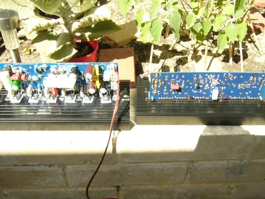

Anyway, this module worked for quite a long time with current limiting globe in the circuit and no oscillation manifested itself. It also worked well for a few minutes without the globe and then suddenly it burned.
As I do not think that amp's output was shortened it looks that there was sudden huge oscillation burst but why and where in this circuit oscillation originated?

Thanks for you comments. Fuses burned and the resistors caught fire, the mains fuse did not burn. I checked mica washers, perfect condition, drivers tested, good, no leakage, bias transistor perfect. Three surviving MGs are good and have exactly the same Hfe as before.
This module was the first I built two weeks ago so I was switching it on and off a number of times to see how it behaves before I built the second unit which is a touch different. It has 120 ohm between driver emitters, has 560 ohm instead of 680 i bias circuit as recommended by os as I use matched 2sa1430/c5171 as drivers rather than mje15xxxs.
So the puzzle is unsolved. Either short or massive sudden oscillation.

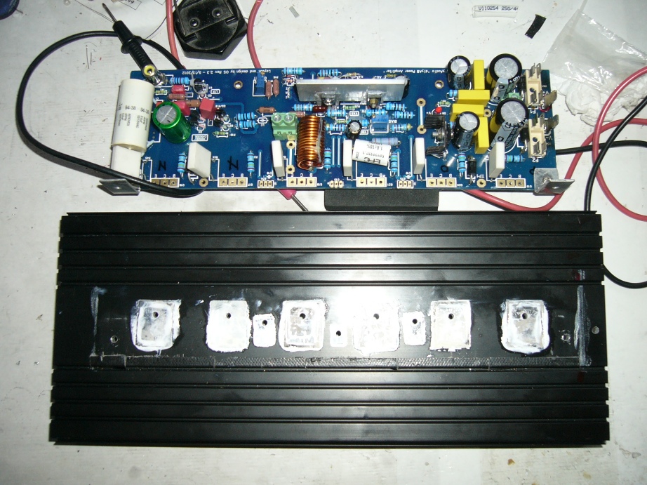

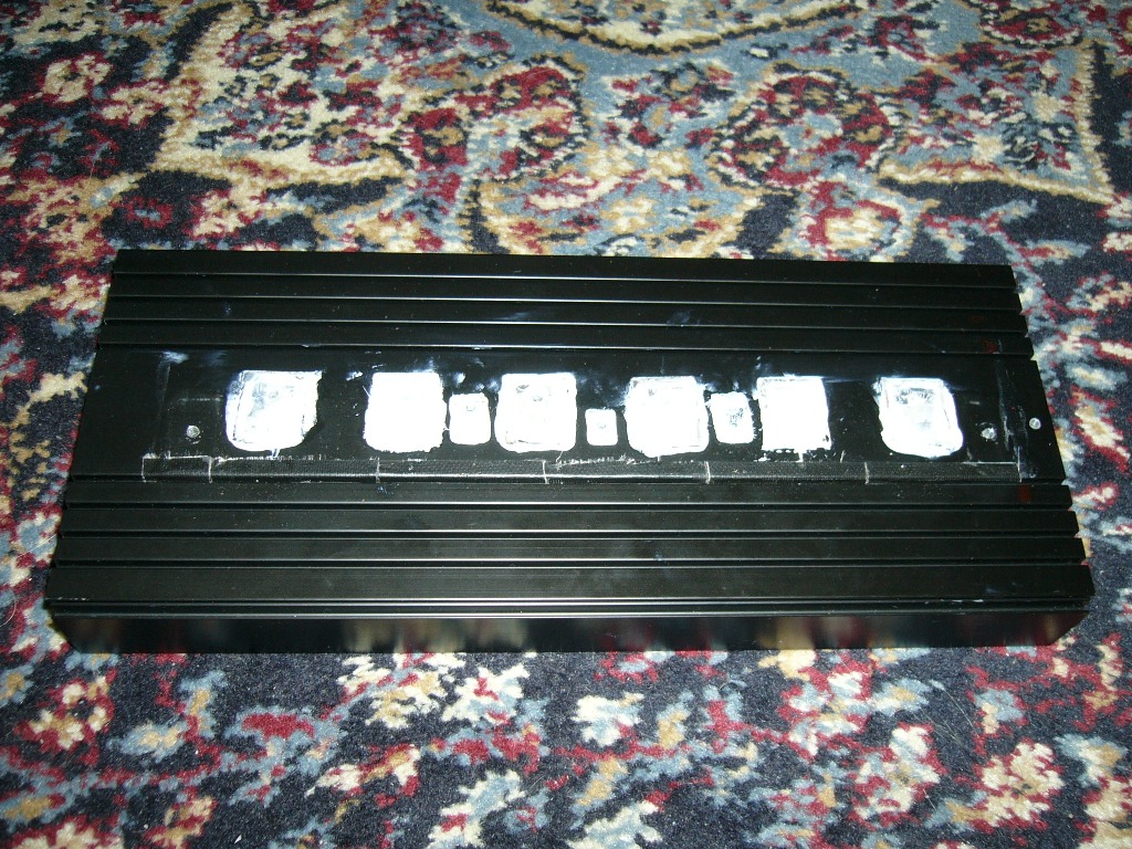

That would be nice if it was a case of poorly tightened transistors. I think they were well tightened but there is a slight chance that one or two were not perfectly tightened and actually only two burned not 3 as I thought before.
I'll post a picture of the heatsink with mica washers still on it when I get back home from work. Two of these micas have more paste under them than the other so they were somewhat less tightened. Nevertheless, would that be enough to burn a transistor at only 60mA fed to it?
But I had a loose bolt on Q10 (VAS). This bolt somehow got loose but that was well before I soldered in power transistors. I noticed that when powering up for an initial testing. Luckily this transistor does not draw much current and probably could operate without a heastink. After 20 minutes testing its part of the heatsink is cooler. The other two VAS transistors (Q11 and 12) do all the heating as I have reduced R12 to 6.8k, R13 to 7.5k and and added 68uF to C5 so now it's 110uF on this board. The other board has nominal 100uF which in reality is 90uF.

Pictures of my HB modules and of the burned one with heatsink andmica washers. Difficult to see clearly but two washers have more paste underneath than the other four. Maybe it's a clue but would these transistors burn with 60mA bias?
cheers,

Looks like a bit of excess goop may have contributed. You want just enough to fill the surface irregularities but not so much to keep the mica from mostly contacting the heat sink. Goop conducts heat better than air, but not as well as mica. Use just enough goop to get a tiny bit of squeeze out around the edges. In the second picture the two end devices look like they almost squeezed out enough out, the others have significant excess. It may be the glare, though. The mica should look almost clear with no air bubbles under the contact area of the device.
I use a cotton swab, touch the goop in the tube lightly and wipe that little bit of goop on the surface of the device and heat sink side of the mica. You'll likely be surprised surprised to see how little goop is needed to get the surface fully covered.

OK, point taken. So it looks that I applied too much paste and did not squeeze out enough of it but would 60mA kill MG6311/9411 even without a heat sink?
cheers,
At 60 mA and 60V rails you've got less than a watt - even a TO-220 device should handle that much power without a heat sink.
It could be oscillation or some other cause of high current. I had an open in the Vbe multiplier circuit of one of my Leach amps and it drove the outputs to high current as expected . Perhaps there was an issue with your bias transistor circuit - heat causing a solder joint to open up or similar.
Soldering was perfect and neither the bias control transistor nor drivers were damaged. I inspected the board a few times since then. Nothing caught my eye. My first thought was: "oscillation" so I also checked drivers and their mica caps and desoldered these as well but they were OK.
So it looks that it was some sudden oscillation burst or some other cause as the amp behaved very well for quite a long time when it was plugged in in series with the globe. Globe would start to glow if something was happening but it did not. It was almost black and STABLE each time. So there was no oscillation then and there was no signal applied, which could trigger oscillation when it happened. If it was oscillation some part within the amp had to trigger it but which one?
V-I limiter would prevent burning of the output transistors but still there is the same question: what caused it? Oscillation or something else?
