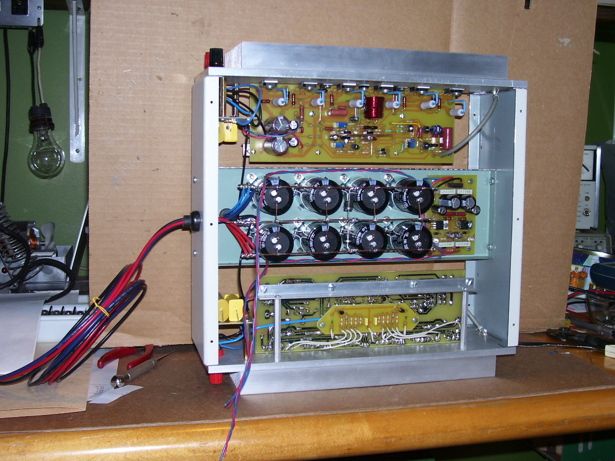

Problem I have this time is that my case is relatively small and when organising space within it I forgot that in this particular case the front panel has got "sleeves". On the positive side it holds the heatsinks but on the negative is that I have to remove not only the top cover but also the front panel to get the modules out and I have to take them out to do anything on them. In all my previous amps cases were not limiting access. It was enough to remove top and bottom covers.

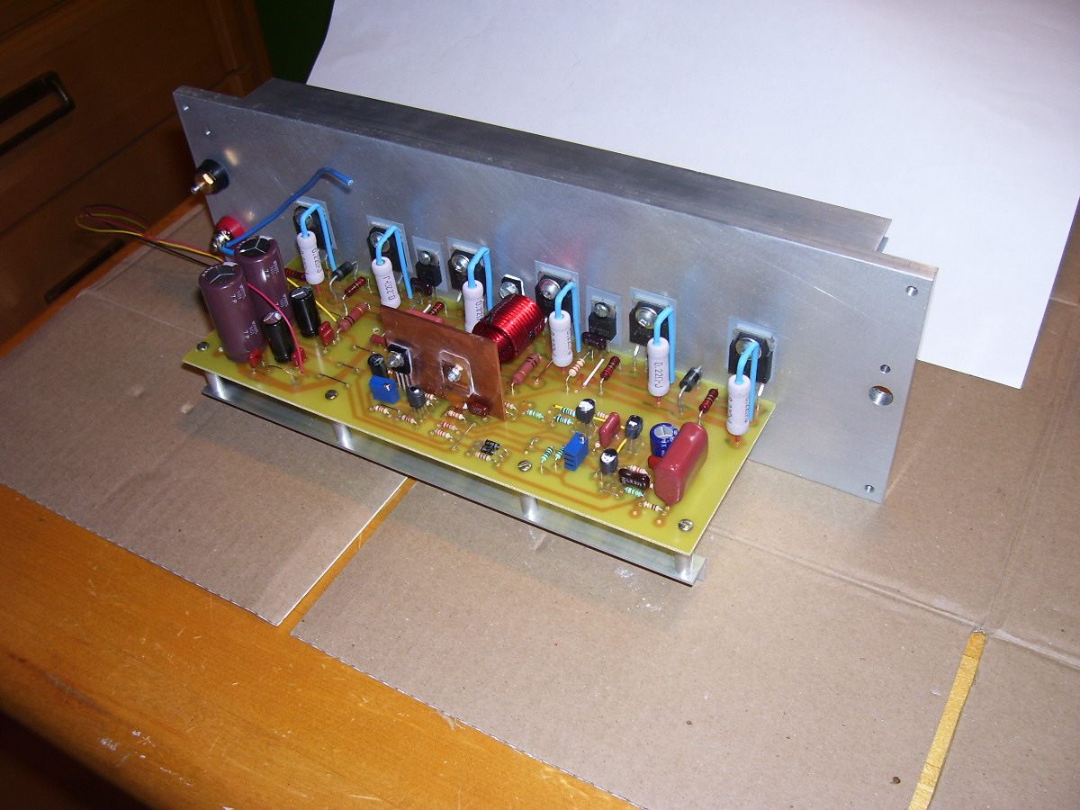

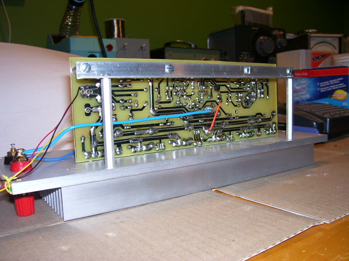

OK, I plugged my HB modules to the mains without a globe. The first module behaved perfectly well. After adjusting bias to about 65mA, offset and LTP source current I left it on for a few minutes, disconnected and connected again for about 15 min checking bias all the time. It was holding well (variation of +/- 0.2mV between TP1 and TP2, emitter resistors of .18 ohm).
The second module also behaved well. I checked LTP source current (about 3.25mA as I have ss9014d), then adjusted offset to zero, set bias to 65mA or so, measured AC at the output. It was a few mV but module was out of the case. All that took a few minutes. And then suddenly toroid started to hum, two resistors parallel to the fuses were ablazed, fuses burned but the mains fuse did not. Heatsink got warm but not the zoebel resistor. All symptoms of shortening the output but I don't think I did it.
Component check showed three MGs shortened, two Ns (6311) and one P (9411). Drivers nor the bias transistors were burnt. I removed all power transistors, drivers and bias control transistor as I have plenty of these. The board and components look fine except for the blackened area of burned resistors. The question is what happened?
And how to avoid such problems?
cheers,
If I understand you correctly, R53 and R54 burned? Those resistors can't burn if the fuses are good. The fuses short those two resistors. If I had to venture a guess, I would say you had a short to the heatsink on one of those output transistors. Check to make sure you didn't get a metal filing between one of them and the heatsink that might have pierced the mica insulator. That will often take out the drivers as well.
Thanks for you comments. Fuses burned and the resistors caught fire, the mains fuse did not burn. I checked mica washers, perfect condition, drivers tested, good, no leakage, bias transistor perfect. Three surviving MGs are good and have exactly the same Hfe as before.
This module was the first I built two weeks ago so I was switching it on and off a number of times to see how it behaves before I built the second unit which is a touch different. It has 120 ohm between driver emitters, has 560 ohm instead of 680 i bias circuit as recommended by os as I use matched 2sa1430/c5171 as drivers rather than mje15xxxs.
So the puzzle is unsolved. Either short or massive sudden oscillation.
