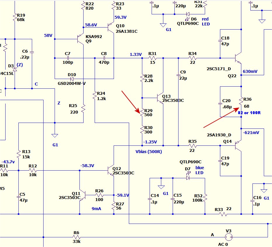

One problem solved but another appeared. As PS is OK I have connected the first amp module without power transistors. Instead of R36 and C20 there are two 68 resistors from emitters of Q14 and Q15 to the output line. PS connection is done through two 12 ohm resistors.
PS voltages on the amp's rails are +/-64.37V (difference between - and + below 10mV). Voltage drop on R14 is 7.5V and I set offset to 0.7mV. Then I started to adjust bias as ostripper recommended to get about 550mV drop on R34 and R35 which gives about 25mA to bases of Q14 and Q15.
And here I get a problem. Reducing resistance of R30 does not do almost anything. On R34/35 I got a drop of 1.2mV at one point and then it stayed at this level until the end = ZERO on R30 (shorted).
VAS transistors on aluminum plate get pretty warm, Q13, 14 and 15 get warm but not very, Q7-8 get warmer than Q13-15. No change in other voltages. Globe is not emitting any light.
Changes I made are in VAS transistors and resistors as recommended by os: R12=6.8k and R13=7.5k, while C5=110uF. I do not have 2sc3503 so Q13 is ksc2690y, Q14 and 15 are Toshibas 2sa1930/c5171 with 30pF micas. VAS transistors are: Q9=2sa970bl and Q10-12 are 2sa1209s/c3211s.
VAS is warmer as it gets more current in that configuration but why bias setup circuit does not work?

ostripper,
Wouldn't it make more sense to get 550mV drop on C9 (between R34-35 or bases of Q14-15 or emitter-collector of Q13) or across these 68 ohm resistors???

Looked at your problem.
The combo of those drivers + the increased VAS I , brought you
beyond the range of the Vbe. That's all.
Look below - I have your sa1930/sc5171 models.
Much higher gain with these drivers .... in fact , so much gain/Ft - 120-150hfe
(triple the MJE's) !
You could run your VAS at 4-5ma as your driver/OP setup has
almost EF3 type current gain.
lower R29 and/or R36 (68-100R) as shown.
PS - you might need to go R29 (470R) to get to the middle of "Vbias" (250R) with those
drivers.

Thanks ostripper,
My 2sa/sc drivers have Hfe about 150 at Ic=2.5mA.
OK, I'll solder another resistor to the other side of the pcb to get about 470 ohm on R29 and reduce R36 to about 100 ohm but at the moment R36 and C20 are not in.
Once that is done what voltage drop should I set across R34 (and R35) without power transistors in to safely power the amp when my output MGs are in???

R34/35 are the basestoppers for the drivers ?? No voltage drop.
R36 can be a good test point use 2 33-47R temporarily soldered to the
pads .... derive NFB from in between those 2 resistors.
Adjust the bias to get .5 -.6V from NFB to the emitters of the drivers.
(1.0 -1.1 V across driver emitters total)
At this point , a pair of OP's connected will be unbiased (not conduct).
trim the bias ... ON's start conducting at about .6+ V
PS - if you mean the voltage between E-C of the Vbe ... it should be 2-2.2V ,
properly biased OP's - about 2.4V. This is dependent on driver/OP type.
