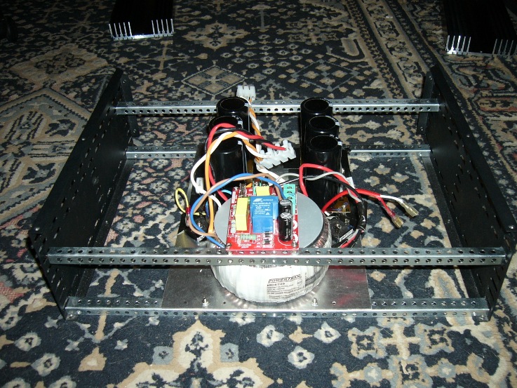

My PS for HB (attached) gave me a puzzle to solve. Yesterday I powered it up via a globe and soft start and everything worked fine. I switched it off and switched on again and suddenly my 75W globe is shining brightly. So I switched it off and it appeared that coil in soft start relay was burned.
I replaced soft start with another module, powered it up and the globe is shinning brightly again. This time coil is not burned. I disconnected capacitor banks and bridges, switched PS on, globe stayed dark and toroid gave me 2x47AC no load which is fine. I reconnected bridges, the same thing, all is fine and on each bridge I get about 44.5V DC (- to +), which seems fine.

can you post pictures of your setup?
the glove should lit up and then extinguish after a while,
if it stays on, then something is definitely wrong,
perhaps a mistake in the wiring..
your schematic is fine but in actual wiring,
you could have made mistakes...

Definitely something went wrong for some reason. This PS worked fine within the first test lasting a number of minutes. It only sudenly failed when I switched it on for the second time after switching it off. Nothing was really changed in between tests except for the switch connection but the switch is OK. I'll post some photos when I get home after work but I do not know if they will help.

are you using a soft start circuit? is you power traffo a toroid?
what is the purpose of the resistor and diodes on your rails?
Thanks AJT,
Soft start switches the toroid on after a few seconds. Resistors on rails form CRC circuit and diodes take over for higher currents - see ostripper's PS for HB.

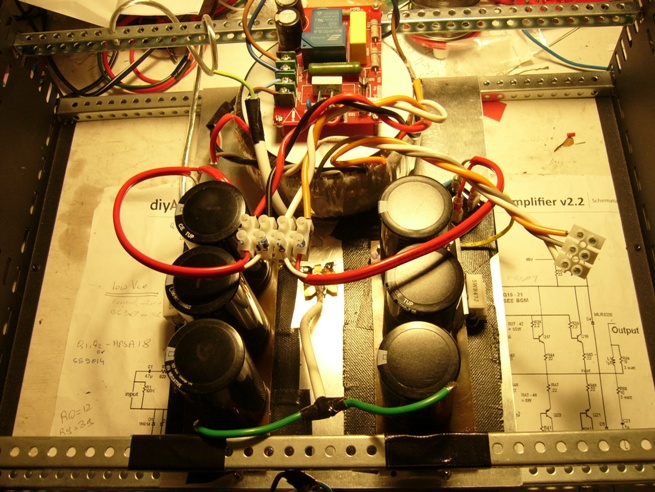

I tested everything again. Each bank of caps connected to its bridge works fine giving about 64V. Problem appears when I connect positive (+) and negative (-) of these two capacitor banks together to form the common ground. Then the globe is on and the soft start does not switch on. But it worked before and it should. So something went wrong but what?
I may try a standard solution: one 50A bridge, secondary windings centre to the ground but again positive and negative capacitor banks' rails have to be common and connected to the common ground.
Before that I may also try connecting the common ground point, which is on the chassis, to the mains ground and see what happens.
Any ideas? Are there any known problems with this kind of PS?

PS a few images attached, these green cables are to connect both banks to the common ground,

definitely a wiring mistake, i also used the same psu topology as yours in my badger build,
i did not use a soft start board....only a speaker protector board....
perhaps if you can have someone look at your work he may be able see something that
you might have missed....the picture you posted is no help to me either, sorry...

I'll ask a friend of mine to take a look at it during the weekend but I do not think there is any wiring error as it worked without any problems and nothing has really changed since then. The only difference is that soft start switch is now hard wired, while before it was connected to a switch, which might have created this problem but I have no idea what happened.
Theoretically, there may be a problem with my soft start unit but I checked all its components. With caps centre rails connected to the ground it does not switch on. I have such soft start unit working perfectly well switchin on two 300VA toroids. Toroid in this PS is 500VA.

EDIT; After looking at the pictures, with the softstart circuit mounted on top of the torioid I wonder if maybe he has created a ground around the transformer. Make sure that there is no ground connection formed to the transformer mounting bolt.

Two things I can think of to try/test. First is to measure between the two banks of filter caps without them connected together. The second thing is to try reversing the secondary wires from the transformer on one of the bridges only. It may be that you are out of phase.
In the pictures it looks like the soft start in bolted directly to the torioid mounting washer on one end and the chassis frame on the other. If the mounting bolts are electrically connected to each other that would cause loop. Just something to check. You did say that it worked before you installed the soft start. Easy way to check is to remove the mounting bolts on the soft start and see if the problem goes away.
