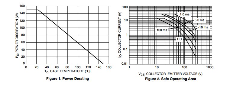

I've run car audio woofers with the badger. Even at the higher rails and WITH
the "iddy biddy" NJW's. BTW - just 2 pair !!! never blew them.
The trick is , just use normal musical content....
20hz will be about 40ms total , each set of 3 npn/3 pnp will see 20ms or less
full current.
At 4R , the amp would heat up (mine did !) ... here you have to factor in
the thermal de-rating of the soa.
About 15A (3 pair) at room temp (50ms soa at 60V) , derated 1/3 at 60c (10A+) ,
that is real hot (you should shut down at this point).
But that is a sustained (test)signal .. music (even techno), will not be a
full 2V sustained input signal.
Larger outputs would even have a larger safety margin at 4R.

Most you could get with a 35-0-35V trafo is about 52V rails. At 100V p-p ,
12A for 20ms(below). The NJW (3 pair) soa is about 17-18A (60C -20ms).
With a large heatsink , normal music content ... the amp would not "strain"
at all.

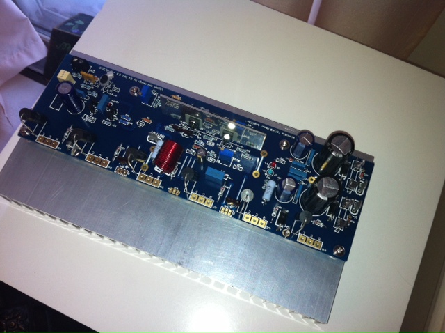

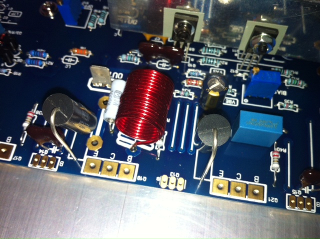

Having never hand wound an induction coil before, does the end result
comply with the design intent? The project is nearing completion, output trans to go in then a lot of double checking before the first power up.
Very nice! Non -inductive OPS resistors , perfect inductor (nice Hi-gauge wire).
The VAS heatsink will be good for summer "party duty".
Many years of "hard service" ahead. 🙂
OS
