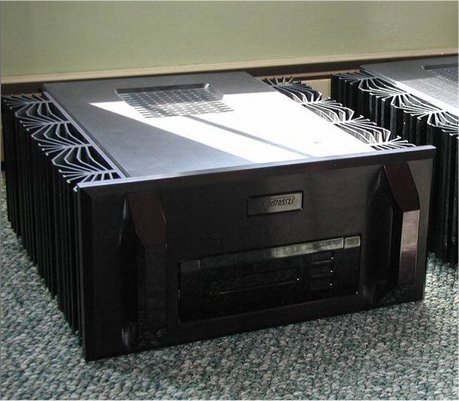

What you described was larger than the full genesis heatsinks I used on
the first badger with 4 pair. I eventually halved the heatsink (it was in
2 parts).
So I thought it safe to say your full size would be "overkill".
The half genesis HS was 100mm X 175mm X 175mm.
(below 1) ... I could never get more than "warm" with 4 pair NJW X2 in
40C hot tennessee weather with just 1/2 the heatsinks you see in
the picture.

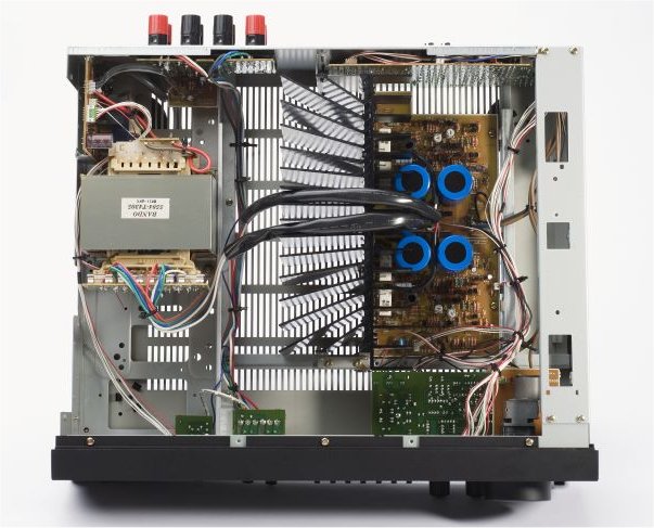

If you look to an OEM (below 2)- 4 pair (2 channel) on a 80 X 80 X 140mm. I own it...
barely gets warm with 2 pair 8R (speakers) cranking all day.
Use the photo's or my approximation of the sizes to judge what 3 pairs
would require.
PS - this is where the source comes in ... I am quite sure that I could really heat
either amp up with a continuous full level sine !

Another point to make is output device selection.
ON/fairchild devices perform best at 60-80ma ... they run "hotter".
The second amp I just described uses "ring emitter" Sanken Op devices.
These have a recommended quiescent current of just 30-35ma , this
is how the Japanese OEM's "get away" with using such small thermal
solutions.
My badger has twice the heatsink , but idles at the same temperature
as my H/K !
PS - you could use the Sanken outputs on the Badger 🙂 ... They are reasonably
priced and some say they are more "musical".

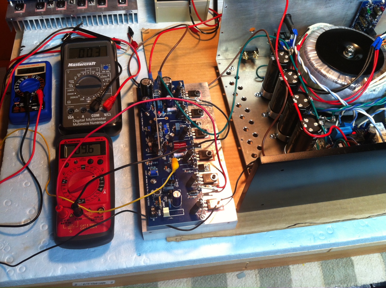

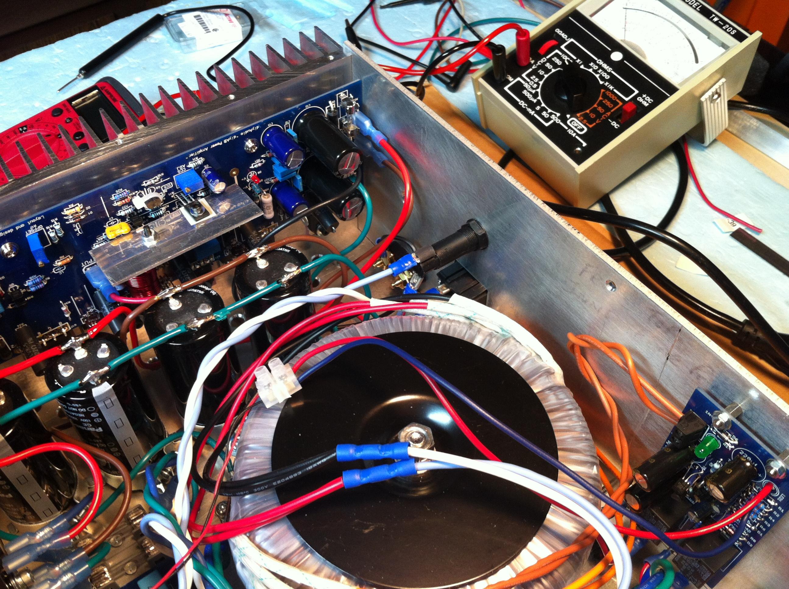

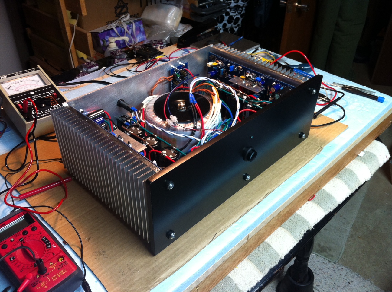

The "big" power up happened today, rather anticlimatic (which is a good thing).
Both channels have been running for a couple of hours, bias is set at 25mV and stable, dc offset below 1mV. Heatsinks are mildly warm, certainly way cooler than
my NAD 326 runs at.
Question is now, when can I hook up speakers and try some music?? Is there any other pre prep I should be looking at.
My build is, as per the BOM using the digikey #'s. Q1 and Q2 decided to go with
SS9014 as I could acheive a better matched pair, and there was talk about
instability with the MPSA18. Out of 6 I had on hand I couldn't get two to match
closely.
I must say, there are numerous people on this forum that have helped (unknowingly to them) with this build. This is by far the largest electronic project I have ever undertaken, and I fear has opened the door to more.
Thanks again P.
A little wire tidying left to go, then I will put
this to one side while I build a pre amp.
Any Idea's?

Freecrowder. Basic P.S. 800va 45-0-45 secondary (Antec 8445), 1 bridge + four
10000 caps per channel. Rails run at 65 vdc unloaded. Chassis is home built from
scrap aluminum, sinks from heatsink usa. The chassis was by far the most time
consuming in the build process.
