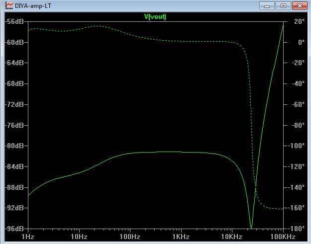

Below1 is Badger PSRR without caps , CRC , anything.
MUCH better than most of the CFA amp projects on the forum , even
with multipliers and CRC's.

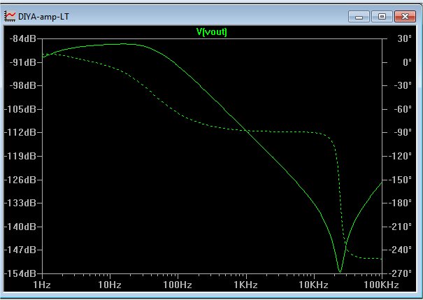

below 2 is with a single supply and a simple CRC (4700u-1R-4700u). 🙂
A single supply CAN be quite good (with this amp/topology)!
OS
