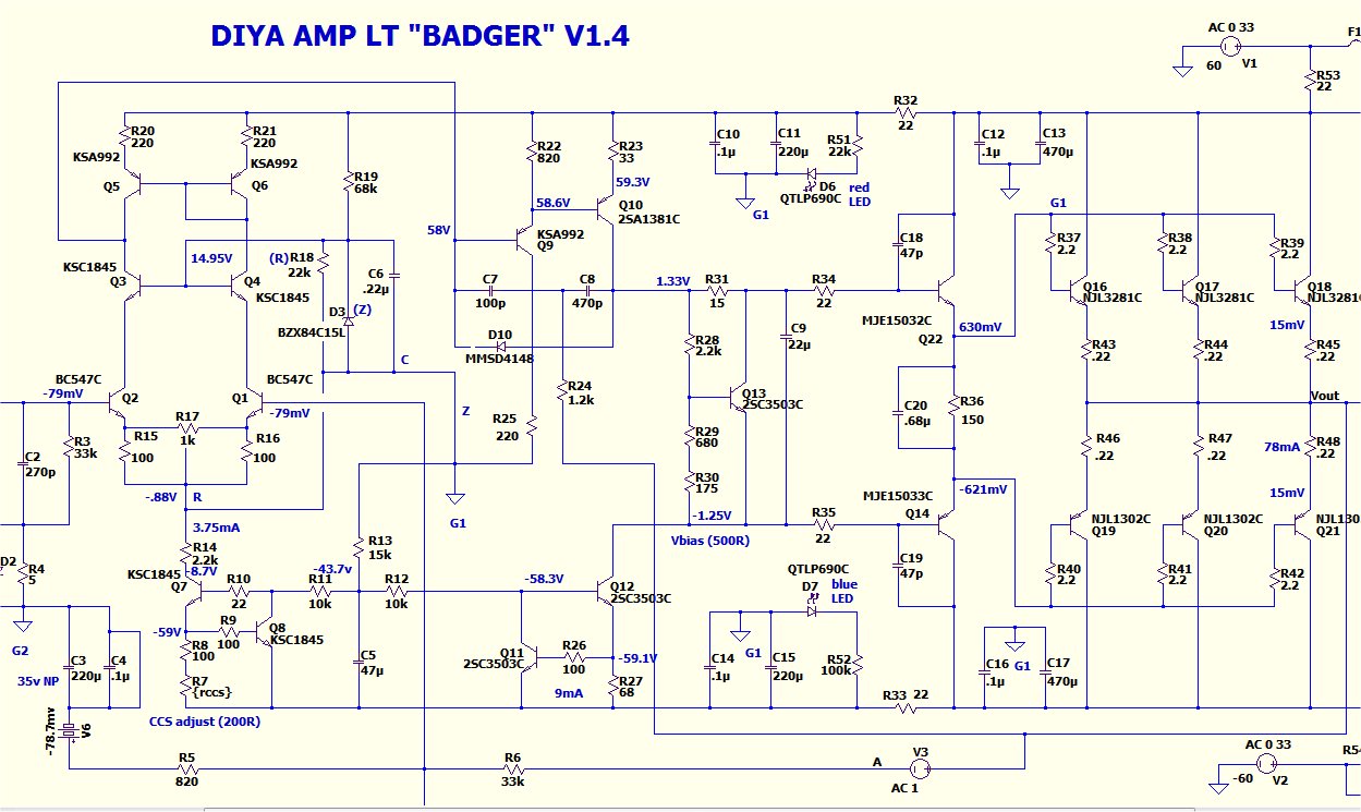

Hi gut,I have some question.
T finish other PCB .
DC offset about 30~50mV,and R14 is 8.25V.
After I try to bias of R30.
I turn on about 270 ohm(measure) .
Bias is 0 mV.Is it normal???

Value of R27
Just to make sure I have understood this correctly - the value of R27 is 56R if you increase the output power of the amp. In "normal mode" the value is 68 -100R. Is this correct?

ostripper,
Could you paste here HB circuit diagram showing DC voltages in all important points for rail voltages of your HB? What is voltage drop across Q7, Q10 or Q12?
Thanks,
Regards
56R set the VAS CCS for 11ma ... this may make the EF2 OP stage less susceptible to "droop" with low Z loads or facilitate using lower Hfe outputs
(MJL21193/4 ). The bias trimmer should "range" all the below currents.
This will , however.. increase heat and change the bias setting of the Vbe.
It will not "increase power" by itself , just change the electrical characteristics of the VAS/CCS.
56R= 11ma 68=8.8 82= 7.5 100= 6.3
Schema below with V/I measured at 60V rails. 🙂

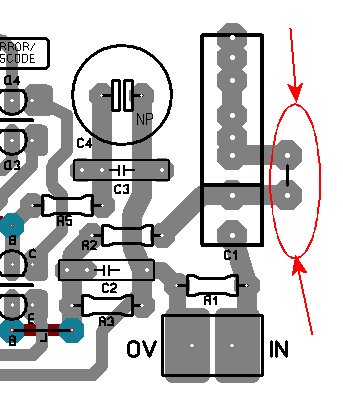

Can someone confirm that 0V and IN on the lower right side of the board is my RCA input from pre-amp and OUTPUT and SPK/GND is the output for the speaker? I've gone through the build and setup of R17/R7/R30, everything looks correct, yet I only hear very faint sound from my speaker if I turn the pre-amp to nearly full volume.

Confirmed !
"everything looks correct" ? 7-8 V across R14 ? 0V at output ?
30mv (or close) between TP 1/2 (or...15mv between tp1/2 and 0V)?
Photo's + more details = more ideas to come to a resolution. 😀

yes, yes, and yes..
please excuse my solution to not having the right size fuses, they are 4A 250V..
i've also checked for any shorting on Q13-21, all good. i have nylon bushings in the mail but that keratherm sheet is doing its job

specifically, 8.24v on r14, 0.01-2mv or so at output, 28-30mv (depending on temp) between TP 1/2
Make sure hot and ground aren't reversed on the RCAs. Did that once it drove me nuts searching.
Just tried turning it around, made no difference. Maybe I need to ground my boards better?
Disconnect input .....
Touch "in" with your finger - is there loud hum ?
If you are using a large capacitor, is the jumper NEXT to C1 bridged ?
OS
I get some static and some hum if I touch the input. the jumper isn't bridged, so it looks like my cap isn't wired up!
can i hook this up and get going or will I need to go over all of the other trimmers again?
