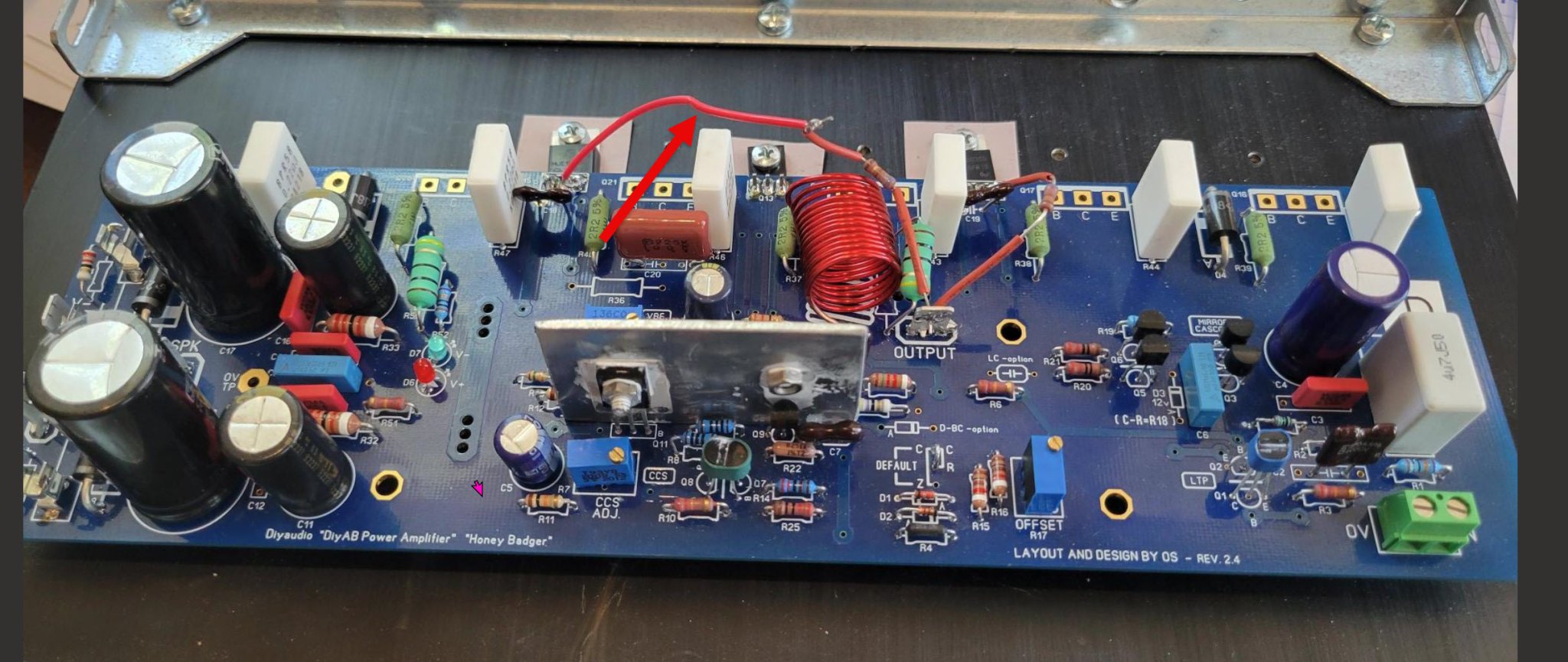

diyAB Amp The "Honey Badger" build thread
On my fourth board. Built it carefully with some great help from UncleMud.
With first turn on with the DBT in place I got these values at 120ACV:
Both LEDs work
Current across each fuse = 0.430 +/- DCV
R7 is sitting at 8.07DCV
Loop IV = -0.793 DCV
R17 Offset = 005.2 mV
After 15 turns of R30:
Loop 1V moves from -0.795DCV to -1.049DCV
R7 = -08.18DCV
R30 = 00.0 mV
R17 = 7.9mV
I actually pushed R30 to 20 turns, but still no measurable value on R30, but the Loop IV increased to ~ 1.300 DCV
Do I have a bad Pot at R30?
Do I continue to move R30 even though the Loop IV is increasing?
And particular spot to check on the board?
See photo. I was guided to use this during the first tests and early biasing. Maybe I misconstrued the input.
As you can see, I'm stuck at this point.

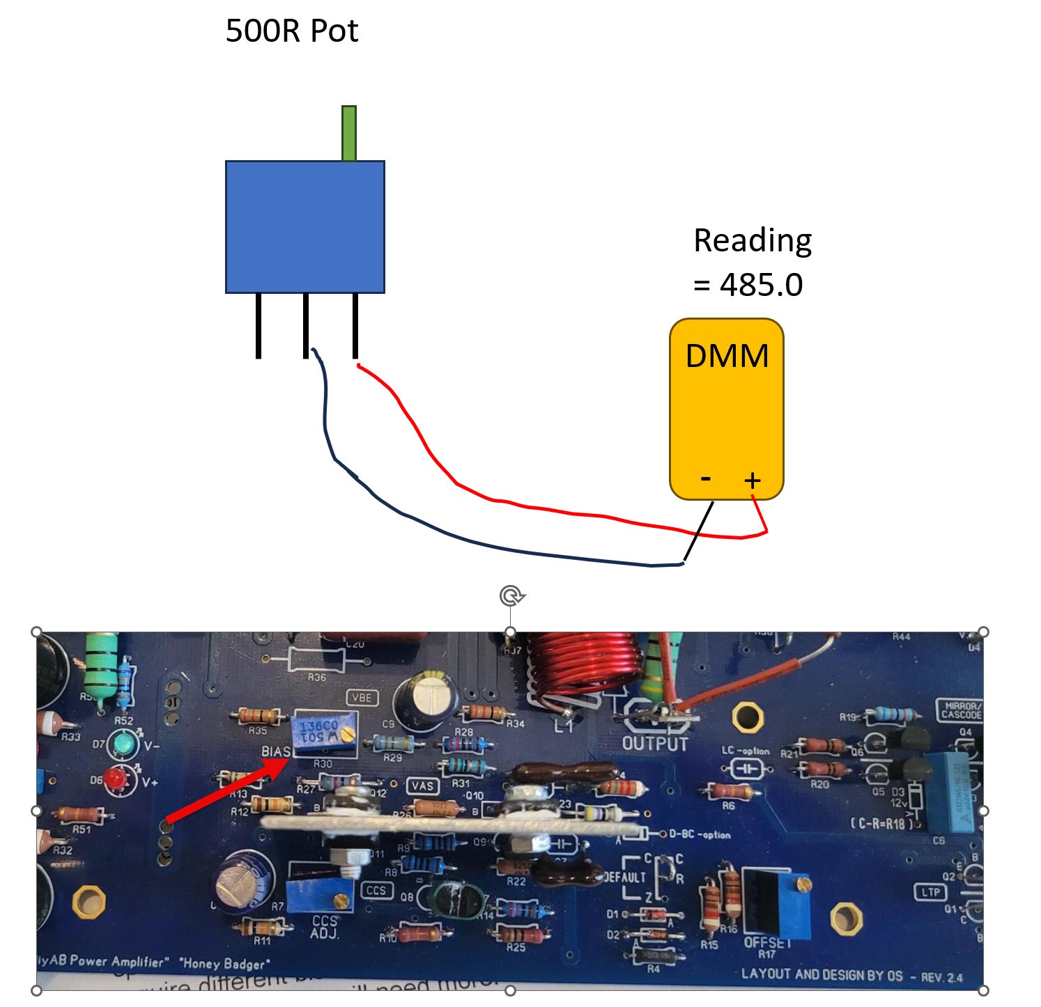

Speaking of the R30 Pot, see illustration below. I want to make sure I've set the R30 trimmer pot regarding the position of the pot on the board and the right side reading 485.0 ohms. Is this correct or reversed? The guide says set pot to maximum resistance [500R].
