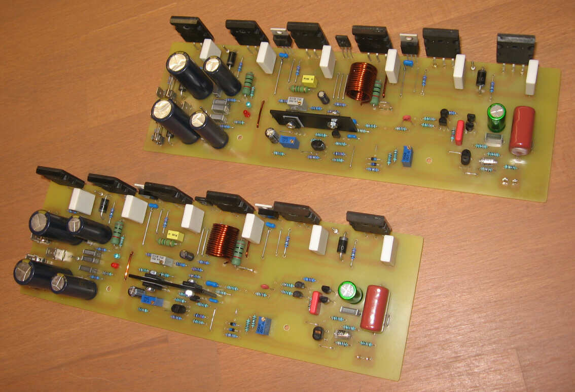

Thank you "mcsontos", but I make the boards myself (one in blue would look strange) ...

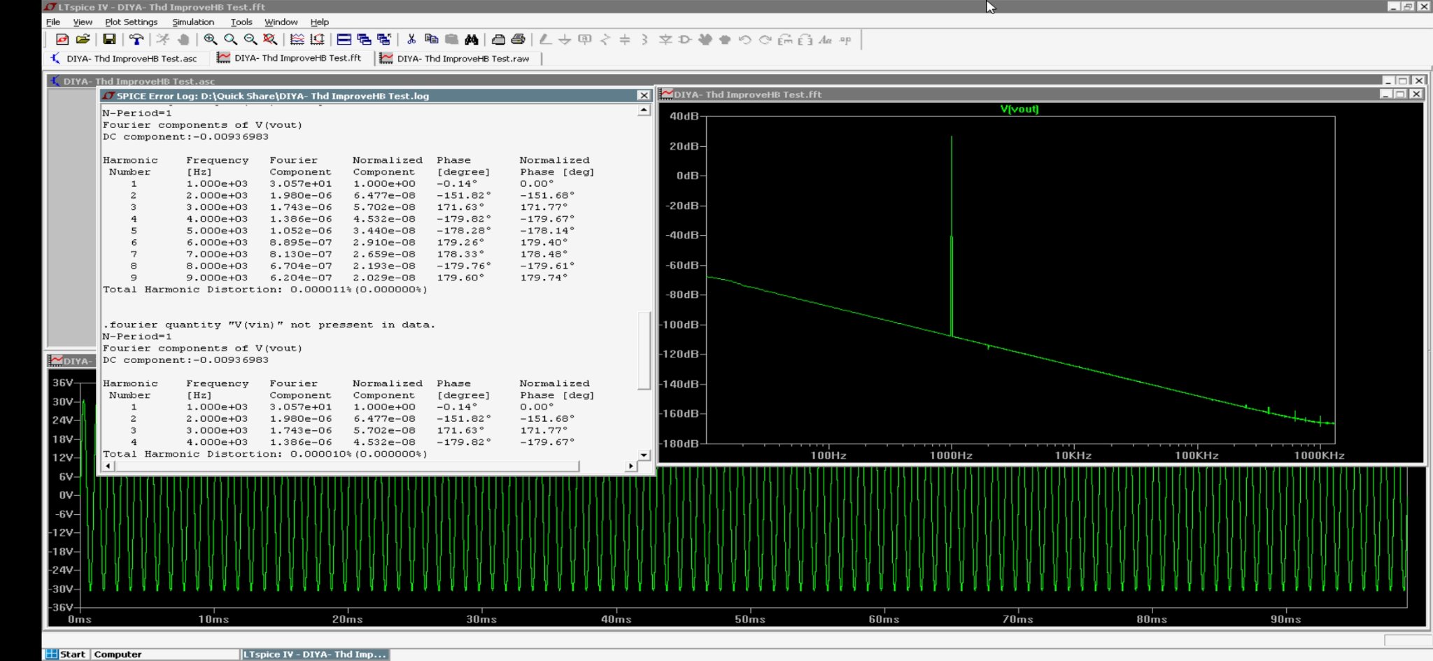

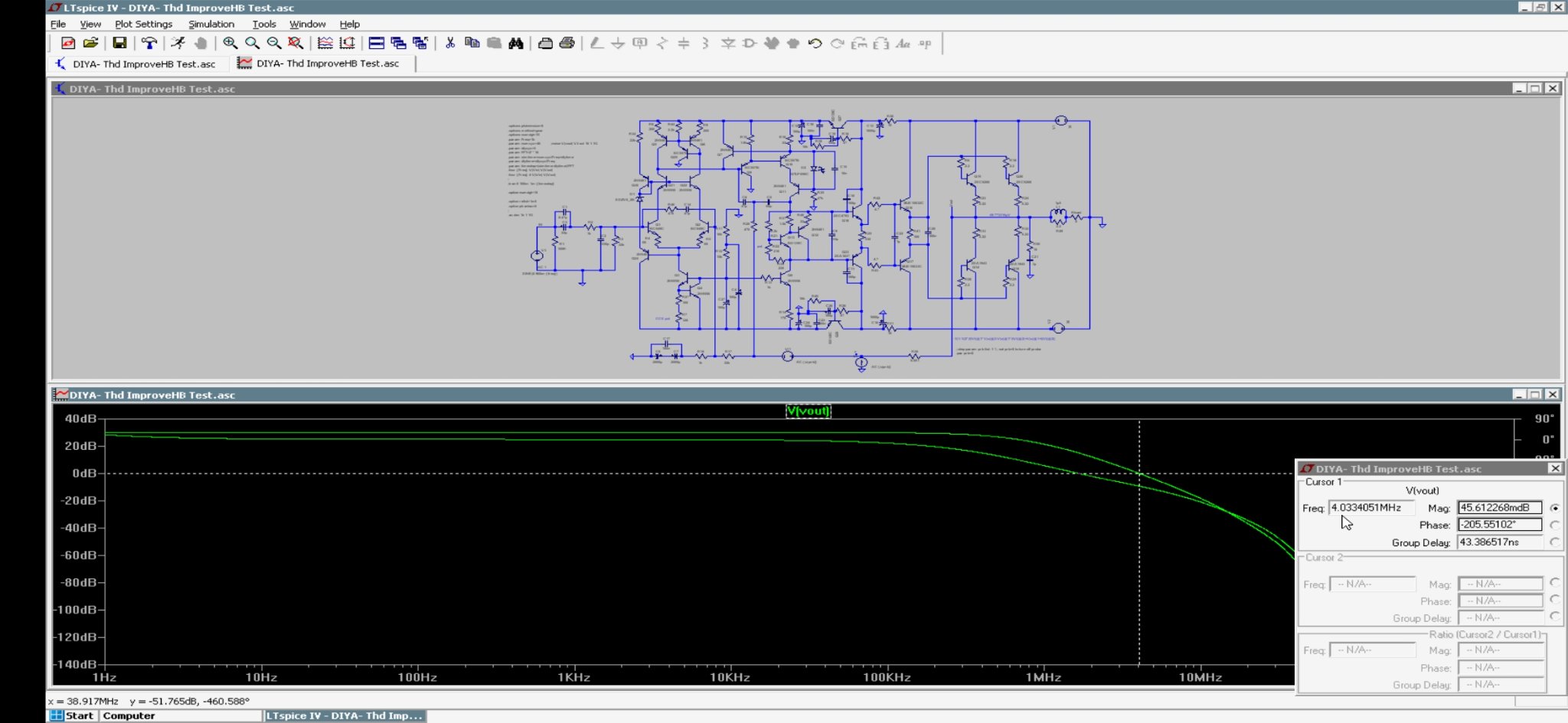

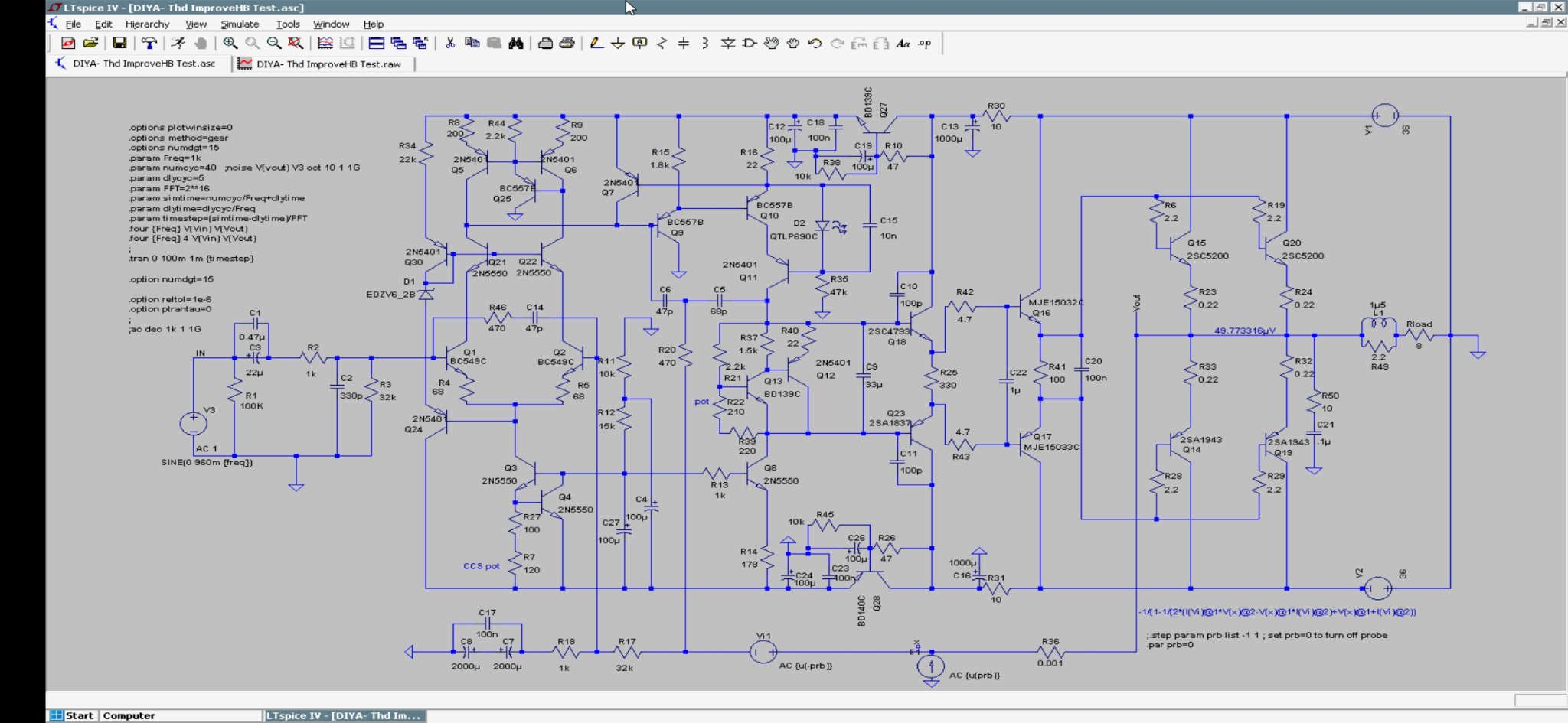

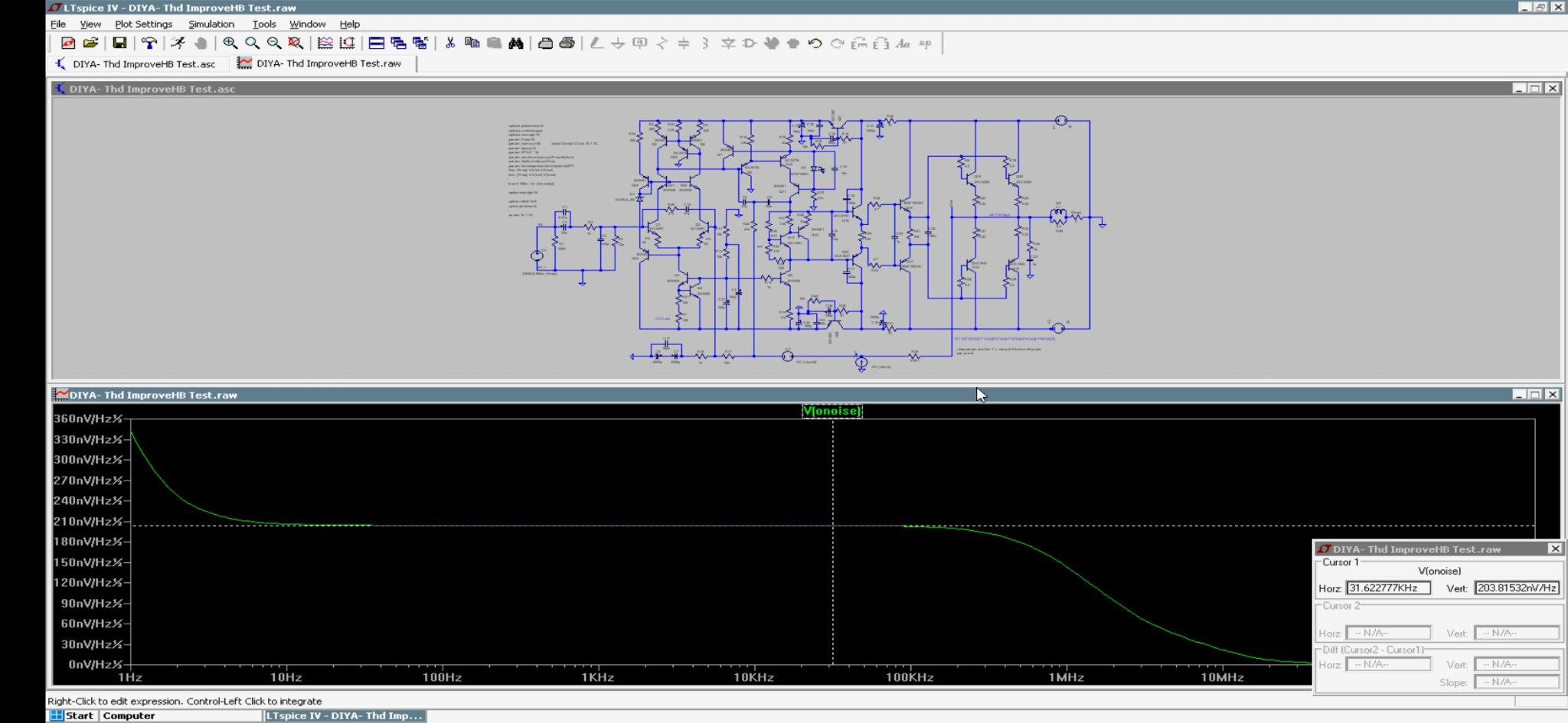

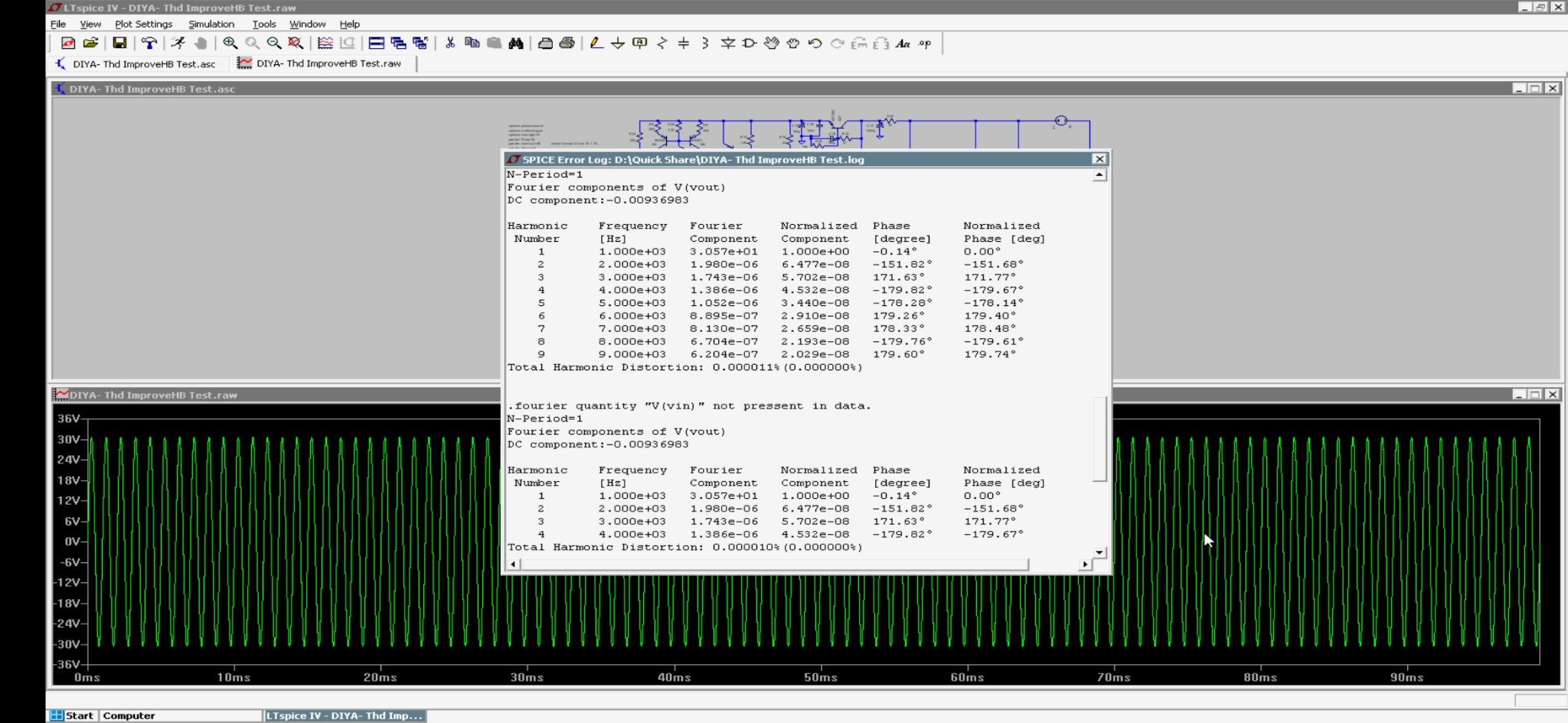

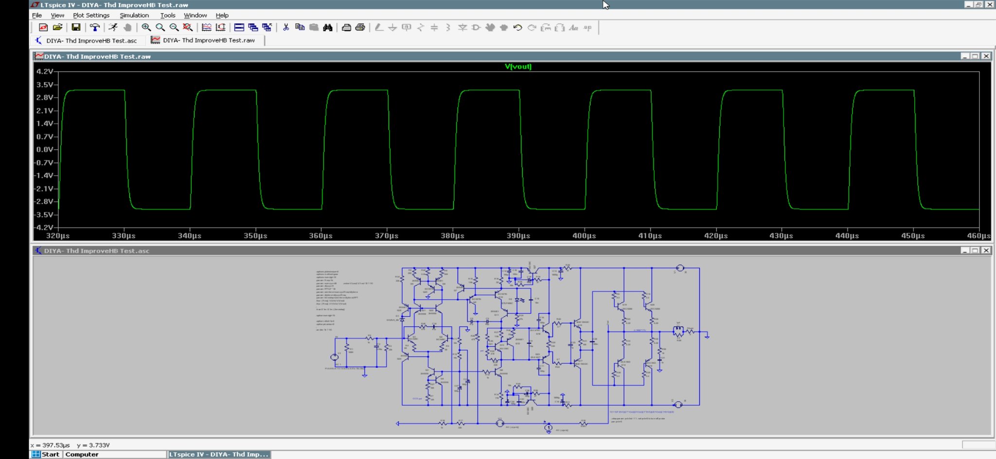

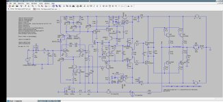

Tried to modify HB, don't know about Ltspice accurate or not or cirquit is wrong, hope it's works ,

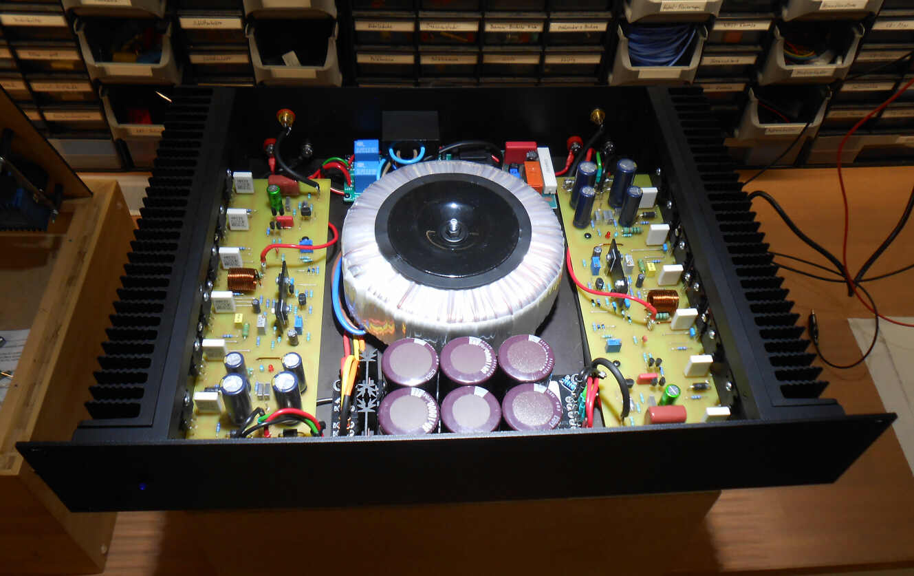

No enclosure from the shelf - custom design by myself. Bottom and sides from phenolic resin coated plywood, front standard anodized 3mm aluminum 2U, rear aluminum spray painted. Tops I don´t do (no grandchildren yet).
manic mechanic,
pleasing layout and finish, indeed! Optimized board placements, short and spatially well separated air-wires, no mess, etc. Just beautiful. 🙂
