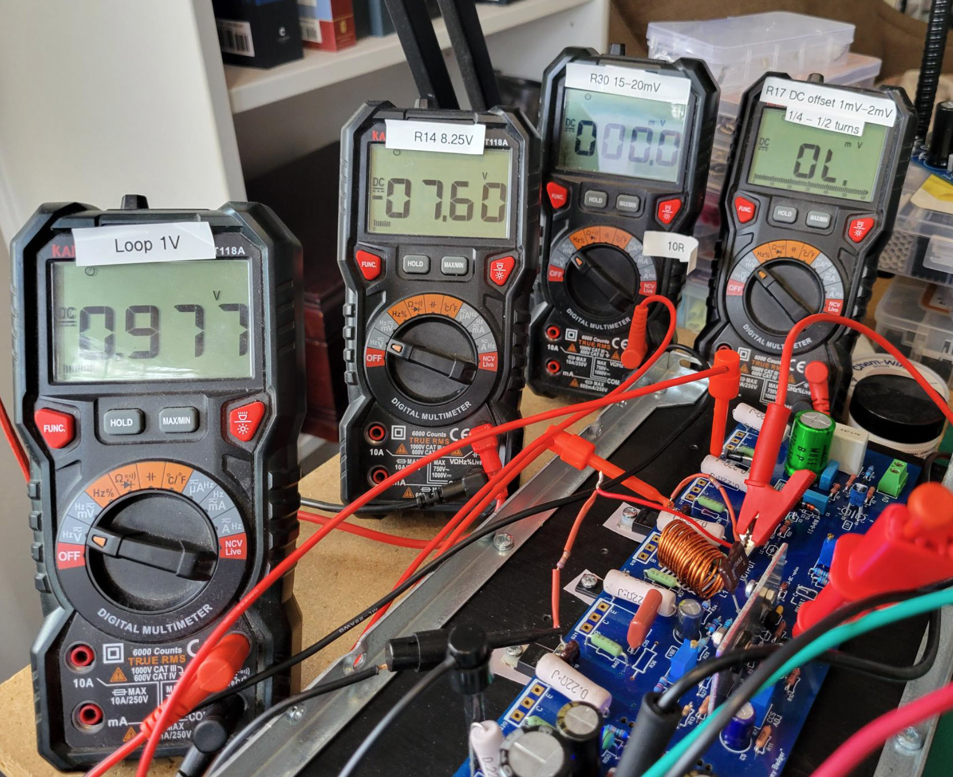

I'm back. My QNAP nas drive needed to be replaced and I got that done. I installed ROON server in the new QNAP and that is working really well.
After running my initial test and no smoke I'm ready to get back to finishing this project.
I have the DB in the circuit and using a Variac run to 110ACV.
Today I tried to bias to 15-20mV, but after 12+ turns on R30, the DMM registered no change. At 12+ turns the 1V loop was gaining to + 1.1V, so that made me nervous.
I'm at -0.76V for R7. AM I correct in thinking that after the removal of the DMT, R7 will show a voltage gain? Or should I set it to 8.5V now?
R17 shows OL ??
Do I keep turning R30 or is something amiss?
Appreciate the help.
R17 shows OL ??

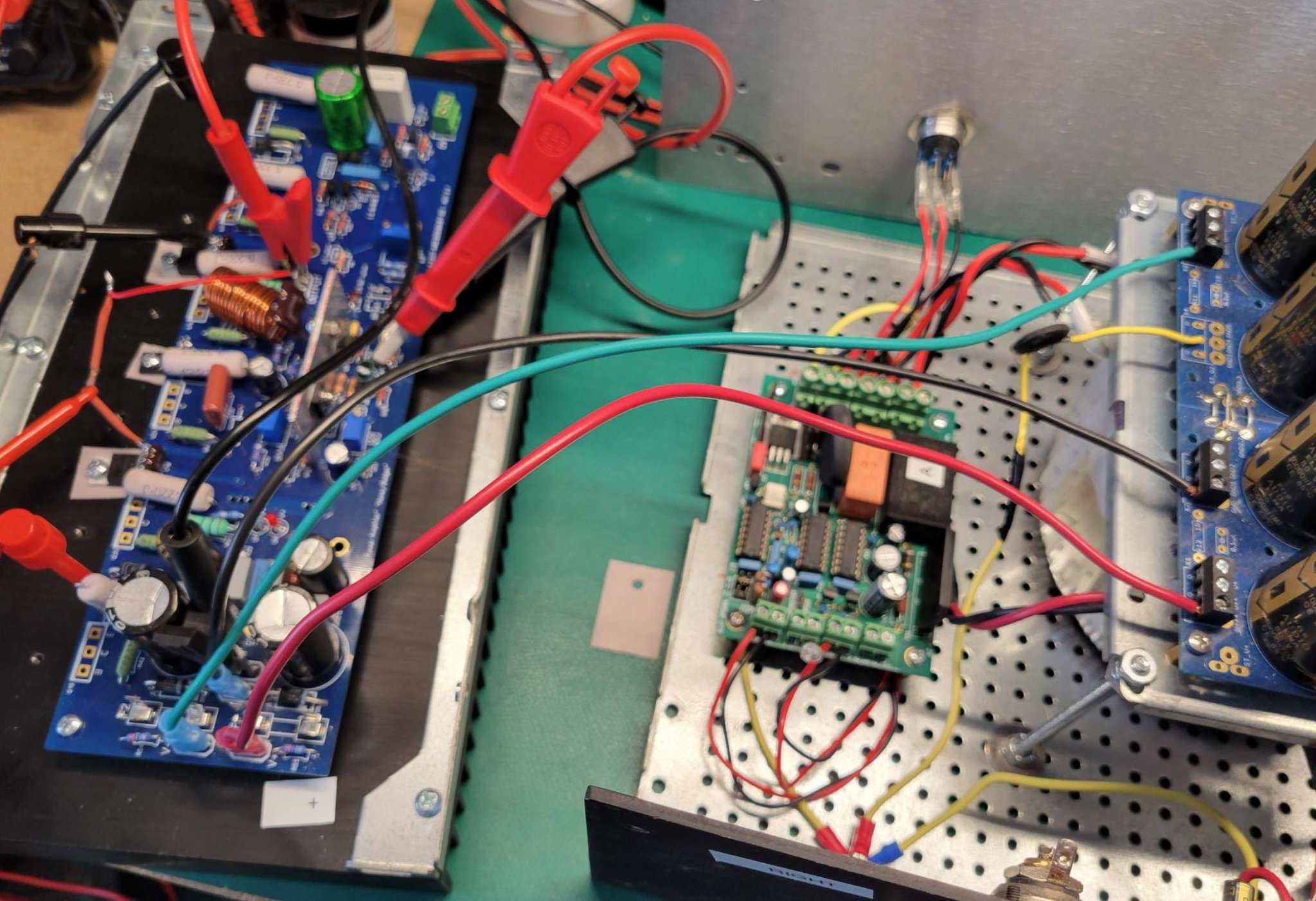

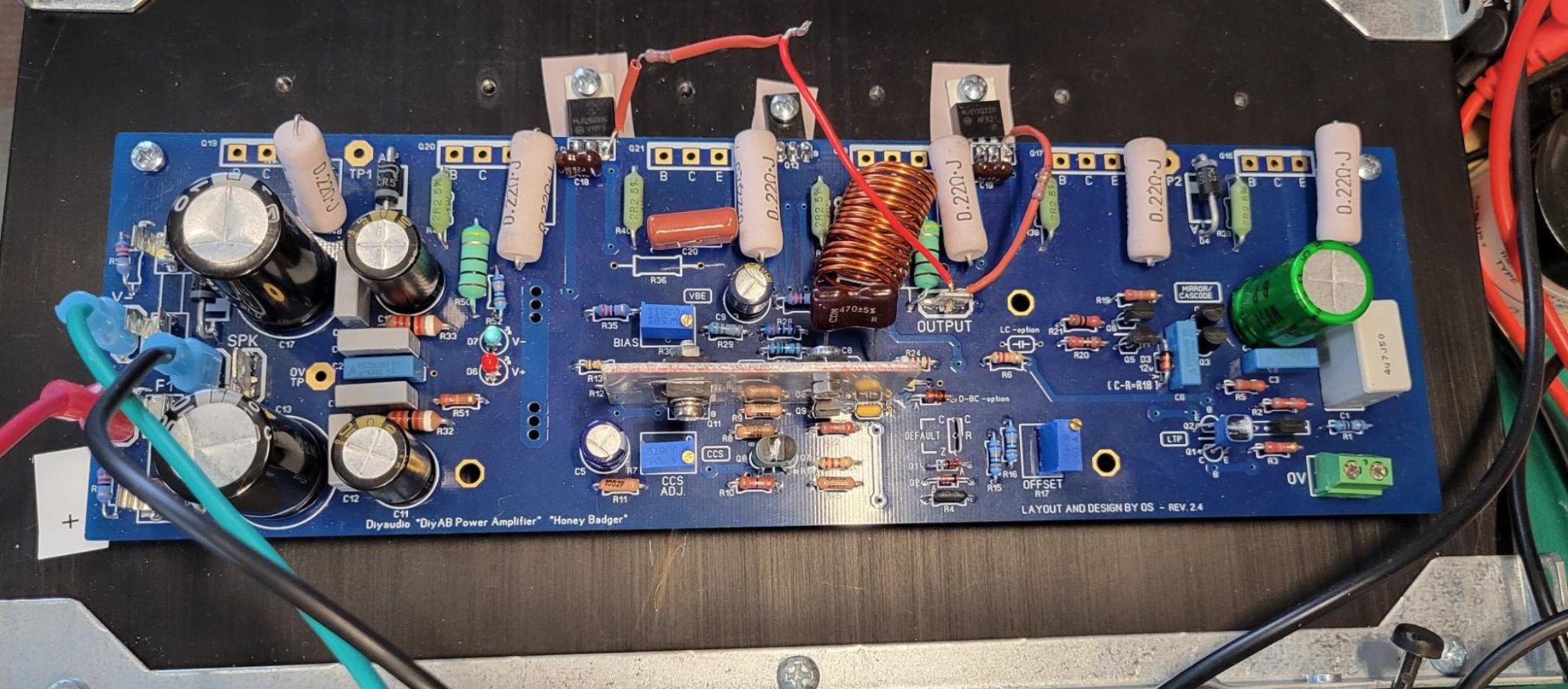

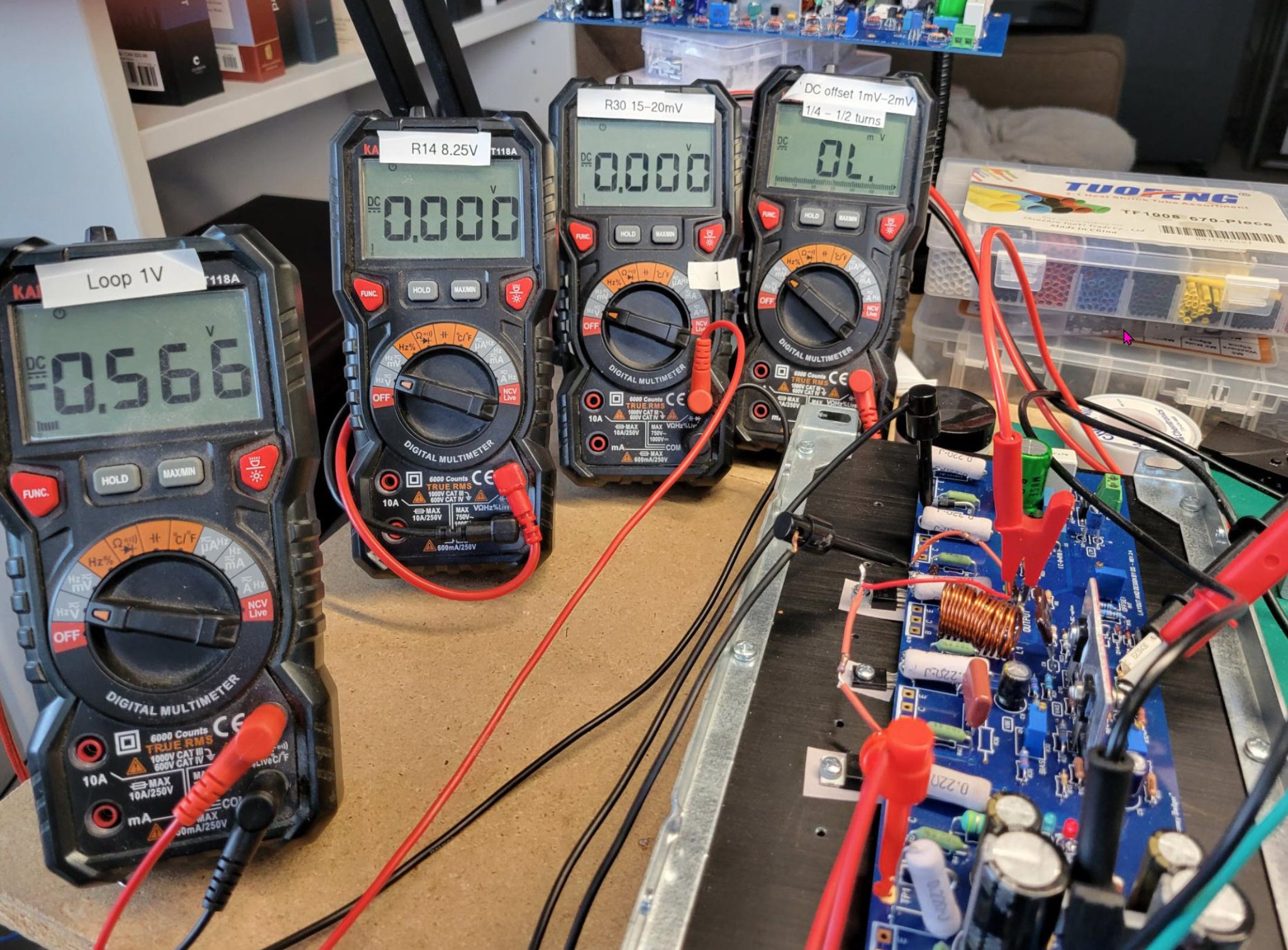

Ah nuts. I turned on the current channel with the DBT: no smoke, bulb went off but no blue LED and only reading was from the Loop reading.
Uncertain how to proceed. I've built two channels and they both have ended in the same place. I must be making the same mistake(s), but not sure where.
No blue LED means your negative rail of the power supply isn't connected. Do you have V+, ground and V- connected correctly?
Something isn't connected correctly. R54 can't be dropping more than 63V if it's dead shorted if the supply is connected correctly.

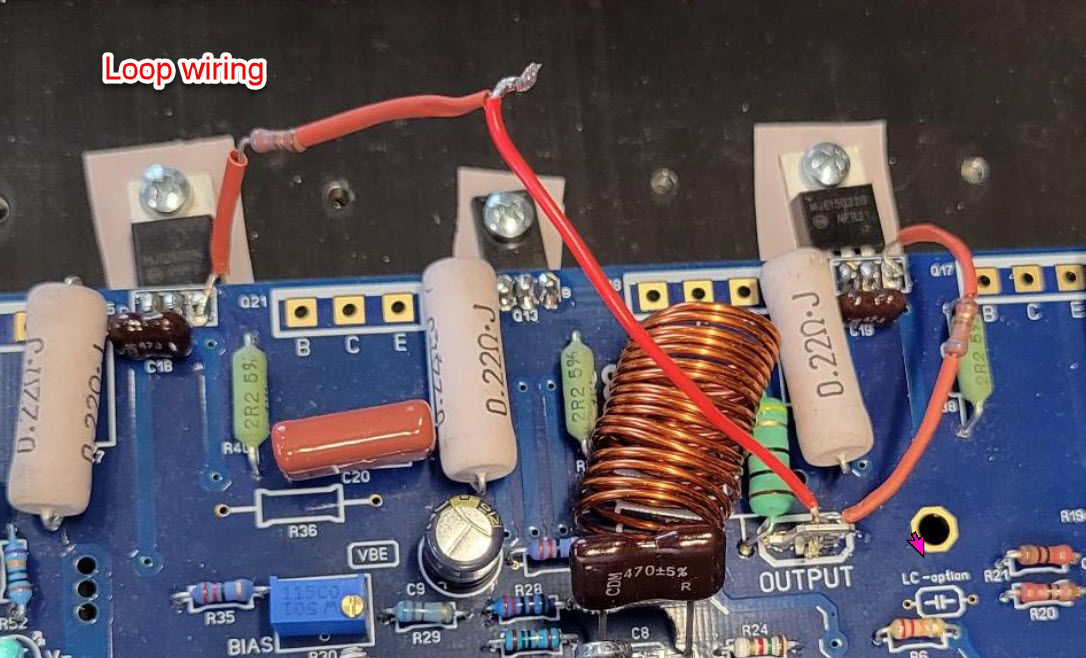

Loop wiring look correct? it measured .794 DCV yesterday.
I removed the board and blew out the board and the heat sink.
Replaced it.
Powered up. R54 = 61.13 DCV R53 = -0.132 DCV
Weird.
Replaced it.
Weird.
Any likely suspect areas to look at?
I've gone over this board looking for bad solder joints.
How does this board pass the first round of testing: LEDs on, dcv across 10R ~ 0 DCV, and then crap out when I turn it back on for initial bias setting?
Feels like I'm missing something pretty obvious, just not to me.
