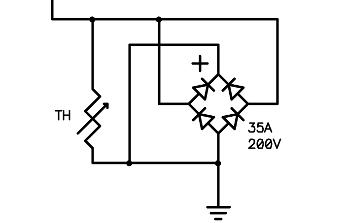

Matt, I don't have my boards yet, but the schematic notes 2 grounds. Are they connected on board by a resistor or should they hit the star separately? Leach did both.
From a comment AndrewT made in another thread, the purple wire from the transformers should connect to the chassis directly right at the transformer. Extending the lead reduces the shield's rf blocking capability.
From the central system star ground you might connect to the chassis via something like the attached picture. The bridge is just one of the cheap kind.

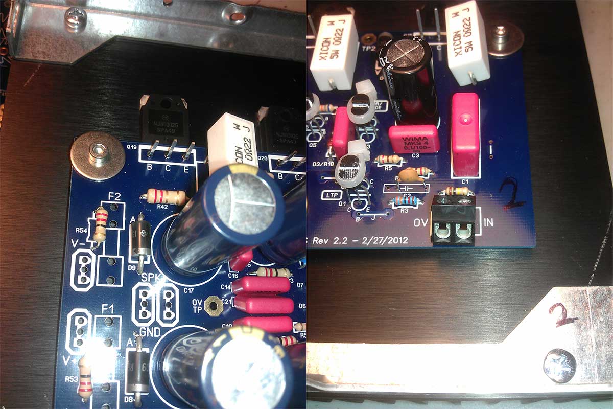

On the right side of the photo is the ground near the input section on the schematic marked G2 on the schematic, the left is of the ground near the output section, marked G1 on the schematic. Also there is a 0V TP solder point that I'm not sure of, on the left side of the photo, which I think is a third ground marked G2 on the schematic. I would say that OS intended for them to hit the star separately but I'm not sure as two are marked G2.
Note that I have v2.2 boards, I know there were many changes in v2.3 that may have clarified this.
(Just for clarity, the boards are temporarily attached to the sinks without standoffs, and the diodes aren't insulated yet)
Just look at the traces, you see a star at the 0V/TP. The board is laid out to be it's own star ground and the GND connector near it is where you should connect it to the system star ground. R4 and the diodes near it serve to separate the potentially noisy power ground and the audio ground.
