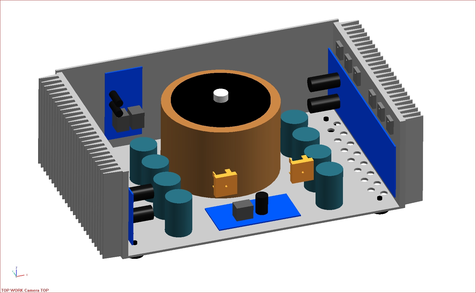

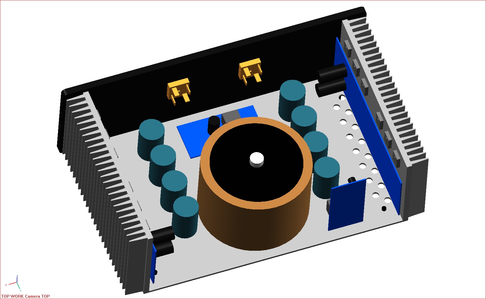

If anyone would care to comment regarding the major component placements within
the enclosure, I would appreciate that. Just a little worried there may be some interference issues I have overlooked. Using the amp, sp and ss boards, ps will be point to point.
Either way looks good to me. Look up nissman's or jo jo's amp (the other builds) or even builds in general on the solid state forum -

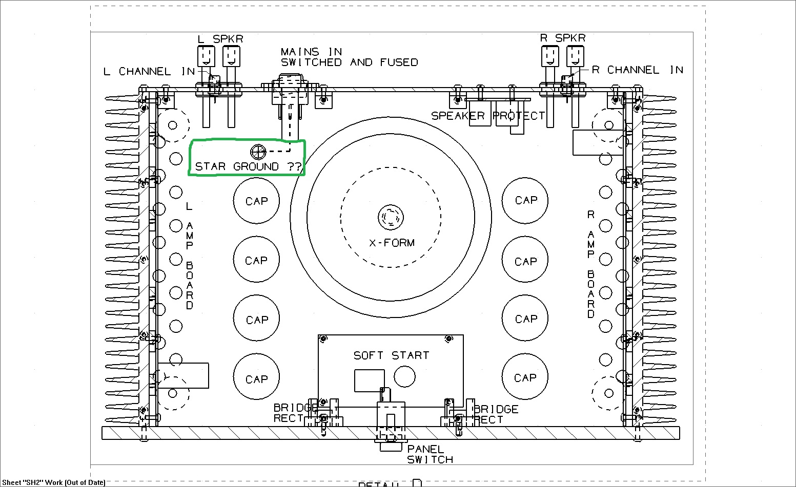

If someone wouldn't mind explaining to a layman the principles behind a star ground, or if indeed that is what is supposed to happen in this context. The major ground contact is intended to be attached to the case floor. Are all the the other various contacts supposed to be routed to the same point, or can a floor attachment be made at any convenient fllor point?
