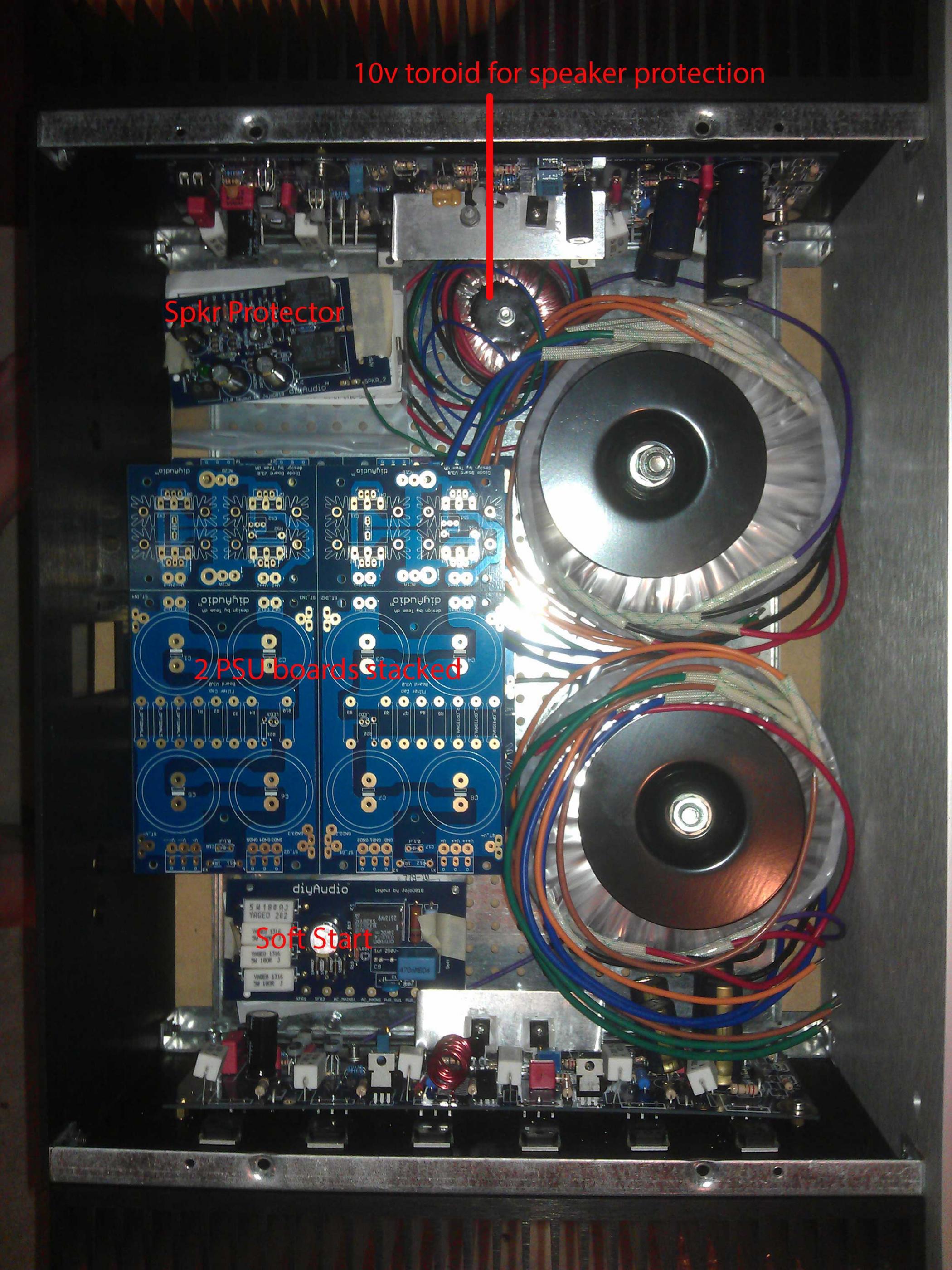

Here's my first dry fit of all the components in a 5U chassis. Any problems with this layout? Also, is it OK if the large toroids aren't sitting flush on the bottom plate?

Geez - who would have thought you could run out of room with the big case? Plug the power entry module into the back panel to see if you have clearance to the PSU boards. It may make sense to put the big transformers in the back and PSu boards up front. Otherwise looks OK to me.

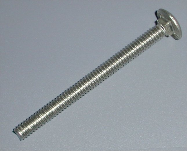

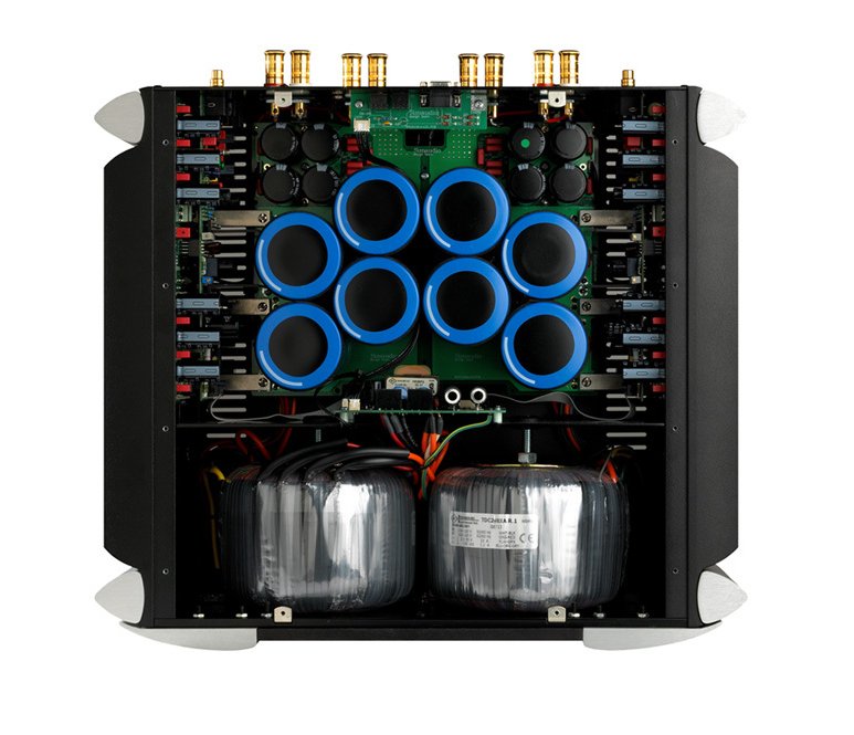

Just an idea ...
Mount toroids on front plate (example below - 10K$ "moon" reference amp :D).
Use carriage bolts to make it look good (2'nd pix)
OS
