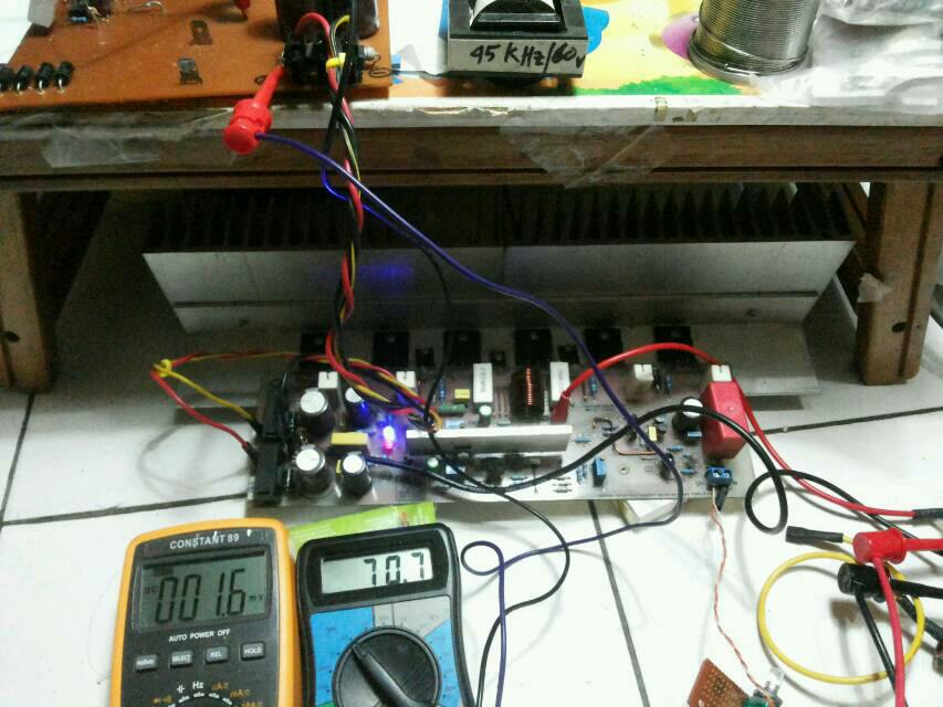

My humble HoneyBadger powered by DIY SMPS +-70v
